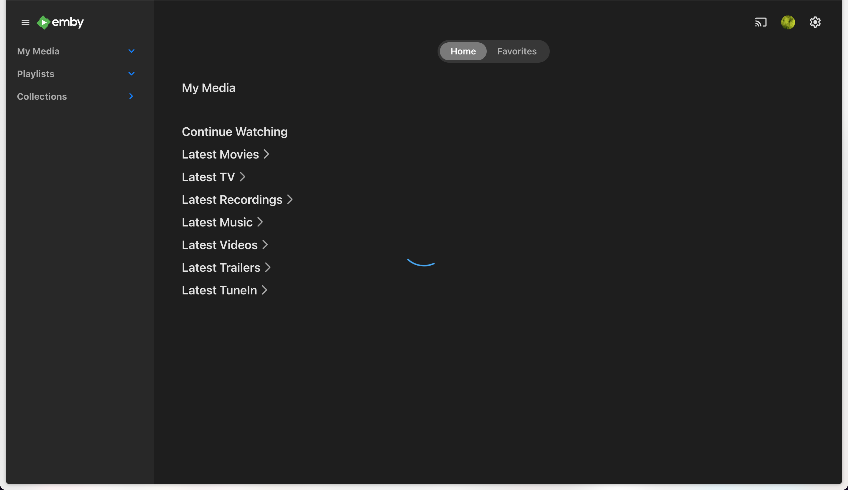

EkoOne 7 Posted August 11, 2024 Posted August 11, 2024 For some reason this is how Emby appears on my MBP running macOS 12.7.6 (see screenshot) regardless of browser: Arc, Safari, Firefox. It had been working fine. The Emby server runs on a NVIDIA Shield and is wired to the network. What's curious is that all other devices running an Emby client (phone, tablet, TV, Roku, Apple TV) whether connected via ethernet or wifi, work fine, it's just the browsers on this one laptop. I thought perhaps a browser extension/plugin might be the cause so I disabled all of them but no change. Then I cleared the browser cache/cookies but still nothing. Then I disabled all network security software but that didn't hep either. I'm at a loss. Is there an Emby setting somewhere that could be the cause? Thanks.
Luke 43537 Posted August 14, 2024 Posted August 14, 2024 Hi there, please attach the emby server log from when the problem occurred: How to Report a Problem Thanks.
EkoOne 7 Posted August 24, 2024 Author Posted August 24, 2024 See above for details. Log sent: 1:15p EST Logged in Emby user: Todd emby anonymized.txt
Solution Luke 43537 Posted August 26, 2024 Solution Posted August 26, 2024 Ok I would try deleting all DLL files from /storage/emulated/0/Android/data/com.emby.embyserver/files/plugins then restart the server and see if that helps. Thanks.
EkoOne 7 Posted August 26, 2024 Author Posted August 26, 2024 That seems to have done the trick. Thank you. 1
