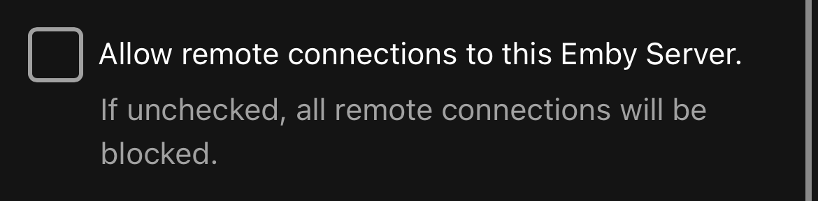

podonnell 48 Posted August 11, 2024 Posted August 11, 2024 I see my server name when I added the emby skill in Alexa, but unable to make any terms work. Just getting a “sorry, i’m having trouble accessing your emby skill” message. One thing I wanted to check on was that I use a reverse proxy, so “external” access to emby isn’t really required. I have this setting off: and clients can connect without issue. I do use IP whitelisting, so one question I have is if there is a dedicated IP or list of IPs I need for Alexa to communicate properly. However, even when I allow all, I get the same message. What other things should I be looking at to help fix this? Thanks!
podonnell 48 Posted August 12, 2024 Author Posted August 12, 2024 When I check off this box, it allows me to add the base url path that I need, but now emby is needlessly exposed on my network. Can someone assist with exactly what the Alexa app is using to determine my full URL? I am under the impression that I must enable the above setting in order for Alexa to know it can connect, when in reality I am able to have external access with this setting off, using a reverse proxy. Any tips how to not expose this in such a way?
Luke 42239 Posted August 12, 2024 Posted August 12, 2024 Hi, you’ll need to check that box for Alexa. To answer the question about the URL, the full URL used is the remote address that is displayed on your Emby server dashboard.
