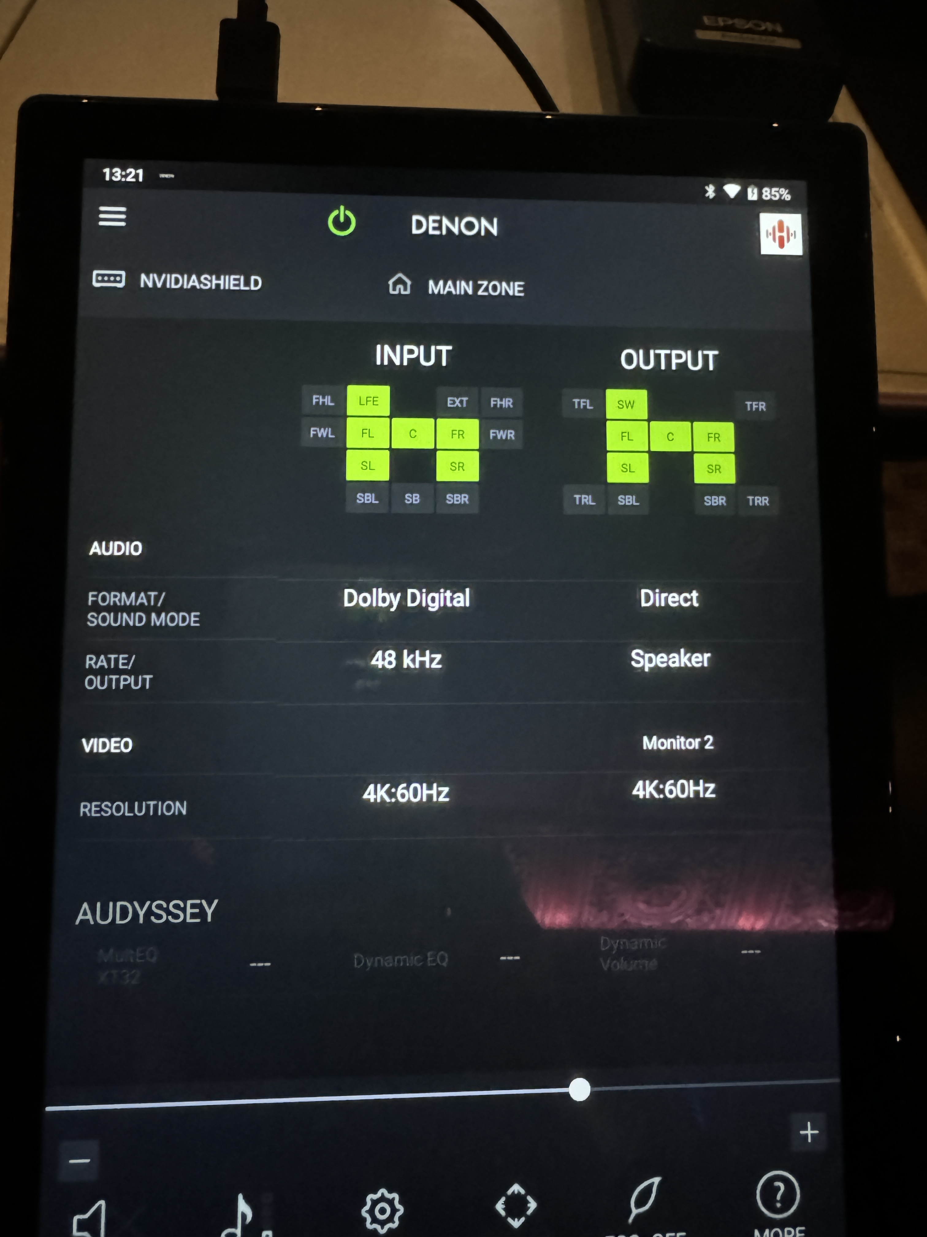

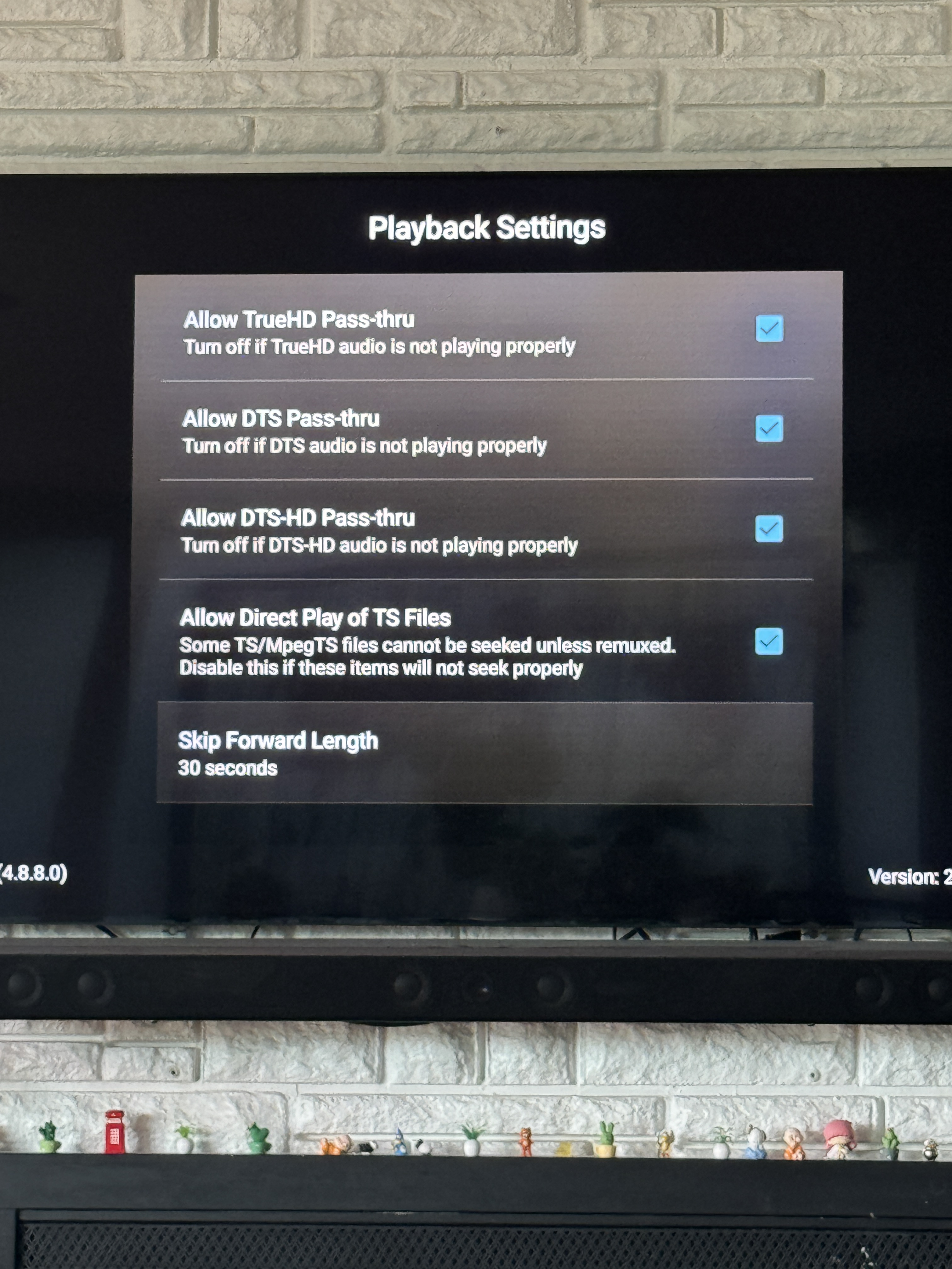

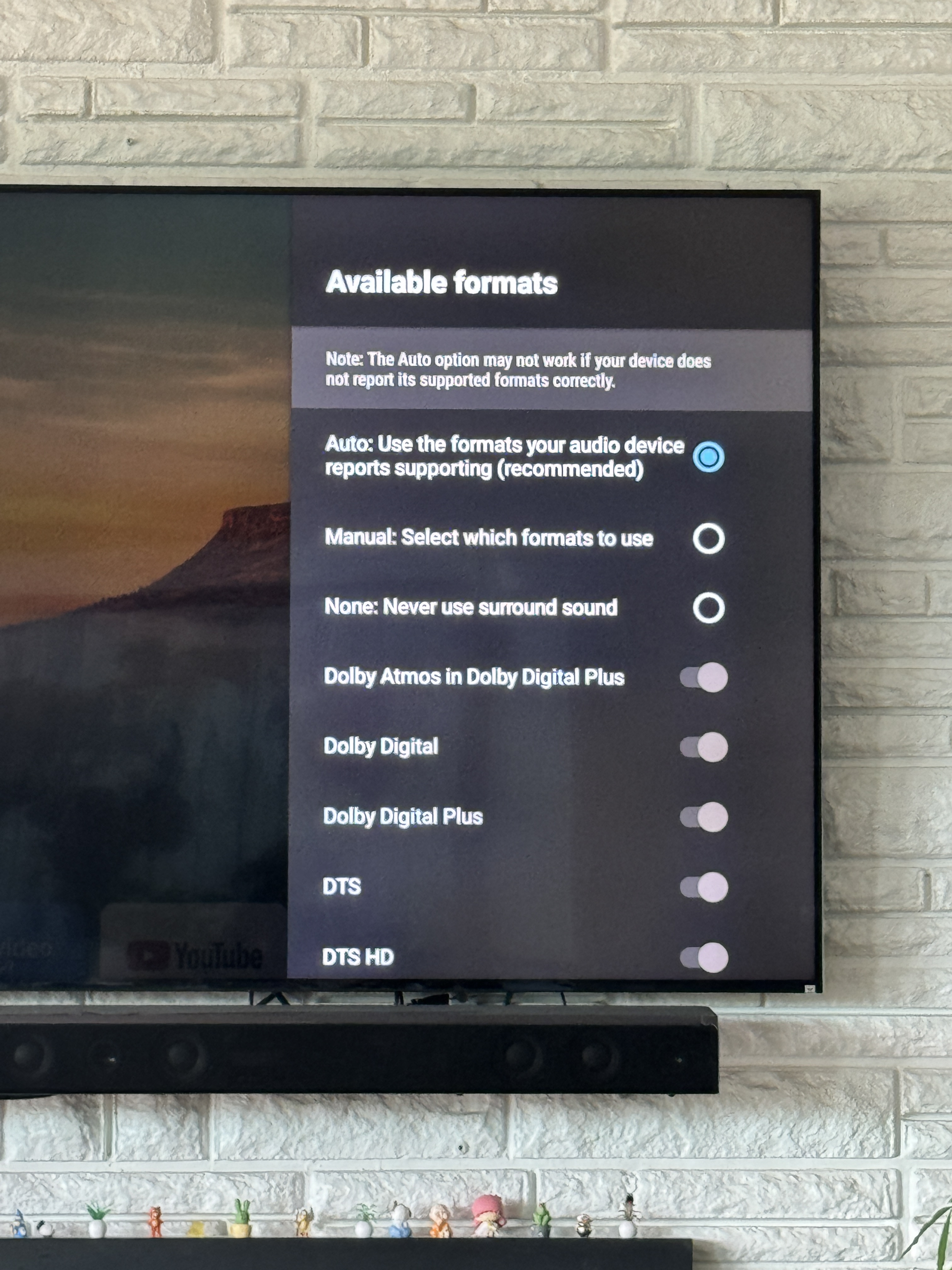

griffindodd 18 Posted August 10, 2024 Posted August 10, 2024 (edited) Running Emby on Nvidia Shield my receiver sees all inbound audio as DD 5.1 no matter the original format My audio settings in Android are set to auto, but even manually choosing all Formats has no effect, and in Emby I have passthru enabled for all formats my receiver is a Denon 6300h which supports a massive range of audio formats so it isn’t a limitation here Edited August 10, 2024 by griffindodd

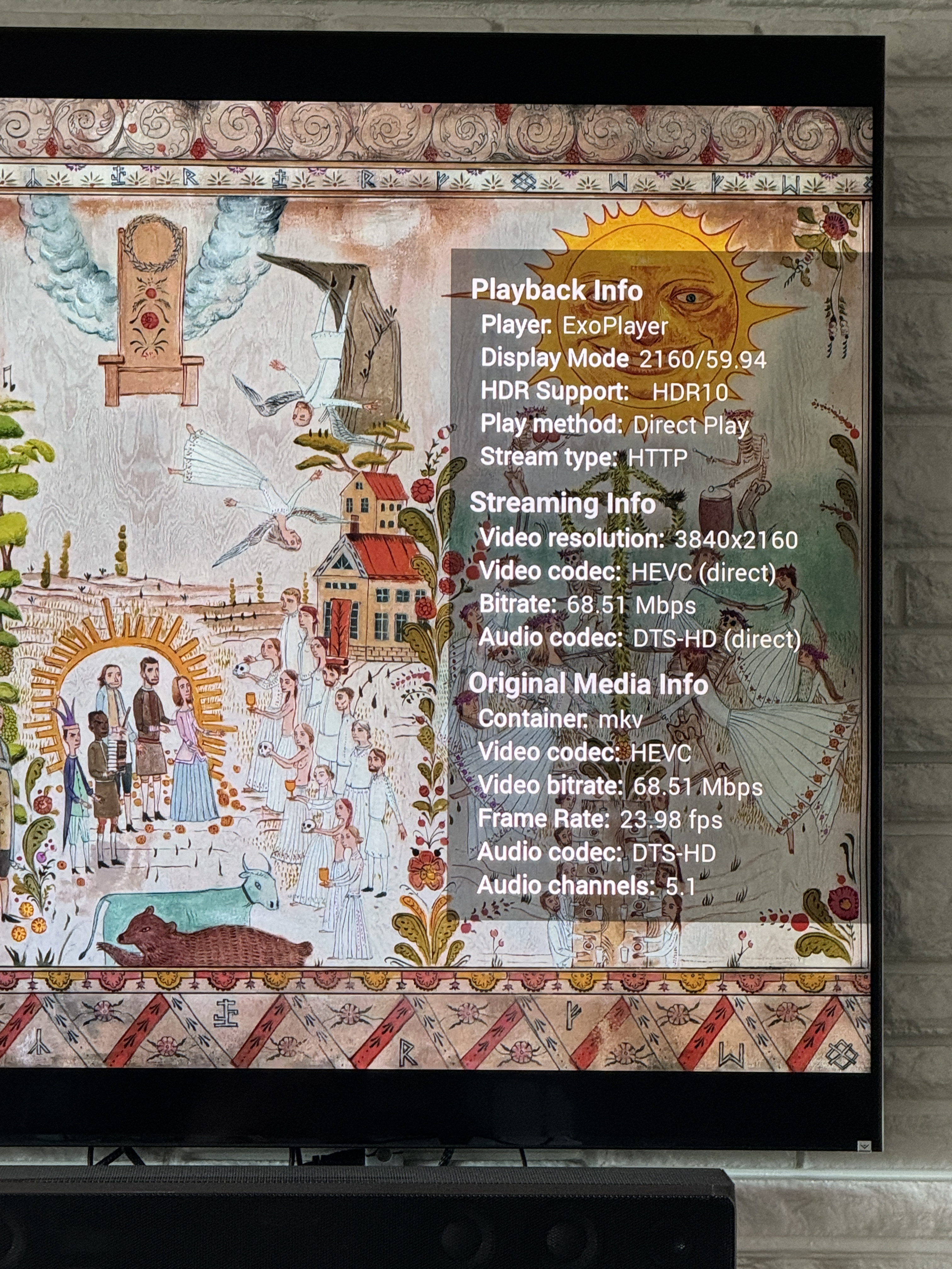

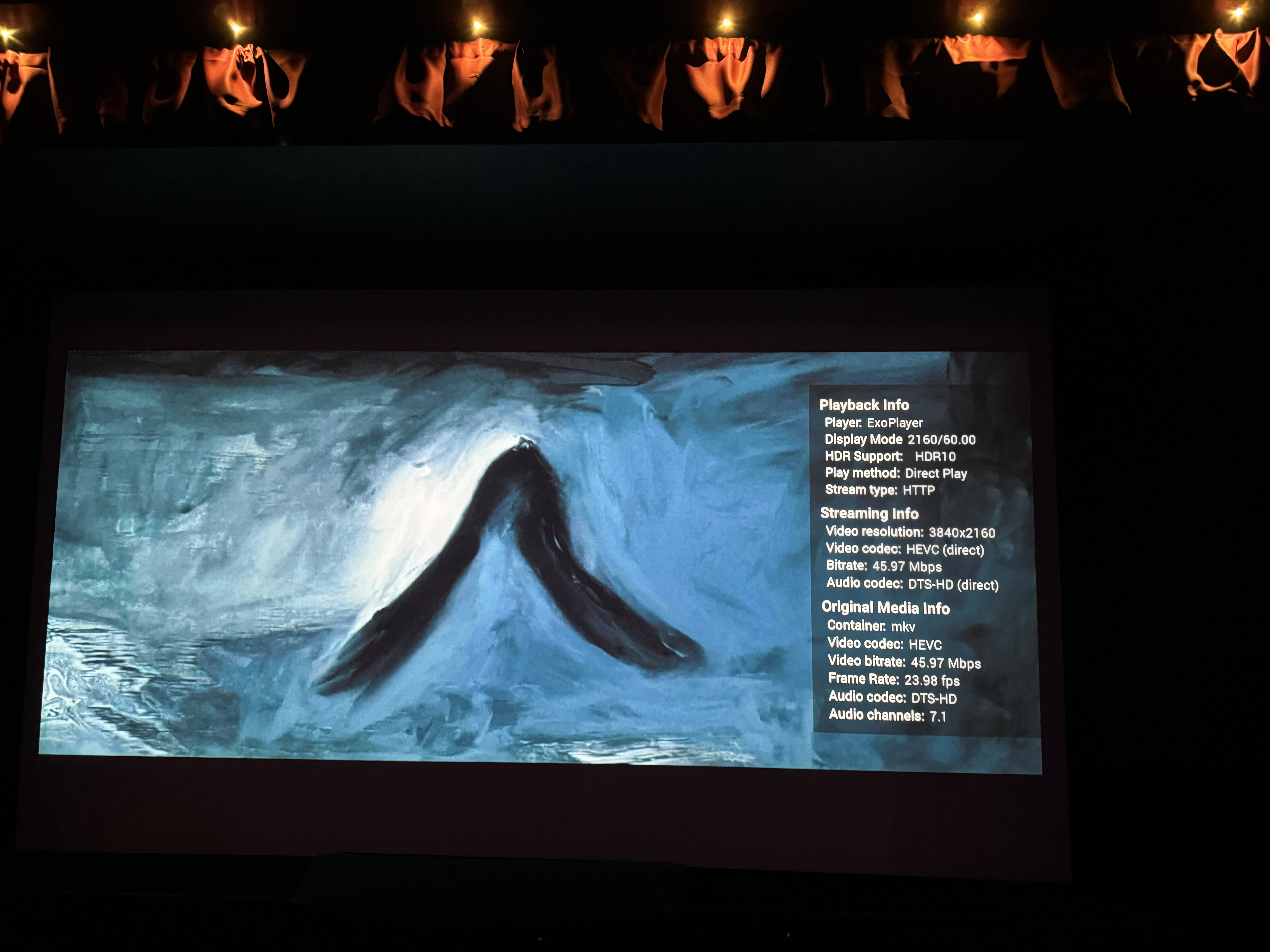

ebr 16337 Posted August 11, 2024 Posted August 11, 2024 You can see in our stats that we are sending DTS-HD. Something after us is converting it it appears.

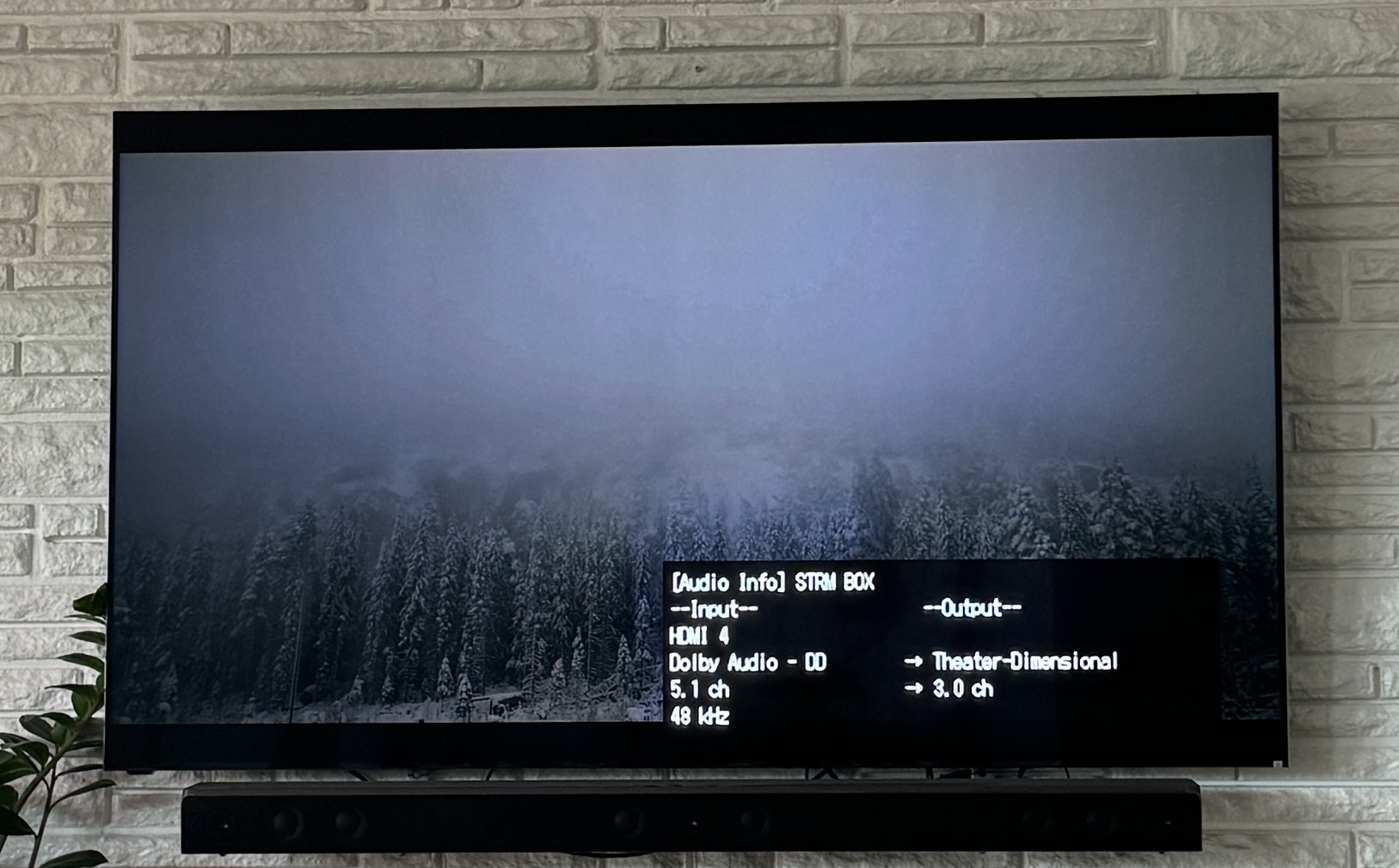

griffindodd 18 Posted August 11, 2024 Author Posted August 11, 2024 This is weird. a totally different shield in another part of the house. Different AVR (Onkyo 9.2 NR797) but the same issue. I can’t figure out what is happening.

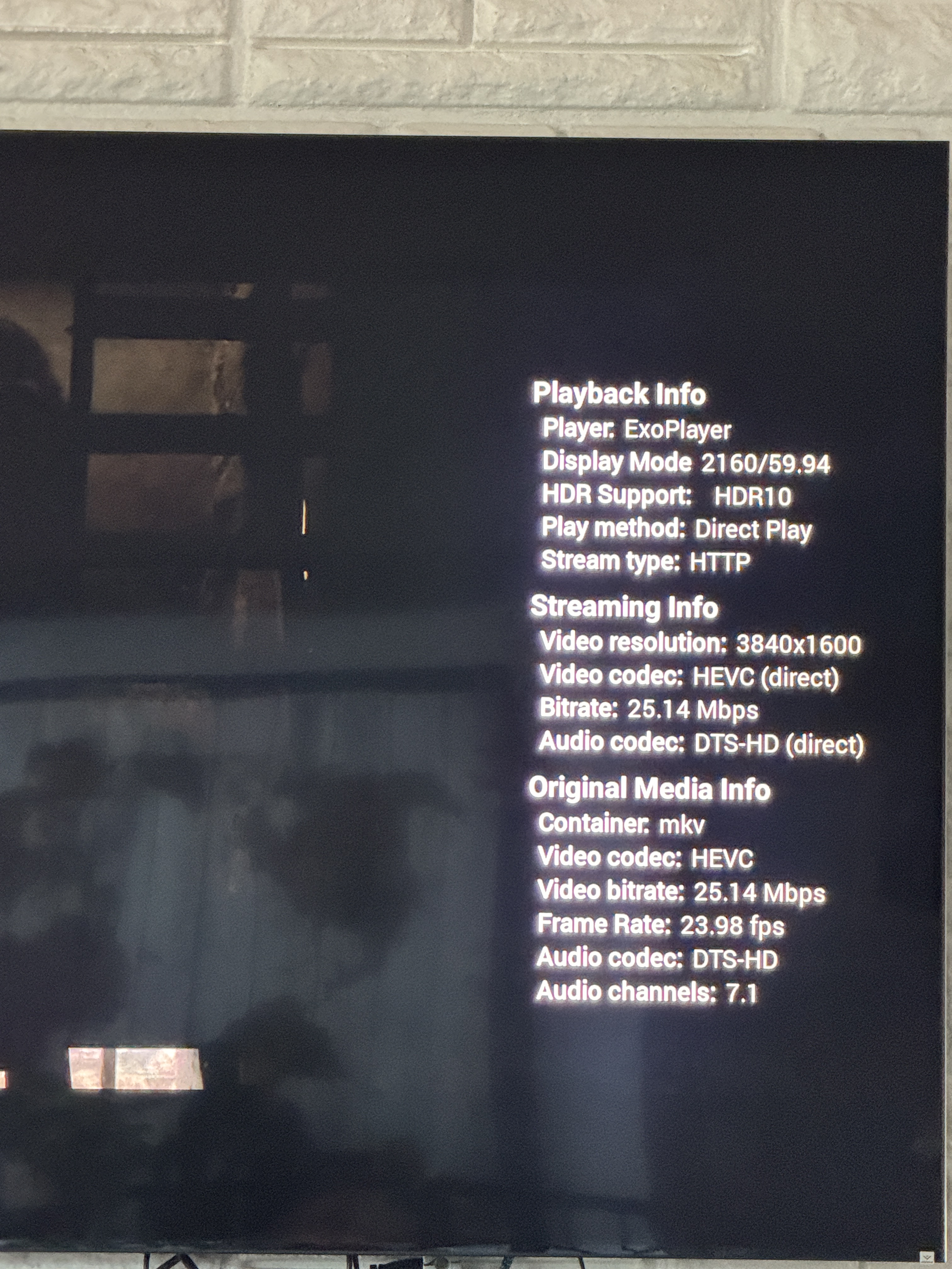

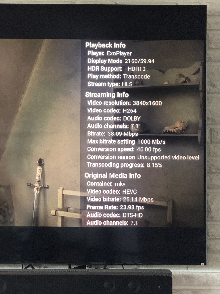

griffindodd 18 Posted August 11, 2024 Author Posted August 11, 2024 Ok so I tried another movie which was also labeled as DTS-MA and that did pass thru. Something is happening with transcoding on certain files, it seems to be moving back and forward between direct stream and transcode in the stats for nerds reporting. I see it change as certain files play. Keeps saying ‘Unsupported Video Level’ as the conversion reason. Can I disable transcoding for the local network? I have no need for it.
Happy2Play 9812 Posted August 11, 2024 Posted August 11, 2024 12 minutes ago, griffindodd said: Keeps saying ‘Unsupported Video Level’ as the conversion reason. What app/client version?
griffindodd 18 Posted August 11, 2024 Author Posted August 11, 2024 Emby client is 2.1.15g Server 4.8.8.0 on Ubuntu Storage is a synology NAS, everything hardwired on gigabit network.
Happy2Play 9812 Posted August 11, 2024 Posted August 11, 2024 (edited) 2 minutes ago, griffindodd said: Emby client is 2.1.15g Server 4.8.8.0 on Ubuntu Storage is a synology NAS, everything hardwired on gigabit network. Has a bug/typo mentioned in other topics. You have to rollback or move forward to beta. Edited August 11, 2024 by Happy2Play
griffindodd 18 Posted August 11, 2024 Author Posted August 11, 2024 (edited) 29 minutes ago, Happy2Play said: Has a bug/typo mentioned in other topics. You have to rollback or move forward to beta. Ahh ok. I'll sign up for beta and give that a try. I tested with Emby for Android and the direct play with DTS worked perfectly on the same file I was using to test, however the Android app demands that I have Emby Premier to play files. Edited August 11, 2024 by griffindodd
ebr 16337 Posted August 11, 2024 Posted August 11, 2024 1 hour ago, griffindodd said: I'll sign up for beta and give that a try. The problem is you are already signed up for beta with Google. What you need to do is sideload the updated beta or exit the beta in Google and go back to production. beta release of the app
griffindodd 18 Posted August 11, 2024 Author Posted August 11, 2024 29 minutes ago, ebr said: The problem is you are already signed up for beta with Google. What you need to do is sideload the updated beta or exit the beta in Google and go back to production. beta release of the app Yep I sideloaded 2.1.16g and everything is working as it should now, thanks for all of the help. 1
