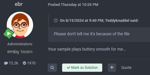

ebr 16335 Posted August 15, 2024 Posted August 15, 2024 55 minutes ago, Teddyknuddel said: Please don't tell me it's because of the file Your sample plays buttery smooth for me...
