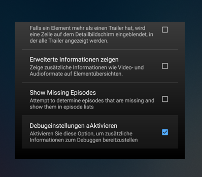

Teddyknuddel 136 Posted August 15, 2024 Author Posted August 15, 2024 So I started playing Manifest S02E13 at 14:52 on my Shield, and finished at 15:01 - server "I5PRODESK" - Western European time This is what I noticed. The display mode does not match the refresh rate. However, the frame rate of the Shield still shows me 25. So something is wrong somewhere. Here is an excerpt from that episode. Sample.mkv You can see it very clearly when the plane flies over the runway during the short intro. It's very jerky there. Furthermore - can you finally correct this? This should read "Debugeinstellungen aktivieren" and not "Debugeinstellungen aAktivieren" And actually, this does not belong in the Screen settings section, but in General playback
