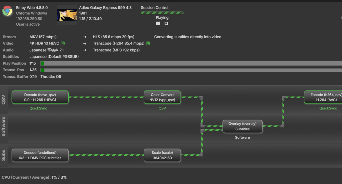

waldoverkill 0 Posted February 17 Posted February 17 On 8/11/2024 at 2:35 AM, RanmaCanada said: Due to the current degredation issues with Intel 13th and 14th gen CPU's you will be forced to buy a 12th gen NUC. As PGS transcoding is indeed CPU bound (and single threaded to boot), you want as much power as you can afford. My i5-1235u laptop can handle 1 4k transcode with PGS subs, barely. The fastestr processor you can get in a NUC is a i5-12500T which is not much faster than what I have in my laptop. if you want PGS subs away from home it would be better to just extract them and convert to SRT or Sub Station Alpha. There is some code apparently on the ffmpeg git for doing it via CUDA, but that would require at least a Turing Nvidia card from what I understand. I have had to turn off tone mapping for the server to use 100% hardware for transcoding the video as tone mapping with subs gets messy and apparently forces software mode (unless something is currently broken with hardware tone mapping). It says the CPU is at 1%, but in checking process manager, ffmpeg is actually taking upwards of 50+. Unless softworkz has done more magic with their godly coding skills, we have to wait for PGS subs to be added in hardware to any of the ASICS that are used by Intel, AMD or Nvidia. Can I ask how you see this dashboard?
Luke 42234 Posted February 17 Posted February 17 4 hours ago, waldoverkill said: Can I ask how you see this dashboard? Hi, that is in the Diagnostics plugin, in the Emby plugin catalog.
waldoverkill 0 Posted February 17 Posted February 17 12 hours ago, Luke said: Hi, that is in the Diagnostics plugin, in the Emby plugin catalog. Thank you.
