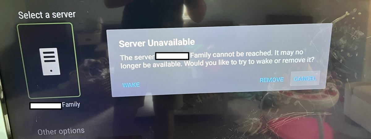

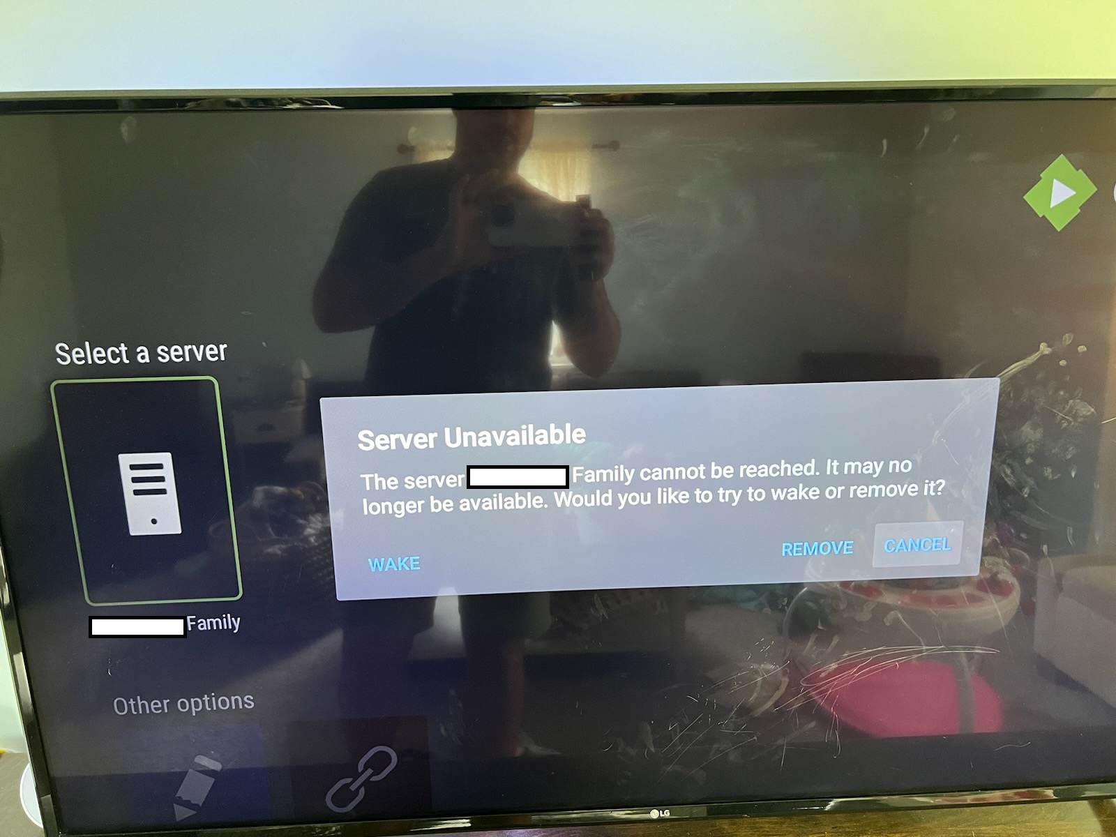

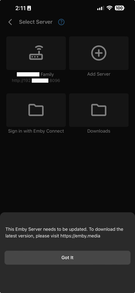

erod859 1 Posted August 8, 2024 Posted August 8, 2024 (edited) Hello, I recently installed my Emby Server, but I'm having trouble connecting my external iOS and Android TV devices to it. When I try to connect my iPhone to the server, I get an error saying that the Emby server needs to be updated. However, I'm currently running the latest version, 4.8.8.0. When I attempt to connect my Nvidia Shield, I get an error stating that my server is unavailable—please excuse the messy living room in the screenshot. I've also created a rule to open port 80 in my Windows Firewall, no VPN is running, and my devices are on the same WiFi network. I've attached my Emby log for your reference. Thanks in advance for your help! embyserver (1).txt Edited August 9, 2024 by GrimReaper Screenshot deleted
