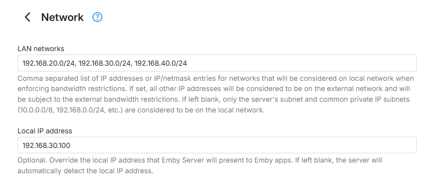

rbjtech 5335 Posted August 8, 2024 Posted August 8, 2024 (edited) 216 is not an RFC1918 local address - it is a Public WAN address. If this is LAN only, then it will 'work' - but it's not ideal. Any reason for this ? - there is plenty of RFC1918 address space that should be used for this purpose. Subnet is also a /26 - again, fine but strange for a home lan. (64 IP's) Have you tried forcing 216.13.1.24 as your emby local IP address and also adding 216.13.1.24/26 into 'LAN networks' to force it into thinkings its a 'local' IP ? (in Dashboard>Server>Network) ? I think you'll likely have contininous issues with routing (not just in emby) - so unless there is a good reason to not use an RFC1918 address for your LAN (or subnets thereof) - then personally, I would change this. What is the switch setup with the UDM ? Are you just using the UDM directly as a switch (I believe it has a 4 port switch built in), or are any other switches cascaded ? Edited August 8, 2024 by rbjtech 1

Lessaj 477 Posted August 8, 2024 Posted August 8, 2024 Okay wired is definitely better. How did you confirm the client is getting 1gig? The port speed is not necessarily indicative of the achievable performance, there could be quality issues with the cabling for example so even if they auto neg to 1gig on the port doesn't mean you can actually get 1gig. I'm not sure if using a non-RFC1918 could cause issues like this but I would definitely recommend changing the address space as a place to start. You could still use 216 in it, maybe 192.168.216.0/26 as that's within the range. I would also definitely recommend a static IP for your server - being always online and refreshing the DHCP lease it should keep the address but it's best to have it statically assigned/configured. 1
rbjtech 5335 Posted August 8, 2024 Posted August 8, 2024 (edited) 16 hours ago, mario1230 said: @rbjtech - The 216 subnet was setup years ago for 1 sentimental reason and 1 practical reason. My father died on Feb-16 so it was my clever way (or so I thought) of keeping him around. Two - as you identified, I wanted to limit the number of potential IPs available. I haven't experienced any issues with any other service or network issues so I was skeptical this could be part of the problem but I am open to changing it. Nice - - i wouldn't change it unless it causing big issues - and as @Lessajhas said - there may be other options to include those sentimental numbers while keeping within RFC1918 16 hours ago, mario1230 said: When you say forcing the IP, I assume you mean static? It's all DHCP right now. After the UDM pro it goes into a separate uni switch which all my devices are then connected to. No I'm referring the Emby config - dashboard>server>networking I'm unsure if emby always considers it's own LAN as local, but you can try forcing it. In my example below (my own VLAN's), 192.168.30.0/24 is the 'local' LAN (vlan 30), but I also want 192.168.20.0/24(vlan 20) and vlan 40 to be considered 'local' as they are - but they are routed via my f/w. If you have multiple interfaces on the emby server - it's also useful to force binding to just the primary one - in my case on vlan 30. Worth a try to keep the 216 - as any network change this big is going to be very disruptive. re - "After the UDM pro it goes into a separate uni switch which all my devices are then connected to" Do you have multiple subnets/vlans/trunks etc - or is this just a small /26 flat lan all on the default vlan ? Edited August 9, 2024 by rbjtech

mario1230 4 Posted August 9, 2024 Author Posted August 9, 2024 Thanks for all the feedback. I've updated my subnet to something more appropriate. After restarting all my devices playback was much better with no real buffering issues. I'll try and put some more media through it this weekend to make sure everything is holding up. One issue I noticed that often times when I first launch Emby on the shield it will prompt with a "could not connect to your configured server" for a second or two and then it quickly loads (within a second or two) the home dashboard. Tonight I had an issue where I started playing the film, the "could not connect" message popped up again and brought me back to the home page shortly after pressing play on the film. I then tried to play again and "couldn't connect" while bringing me back to the home screen again. I tried the third time and alas it played successfully without issue. I'm attaching the latest server log and the attempts took place at these times. 2024-08-09 00:05:46.935 (1st attempt) 2024-08-09 00:06:05.485 (2nd attempt) 2024-08-09 00:06:39.051 (3rd attempt success) Also not sure if it is indicative of anything but I noticed one thing I thought was odd. The fourth line of the server log says Windows 10 but I'm definitely running Win 11. Thanks for the continued support! embyserver (5).txt 1
