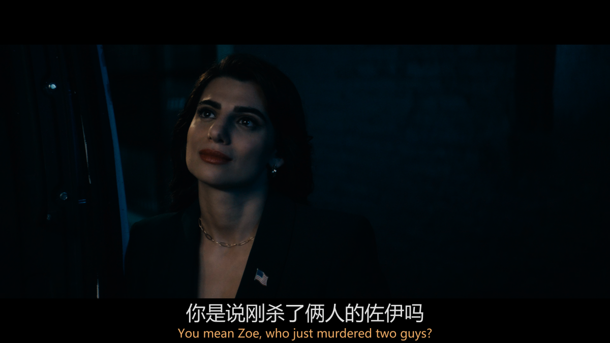

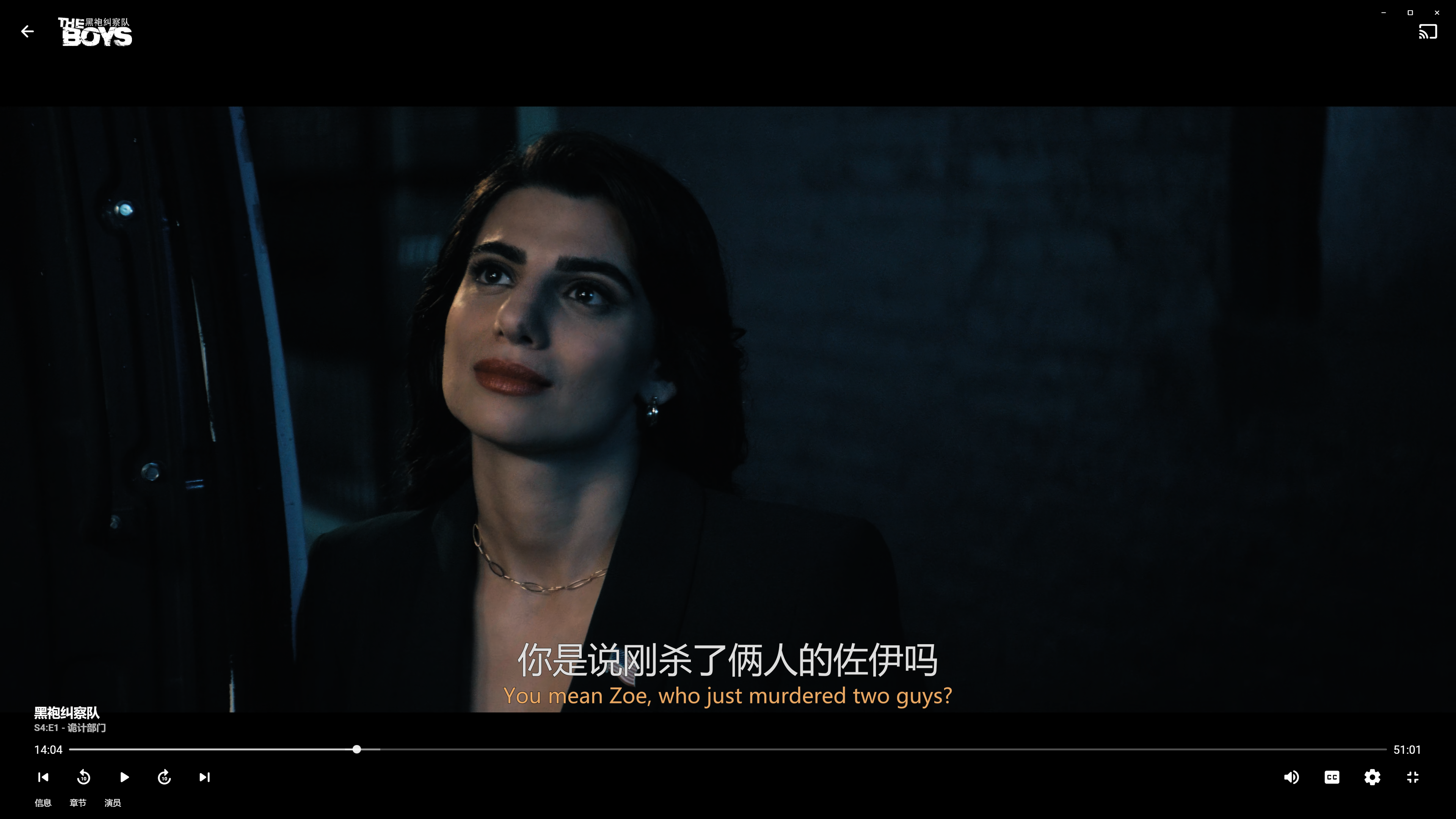

y29shi 8 Posted August 7, 2024 Author Posted August 7, 2024 13 hours ago, Luke said: Hi, can you please show a screenshot example of your issue? Thanks. This is from emby This is from when I was playing it in potplayer.

Luke 42184 Posted August 14, 2024 Posted August 14, 2024 On 8/7/2024 at 8:50 AM, y29shi said: Actually, I am very sure that "the entire picture even the black bars are part of the stream" is not true, because when I play it in potplayer without set it to full screen, the window size is just as the content of the show, which does not include any black bars. But yes, I want the subtitles to show at the edge of my "screen" instead of the stream, regardless if the file include black bars or not. This screenshot is from potplayer when it's not full screen. And this is from potplayer when it's on full screen. This proves that the file itself doesn't include black bars, however potplayer can detect the edge of my actual screen and then place the subtitle near the edge of my screen. However, emby doesn't seem to be able to do that. It only displays subtitles at the edge of the actual content. Hi, more options to control this are always possible for future updates. Thanks.
