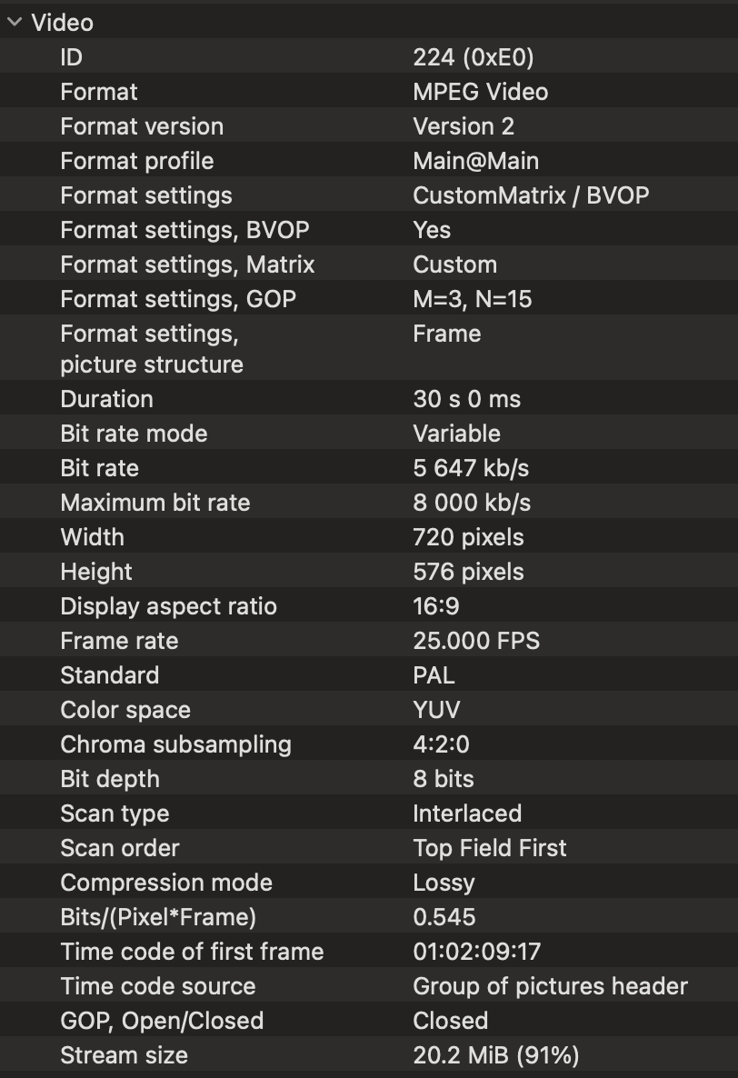

Tony_D 0 Posted August 9, 2024 Author Posted August 9, 2024 Hi Its a QE55Q83A OLED TV , which is perfectly capable of playing anything I have direct from a USB, When I originally uploaded a file ffmpeg converted it to Format version: Version 1 ( MPEG1VIDEO), which does play After modifying my command to retain the orginal format its broken I used medainfo to get more info than is supplied with emby. Format version: Version 2 ( MPEG2VIDEO)all fail in some way, When I try and play an error message :- media player error code: player_error_not_supported_format,player state : IDLE. Sound plays but no video. On my google TV it plays with broken sound and jumpy video from mediainfo:- General Complete name : /mnt/Movies.All/Movies/Films_2/Test.001/002/out2.mpg Format : MPEG-PS File size : 22.2 MiB Duration : 30 s 0 ms Overall bit rate mode : Variable Overall bit rate : 6 218 kb/s Frame rate : 25.000 FPS Video ID : 224 (0xE0) Format : MPEG Video Format version : Version 2
SamES 1084 Posted August 9, 2024 Posted August 9, 2024 10 hours ago, SamES said: My concerns at this stage are that even after transcoding (or container swap, etc) he is still getting a black screen. I haven't seen this with any samples I've tested. When I get an updated test sample I will try and verify this. I also don't think we can currently differentiate between PS and TS type mpeg containers. I've now got the mpeg2 sample. It is an mpeg-ps container and it does fail with DirectPlay. On remux it gives me a black screen. If I take an individual .ts segment from the transcoding folder it DirectPlays fine, so there is nothing wrong with the video stream. Is this because it is an interlaced video stream and we're trying to stream it via hls when we should be transcoding it?
