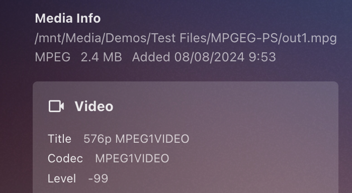

SamES 1084 Posted August 8, 2024 Posted August 8, 2024 (edited) 20 hours ago, Tony_D said: Hi I have just under 700 films that are encoded as MPEG2VIDEO I have attached a 30 second clip off of one of the videos out1.mpg This works fine on my 2017 Samsung, but it has the same issue you are seeing on my 2022 Samsung. You mention MPEG2VIDEO, but the sample is MPEG1 I have some similar files that are also MPEG1. It's possible that they're not supported on newer devices. I'm just not sure which year this might have changed. Despite this, it transcodes and plays fine, so it isn't unplayable for me. What actually happens if you add the sample you provided to a library and play it? Edited August 8, 2024 by SamES

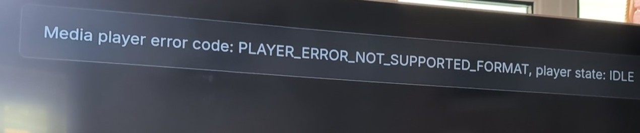

Tony_D 0 Posted August 8, 2024 Author Posted August 8, 2024 Hi Made a slight mistake splitting with ffmpeg, I missed the -c copy from the command so it was changing the video into Format version: Version 1 ( MPEG1VIDEO) New video file attatched, and verified problem on my TV I used medainfo to get more info than is supplied with emby. Format version: Version 2 ( MPEG2VIDEO)all fail in some way, When I try and play an error message :- media player error code: player_error_not_supported_format,player state : IDLE. Sound plays but no video. On my google TV it plays with broken sound and jumpy video from mediainfo:- General Complete name : /mnt/Movies.All/Movies/Films_2/Test.001/002/out2.mpg Format : MPEG-PS File size : 22.2 MiB Duration : 30 s 0 ms Overall bit rate mode : Variable Overall bit rate : 6 218 kb/s Frame rate : 25.000 FPS Video ID : 224 (0xE0) Format : MPEG Video Format version : Version 2 out2.mpg
