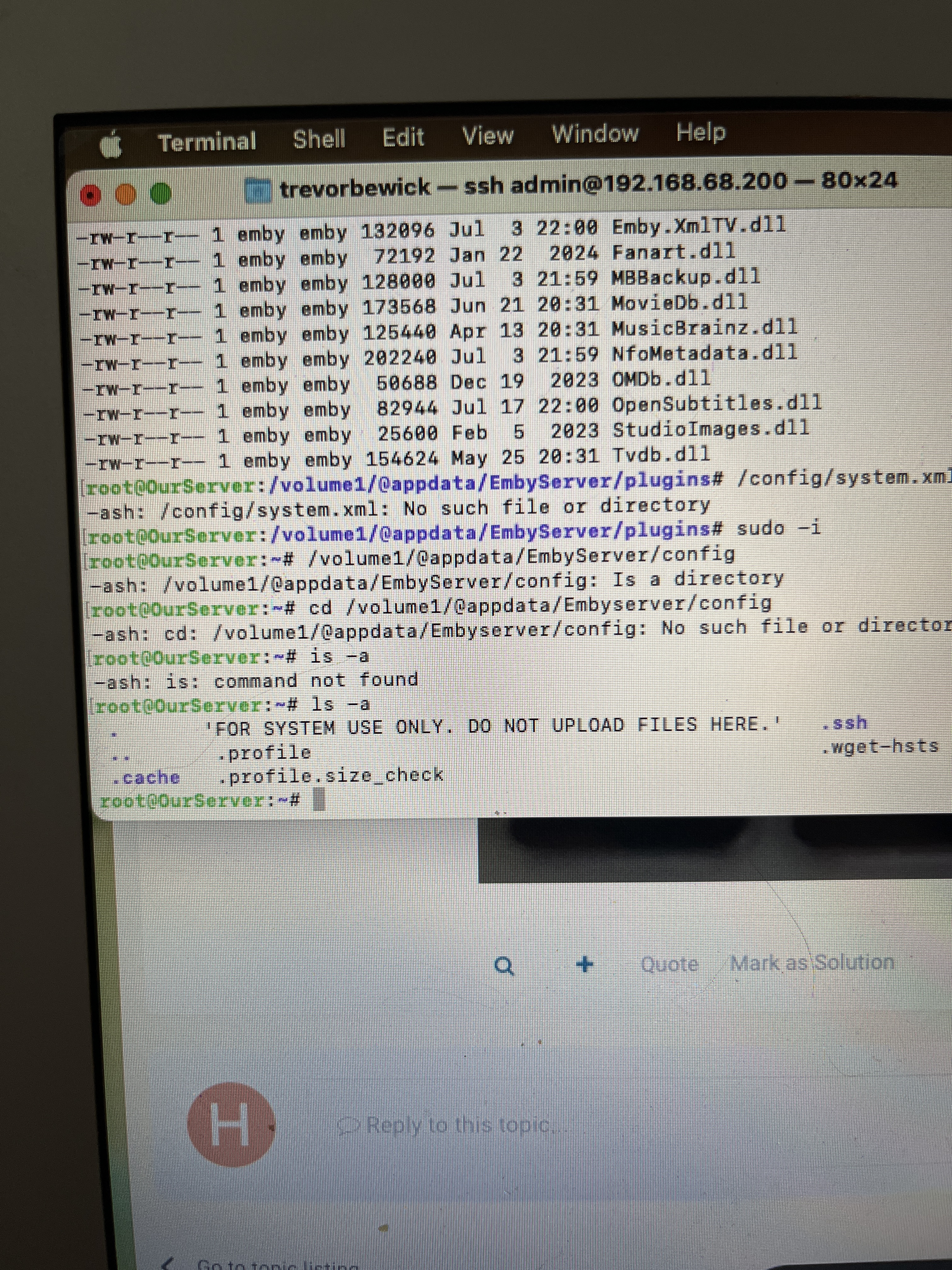

tandafam 0 Posted August 5, 2024 Posted August 5, 2024 I have set up the nas for ssh and am in terminal. I followed the guide but I don't know at what point I run the command you sent. I'm sorry if this is really basic or I'm not explaing my problem well enough. I can see configuration in blue. And clicked on it and I get this

heavywrench 2 Posted August 5, 2024 Author Posted August 5, 2024 yes I think so. I will try again. will I be able to set my IP address back to what it was before? in the config part?

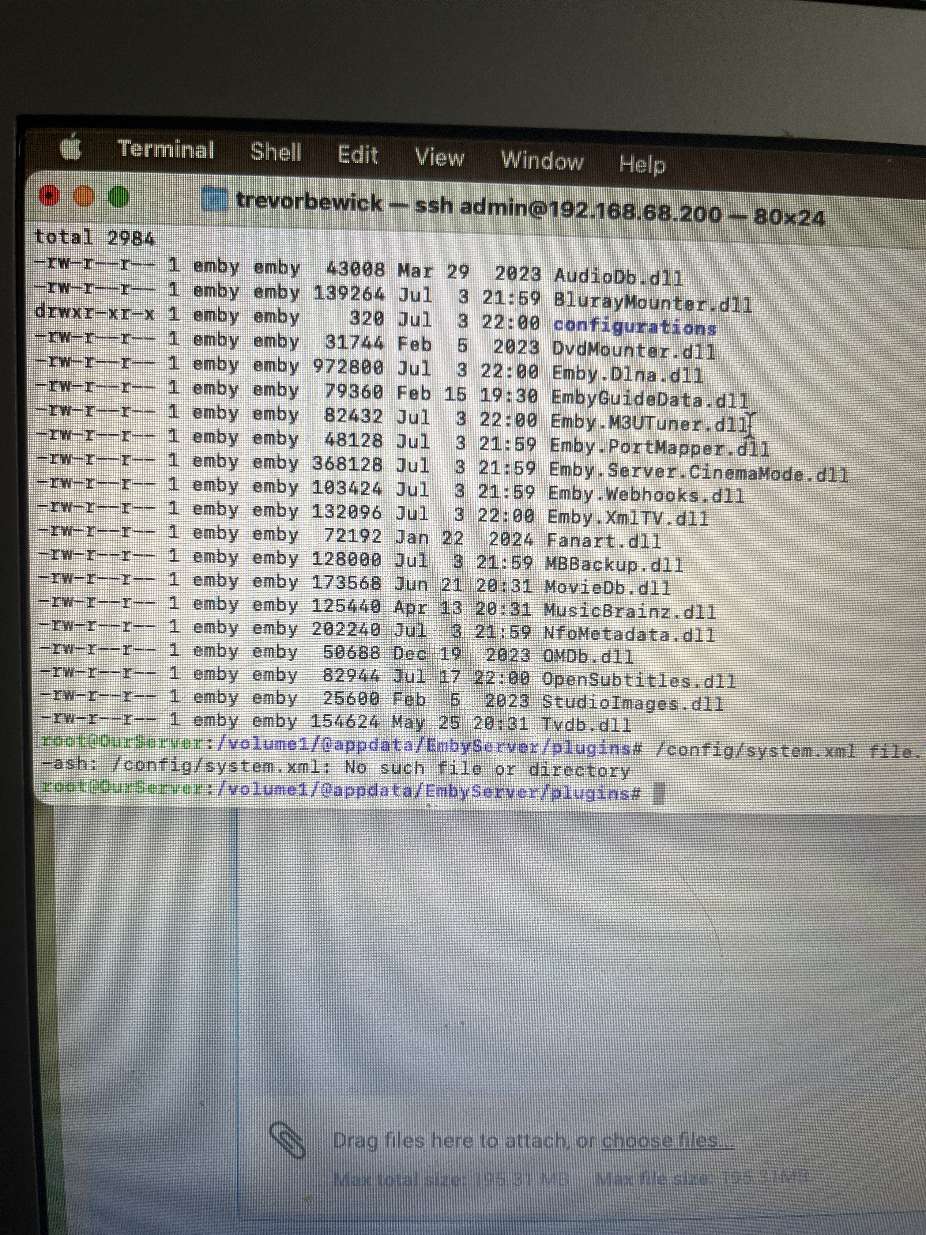

FrostByte 5453 Posted August 5, 2024 Posted August 5, 2024 (edited) If you cd to the following folder and list the contents can you see system.xml ? cd /volume1/@appdata/EmbyServer/config/ ls -a Edited August 5, 2024 by FrostByte
FrostByte 5453 Posted August 5, 2024 Posted August 5, 2024 That command should start with a small L. ls for list. "ls -a" https://www.maths.cam.ac.uk/computing/linux/unixinfo/ls
FrostByte 5453 Posted August 5, 2024 Posted August 5, 2024 Okay, I don't think you're in the correct folder though. I think you're still in the root folder. Also, folders are case sensitive and you had a small s in EmbyServer
FrostByte 5453 Posted August 5, 2024 Posted August 5, 2024 Once you're in the correct folder it should display the folder in the command prompt every time you type something. Similar to the blue in your pic when you were in the plugins folder

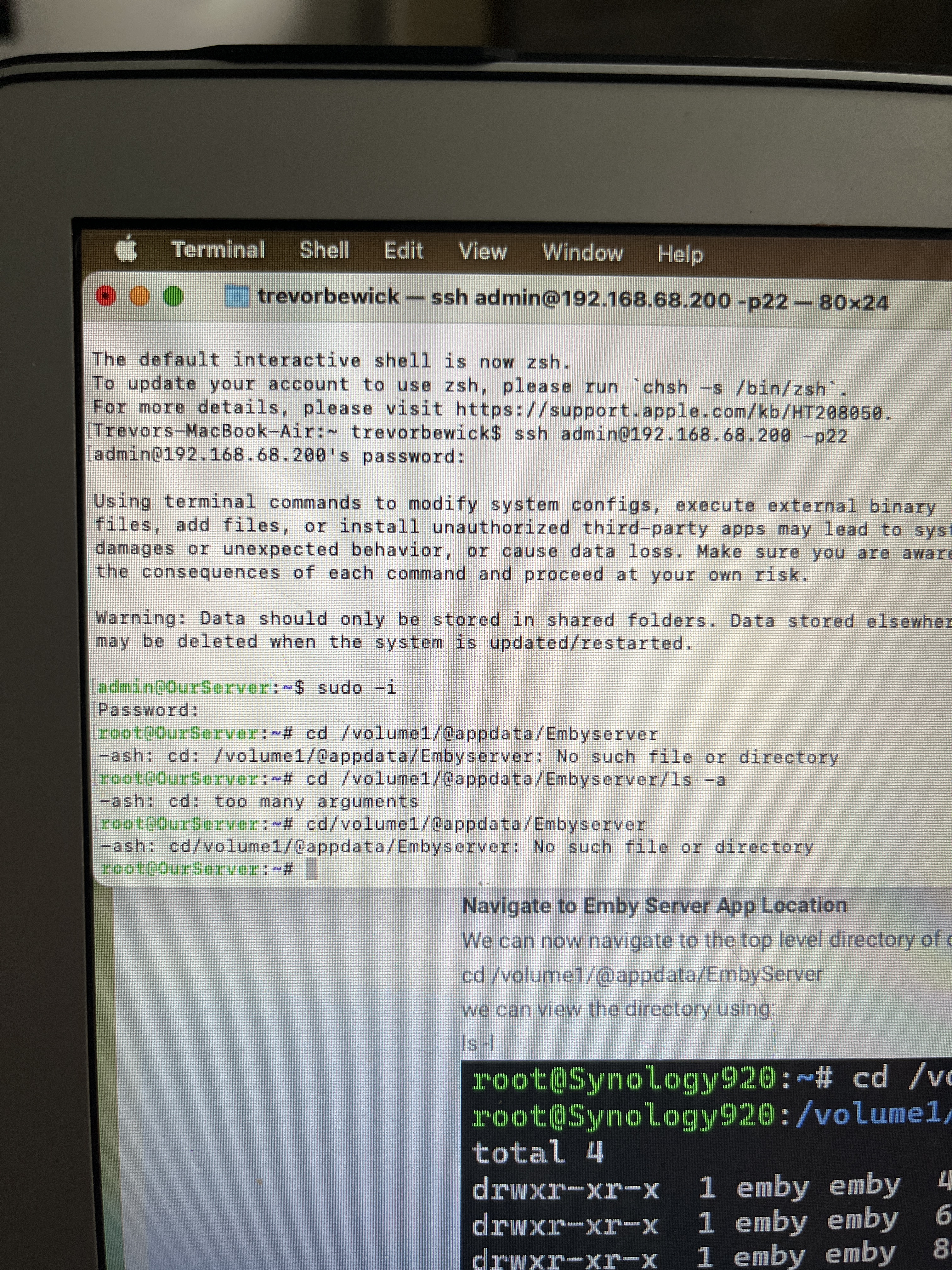

tandafam 0 Posted August 5, 2024 Posted August 5, 2024 Ok. I followed the tutorial on how to ssh and that's how I got to the root folder. How do I get out of it? I have no experience with this
FrostByte 5453 Posted August 5, 2024 Posted August 5, 2024 redo the cd command like in my post above. You typed EmbyServer incorrectly

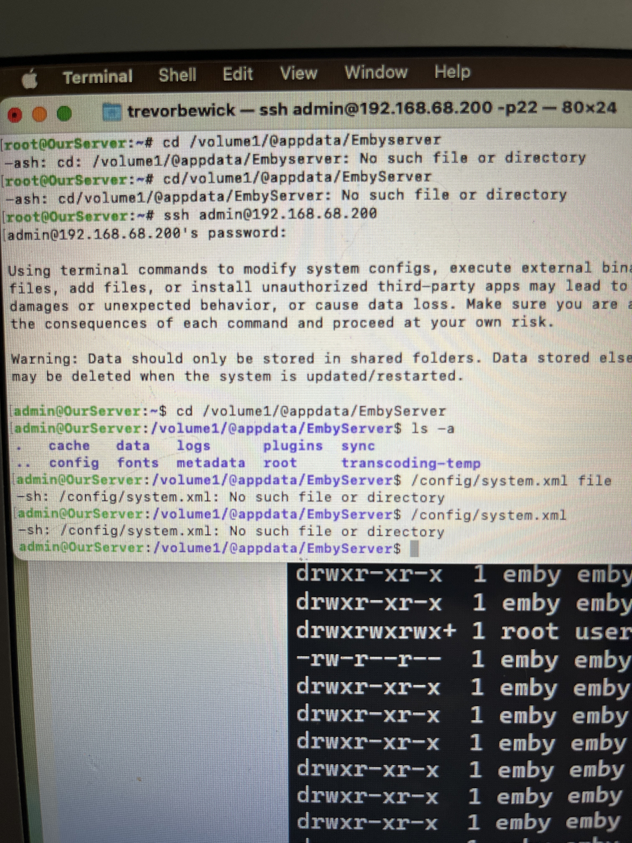

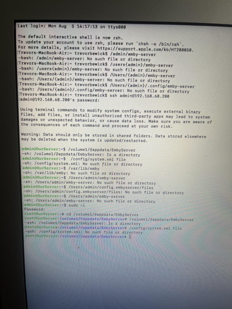

tandafam 0 Posted August 5, 2024 Posted August 5, 2024 I have tried from the start of the tutorial. I get this now
FrostByte 5453 Posted August 5, 2024 Posted August 5, 2024 Okay, once you start editing system.xml these are the 3 lines Luke wanted you to edit. <EnableRemoteAccess>true</EnableRemoteAccess> <LocalNetworkSubnets /> <LocalNetworkAddresses />
FrostByte 5453 Posted August 5, 2024 Posted August 5, 2024 Okay, you need to go one folder further. Do not put a slash / in the command else it will start from root. "cd config"
FrostByte 5453 Posted August 5, 2024 Posted August 5, 2024 Or, type the following: cd /volume1/@appdata/EmbyServer/config/
