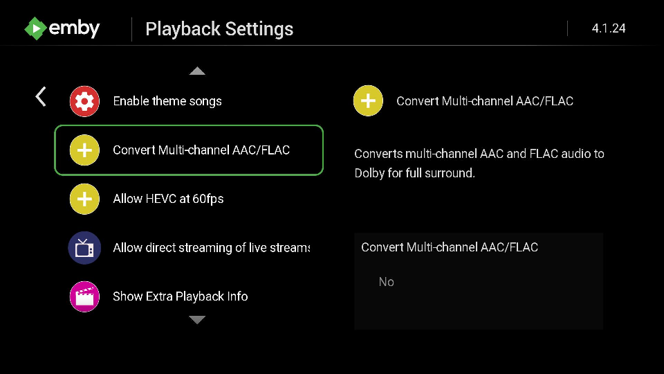

speechles 2062 Posted August 4, 2024 Posted August 4, 2024 (edited) @Blam84How do you have the setting above set? The Roku will convert multi-channel AAC into stereo AAC on the device, no transcoding necessary, but you lose surround sound. You have to decide. Would you would rather: 1) direct play of the audio stream 2) keep surround sound always Because if it direct plays the Roku is going to convert that AAC 5.1 -> AAC 2.0 on the device itself and you will lose all surround. But at the same time if the glitching of the video stream during repackage is the issue, I am sure this is an acceptable loss, and you would rather direct play. Personally I keep the setting shown above always at "NO" because I am not too concerned at the loss of surround as I am versus transcoding. But you may feel differently. The setting allows you to be in control of how this is handled entirely. We default this to NO so if it is set to YES you have changed it at some point. With the setting set to YES your Emby server will realize you don't want the Roku to change AAC 5.1 -> AAC 2.0 and instead want Emby server to transcode into AC3 5.1 if the Roku supports it. This will cause audio stream transcoding and HLS is used. Also.. if you are using "Volume Mode" on your Roku with anything other than "OFF" it will disable all surround codecs. Volume mode will only work with stereo sound so the capabilities of the Roku will change when you change Volume Mode to Night or Leveling. Using OFF will allow surround sound again. Just FYI. The change does not take immediate effect. You must stop and restart what you had playing after changing the volume mode for this to happen. The stream cannot change until the player respawns it is a Roku requirement. https://support.roku.com/article/226802507 Edited August 4, 2024 by speechles 1
user84 48 Posted August 4, 2024 Author Posted August 4, 2024 12 minutes ago, speechles said: @Blam84How do you have the setting above set? The Roku will convert multi-channel AAC into stereo AAC on the device, no transcoding necessary, but you lose surround sound. You have to decide. Would you would rather: 1) direct play of the audio stream 2) keep surround sound always Because if it direct plays the Roku is going to convert that AAC 5.1 -> AAC 2.0 on the device itself and you will lose all surround. But at the same time if the glitching of the video stream during repackage is the issue, I am sure this is an acceptable loss, and you would rather direct play. Personally I keep the setting shown above always at "NO" because I am not too concerned at the loss of surround as I am versus transcoding. But you may feel differently. The setting allows you to be in control of how this is handled entirely. We default this to NO so if it is set to YES you have changed it at some point. With the setting set to YES your Emby server will realize you don't want the Roku to change AAC 5.1 -> AAC 2.0 and instead want Emby server to transcode into AC3 5.1 if the Roku supports it. This will cause audio stream transcoding and HLS is used. Also.. if you are using "Volume Mode" on your Roku with anything other than "OFF" it will disable all surround codecs. Volume mode will only work with stereo sound so the capabilities of the Roku will change when you change Volume Mode to Night or Leveling. Using OFF will allow surround sound again. Just FYI. The change does not take immediate effect. You must stop and restart what you had playing after changing the volume mode for this to happen. The stream cannot change until the player respawns it is a Roku requirement. I am new to much of this, so thank you for the helpful response. I do have this setting on "Yes" and haven't had any issues with getting surround sound. The only issue I have is the glitching. -If this is set to "Yes" and the surround sound isn't a problem...why is the Video a problem? -All of my files are not 5.1 AAC, but some are. If "playback correction" fixes the issue, why not force that on 5.1 AAC files after they are paused? -I am trying to just get my library set and be done with it and I keep hitting these issues. Can you tell me what markers I should look for in both video and audio that will make sure my media plays how it is expected? Thanks for the help
speechles 2062 Posted August 4, 2024 Posted August 4, 2024 (edited) The Roku uses the audio signal to time the video segments. HLS is used because you have unsupported AAC 5.1 audio and the audio must be transcoded. Because of this the Roku might get segments fed to it, but it wants keyframes at the start which are missing. The segments don't have to start on keyframes because we want 3 second segments. But the Roku will want to start on keyframes. It will then ask for 1-2 seconds before the point you wanted to start in an attempt to get those keyframes. Everything must be aligned into 3 second segments when using HLS. That is why I suggested you might try with the option set to NO. Then you can see if that solves the glitching. If this is a brand new Roku device you may not lose surround sound and the device might support AAC 5.1 correctly. If the media is direct playing entirely it should fix those issues you are having with HLS. Edited August 4, 2024 by speechles

ebr 16332 Posted August 4, 2024 Posted August 4, 2024 32 minutes ago, Blam84 said: Unfortunately I do lose surround sound when I turn that setting to No. Correct, as stated before - the Roku doesn't support the audio format you are using. Are you ripping to AAC 5.1 intentionally for some reason? That is not going to be widely supported. You'd be much better off with something like AC3 (Dolby). The issues you are seeing are related to us trying to convert the unsupported format to Dolby but that can sometimes not always work perfectly - depending on the source.
