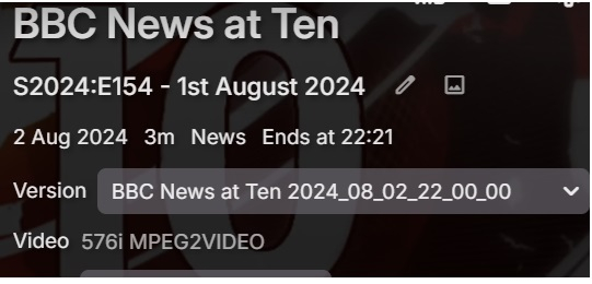

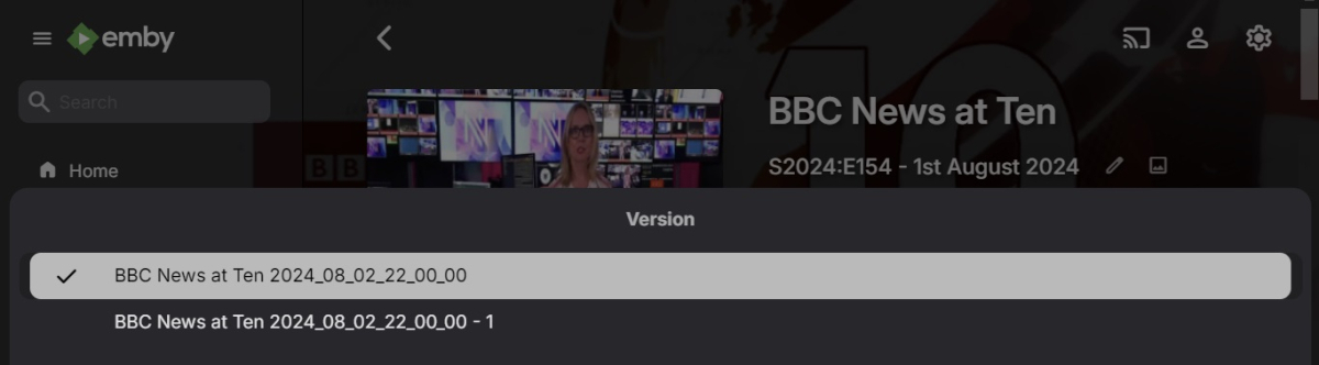

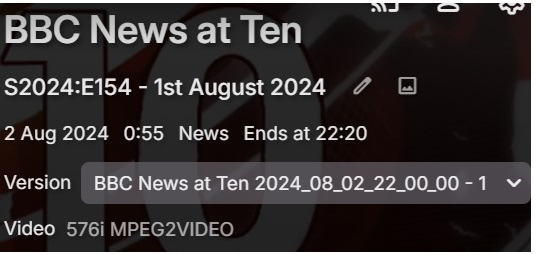

sa2000 697 Posted August 2, 2024 Posted August 2, 2024 (edited) 19 hours ago, Theradioguy said: In this example, I record for about 30 seconds, wait roughly 10 minutes, then record for another 30 seconds. The first recording is about a minute in length (in line with expectations), but the second recording is 8 minutes in length, and includes the entire duration from when the first recording was started. Update: I have just tested this out using a recent beta version - 4.9.0.27 I recorded the news selecting record (not record series) After 3 minutes I cancelled the recording Then I waited a couple of minutes and clicked on record again - for the same program After about a minute I cancelled the recording What I have in the library after is two versions of the episode - one being 3 minutes and one being 55 seconds - which is what you want. Have a look at the durations showing in the screenshots The 2 versions available in the drop down: Edited August 2, 2024 by sa2000

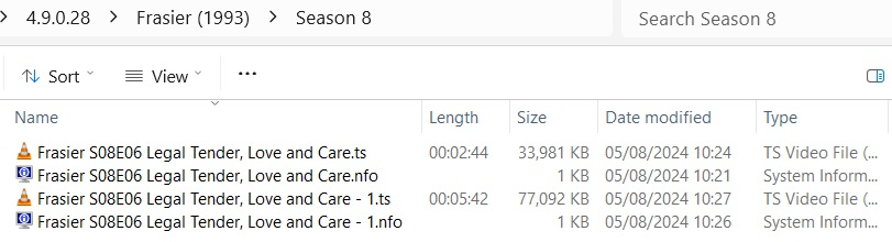

sa2000 697 Posted August 5, 2024 Posted August 5, 2024 (edited) @LukeI have reproduced the reported issue on 4.9.0.28 with an HD Homerun Duo Steps I did to repro this behaviour: - At 10:21 Start Recording an airing - At 10:23 start watching the LiveTV airing on a device - At 10:24 Stop the recording - At 10:26 start a second recording of the same airing - At 10:27 stop this 2nd recording The result is that we have two recording files - the second one is 5 minutes long instead of 1 minute Note that when starting to watch the airing at 10:23 I was asked if I want to watch from the beginning of the buffer or from current time. i chose the latter. When starting the 2nd recording at 10:26 we could look into asking if the recording should include the earlier captured buffer ? This screenshot shows the resulting files for this test Edited August 5, 2024 by sa2000
