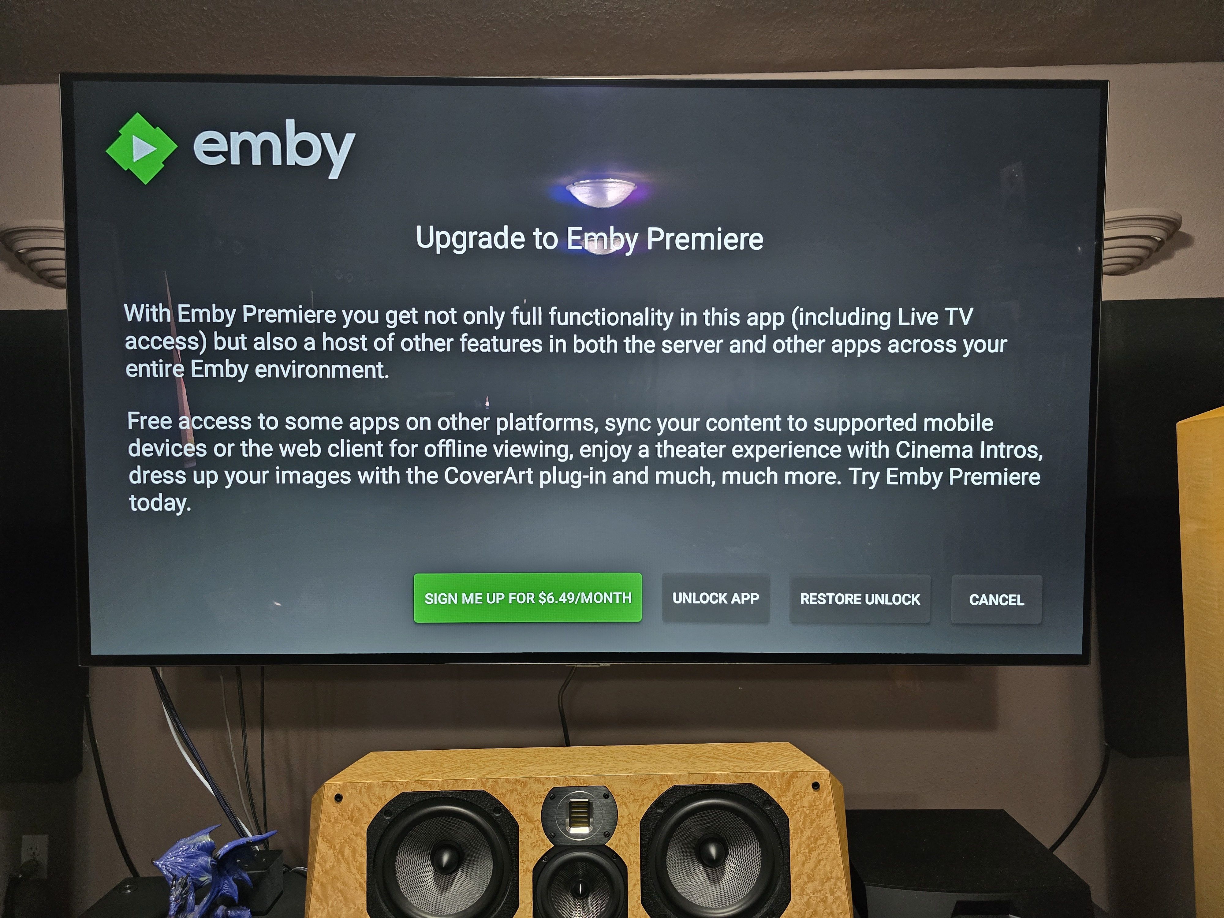

audiom3 12 Posted August 7, 2024 Author Posted August 7, 2024 Hi Luke. We have figured out the cause of the problem. Not that it is emby's fault but TCL TVs and emby don't play well together. Lowering bitrate doesn't help for some reason. It just won't play certain titles and most of the other 4k movies will have some stutter and/or buffering. The good news is that I gave my daughter my 3rd Gen FireTV Cube and she can play any/everything now. My wifi is pretty solid, even though all of my equipment is hard-wired except my tablet and phone. So the only way I could experiment with emby/wifi was on her TV. Oh, I do have one last question. I am receiving this message when I try to play something off of my father's server. Screenshot was taken off my Nvidia ShieldTV Pro. I have a lifetime sub already. Thank you!
ebr 16337 Posted August 7, 2024 Posted August 7, 2024 3 hours ago, audiom3 said: try to play something off of my father's server. Screenshot was taken off my Nvidia ShieldTV Pro. I have a lifetime sub already. Hi. Your Emby Premiere subscription is tied to your server. Any other server you connect to will need to have its own Premiere. 1
audiom3 12 Posted August 7, 2024 Author Posted August 7, 2024 2 hours ago, ebr said: Hi. Your Emby Premiere subscription is tied to your server. Any other server you connect to will need to have its own Premiere. Ok, got ya. The way the app/popup is worded, it looks like it wants me to pay (note the screen grab above). So it was very confusing.
Happy2Play 9812 Posted August 7, 2024 Posted August 7, 2024 4 hours ago, audiom3 said: Ok, got ya. The way the app/popup is worded, it looks like it wants me to pay (note the screen grab above). So it was very confusing. Not knowing the situation but you could do this. Using Multiple Servers | Emby Documentation 1
