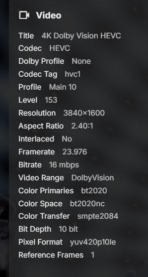

podonnell 48 Posted August 1, 2024 Posted August 1, 2024 Hello there, New user, coming over (possibly) from Jellyfin. I've had a ton of player issues with JF so I'm evaluating Emby. One thing I am seeing right now is all my MKV files will not play Dolby Vision, they fall back to HDR. I know I would sometimes see a Remux from Jellyfin, but I don't know if that was all the time with MKV files. Anyway, hoping this is enough information to help figure out how I can get my Dolby Vision working -- I have ~20 DV titles, only one of them is in MP4 format. Thanks!
Happy2Play 9811 Posted August 1, 2024 Posted August 1, 2024 Need specific examples along with server and ffmpeg logs. But usually comes back to the DV profile as 7 is usually the issue.
podonnell 48 Posted August 1, 2024 Author Posted August 1, 2024 (edited) 18 minutes ago, Happy2Play said: Need specific examples along with server and ffmpeg logs. But usually comes back to the DV profile as 7 is usually the issue. https://pastebin.com/MzUttFVv This was the most recent test I ran. This one is Profile 7 but it plays in Dolby Vision just fine with Jellyfin. I also have a bunch of Profile 8 titles that do the same. I tested all 20 titles and the sole one to play was .mp4 with the following media info. Edited August 1, 2024 by podonnell

podonnell 48 Posted August 1, 2024 Author Posted August 1, 2024 (edited) Sorry, no idea why pastebin is doing that. I use it all the time. Attaching them here. The server log is for another title that is Profile 8 embyserver (1).txt ffmpeg-remux-8759ab80-fc35-42c5-aa60-f1b60600739f_1.txt Edited August 1, 2024 by podonnell
Happy2Play 9811 Posted August 1, 2024 Posted August 1, 2024 (edited) Okay this one works. I am confused as this suggest transcoding 2024-07-31 21:52:09.852 Info Server: http/1.1 POST http://192.168.1.250:8096/emby/Items/158/PlaybackInfo?UserId=9a131fd3fb95499692f0d8d9b9bb241b&StartTimeTicks=0&IsPlayback=false&AutoOpenLiveStream=false&MaxStreamingBitrate=4000002&X-Emby-Client=Emby Web&X-Emby-Device-Name=Chrome Windows&X-Emby-Device-Id=53639bd6-ebc4-4f13-a0ce-3e923b6e47bd&X-Emby-Client-Version=4.8.8.0&X-Emby-Token=x_secret5_x&X-Emby-Language=en-us&reqformat=json. UserAgent: Mozilla/5.0 (Windows NT 10.0; Win64; x64) AppleWebKit/537.36 (KHTML, like Gecko) Chrome/127.0.0.0 Safari/537.36 2024-07-31 21:37:02.824 Info App: User policy . EnablePlaybackRemuxing: True EnableVideoPlaybackTranscoding: True EnableAudioPlaybackTranscoding: True 2024-07-31 21:37:02.824 Info App: Bitrate exceeds DirectPlay limit: media bitrate: 30831784, max bitrate: 4000002 2024-07-31 21:37:02.824 Info App: Bitrate exceeds DirectStream limit: media bitrate: 30831784, max bitrate: 4000002 2024-07-31 21:37:02.829 Info App: Bitrate exceeds DirectPlay limit: media bitrate: 30831784, max bitrate: 4000002 2024-07-31 21:37:02.829 Info App: Bitrate exceeds DirectStream limit: media bitrate: 30831784, max bitrate: 4000002 2024-07-31 21:37:02.834 Info App: Bitrate exceeds DirectPlay limit: media bitrate: 30831784, max bitrate: 4000002 2024-07-31 21:37:02.834 Info App: Bitrate exceeds DirectStream limit: media bitrate: 30831784, max bitrate: 4000002 But this suggests direct play. 2024-07-31 21:52:19.773 Info Server: http/1.1 Response 200 to host4. Time: 11ms. POST http://192.168.1.250:8096/emby/Items/158/PlaybackInfo?UserId=9a131fd3fb95499692f0d8d9b9bb241b&StartTimeTicks=0&IsPlayback=false&AutoOpenLiveStream=false&MaxStreamingBitrate=200000000&X-Emby-Client=Emby for LG&X-Emby-Device-Name=LG Smart TV (OLED77G3PUA)&X-Emby-Device-Id=a54fe202-89c8-41de-ada2-0c8631eef132&X-Emby-Client-Version=1.0.43&X-Emby-Token=x_secret4_x&X-Emby-Language=en-us&reqformat=json 2024-07-31 21:52:20.380 Info Server: http/1.1 GET http://192.168.1.250:8096/emby/videos/158/original.mkv?DeviceId=a54fe202-89c8-41de-ada2-0c8631eef132&MediaSourceId=8053e1383d90a0e981019a88e4e8271f&PlaySessionId=c3fea80492aa41dfaab3ad2f9325627a&api_key=x_secret4_x. Connection=close, Host=host2, User-Agent=Mozilla/5.0 (Web0S; Linux/SmartTV) AppleWebKit/537.36 (KHTML, like Gecko) Chrome/94.0.4606.128 Safari/537.36 WebAppManager, Accept-Encoding=identity, Range=bytes=0-, icy-metadata=1 @Lukehow does /jellyfin/users/ happen? Line 8: 2024-07-31 21:30:00.030 Info Server: http/1.1 Response 404 to 192.168.1.250. Time: 0ms. GET http://192.168.1.250:8096/jellyfin/Users/67d0942562cb4d62a05053c718d35456/Items/Latest?Limit=12&ParentId=f137a2dd21bbc1b99aa5c0f6bf02a805 Line 9: 2024-07-31 21:35:00.034 Info Server: http/1.1 Response 404 to 192.168.1.250. Time: 0ms. GET http://192.168.1.250:8096/jellyfin/Users/67d0942562cb4d62a05053c718d35456/Items/Latest?Limit=12&ParentId=f137a2dd21bbc1b99aa5c0f6bf02a805 Line 118: 2024-07-31 21:40:00.032 Info Server: http/1.1 Response 404 to 192.168.1.250. Time: 0ms. GET http://192.168.1.250:8096/jellyfin/Users/67d0942562cb4d62a05053c718d35456/Items/Latest?Limit=12&ParentId=f137a2dd21bbc1b99aa5c0f6bf02a805 Line 119: 2024-07-31 21:45:00.031 Info Server: http/1.1 Response 404 to 192.168.1.250. Time: 0ms. GET http://192.168.1.250:8096/jellyfin/Users/67d0942562cb4d62a05053c718d35456/Items/Latest?Limit=12&ParentId=f137a2dd21bbc1b99aa5c0f6bf02a805 Line 120: 2024-07-31 21:50:00.035 Info Server: http/1.1 Response 404 to 192.168.1.250. Time: 0ms. GET http://192.168.1.250:8096/jellyfin/Users/67d0942562cb4d62a05053c718d35456/Items/Latest?Limit=12&ParentId=f137a2dd21bbc1b99aa5c0f6bf02a805 Edited August 1, 2024 by Happy2Play
podonnell 48 Posted August 1, 2024 Author Posted August 1, 2024 4 minutes ago, Happy2Play said: Okay this one works. I am confused as this suggest transcoding 2024-07-31 21:52:09.852 Info Server: http/1.1 POST http://192.168.1.250:8096/emby/Items/158/PlaybackInfo?UserId=9a131fd3fb95499692f0d8d9b9bb241b&StartTimeTicks=0&IsPlayback=false&AutoOpenLiveStream=false&MaxStreamingBitrate=4000002&X-Emby-Client=Emby Web&X-Emby-Device-Name=Chrome Windows&X-Emby-Device-Id=53639bd6-ebc4-4f13-a0ce-3e923b6e47bd&X-Emby-Client-Version=4.8.8.0&X-Emby-Token=x_secret5_x&X-Emby-Language=en-us&reqformat=json. UserAgent: Mozilla/5.0 (Windows NT 10.0; Win64; x64) AppleWebKit/537.36 (KHTML, like Gecko) Chrome/127.0.0.0 Safari/537.36 2024-07-31 21:37:02.824 Info App: User policy . EnablePlaybackRemuxing: True EnableVideoPlaybackTranscoding: True EnableAudioPlaybackTranscoding: True 2024-07-31 21:37:02.824 Info App: Bitrate exceeds DirectPlay limit: media bitrate: 30831784, max bitrate: 4000002 2024-07-31 21:37:02.824 Info App: Bitrate exceeds DirectStream limit: media bitrate: 30831784, max bitrate: 4000002 2024-07-31 21:37:02.829 Info App: Bitrate exceeds DirectPlay limit: media bitrate: 30831784, max bitrate: 4000002 2024-07-31 21:37:02.829 Info App: Bitrate exceeds DirectStream limit: media bitrate: 30831784, max bitrate: 4000002 2024-07-31 21:37:02.834 Info App: Bitrate exceeds DirectPlay limit: media bitrate: 30831784, max bitrate: 4000002 2024-07-31 21:37:02.834 Info App: Bitrate exceeds DirectStream limit: media bitrate: 30831784, max bitrate: 4000002 But this suggests direct play. 2024-07-31 21:52:19.752 Info Server: http/1.1 Response 200 to host4. Time: 13ms. POST http://192.168.1.250:8096/emby/Items/158/PlaybackInfo?UserId=9a131fd3fb95499692f0d8d9b9bb241b&StartTimeTicks=0&IsPlayback=true&AutoOpenLiveStream=true&AudioStreamIndex=2&SubtitleStreamIndex=-1&MediaSourceId=8053e1383d90a0e981019a88e4e8271f&MaxStreamingBitrate=200000000&X-Emby-Client=Emby for LG&X-Emby-Device-Name=LG Smart TV (OLED77G3PUA)&X-Emby-Device-Id=a54fe202-89c8-41de-ada2-0c8631eef132&X-Emby-Client-Version=1.0.43&X-Emby-Token=x_secret4_x&X-Emby-Language=en-us&reqformat=json Hmm, for that title I can see both Audio and Video show 'Direct Play' in the stats for nerds.
Happy2Play 9811 Posted August 1, 2024 Posted August 1, 2024 I see it is two different clients looking at the same content as the limit applied to Chrome while the other is LG Smart TV.
podonnell 48 Posted August 1, 2024 Author Posted August 1, 2024 3 minutes ago, Happy2Play said: I see it is two different clients looking at the same content as the limit applied to Chrome while the other is LG Smart TV. Hmm.. The LG Smart TV should be where I was watching from. The Chrome client I was attempting to pull logs, maybe it snuck in there as I was poking around.
