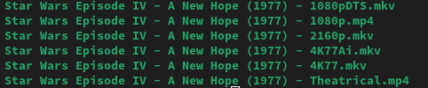

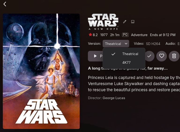

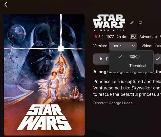

austinchief 5 Posted August 1, 2024 Posted August 1, 2024 I have movies in my library that have multiple versions, but emby only shows two (2), and it seems to change if I add/replace a source and then re-scan. For instance, I have Star Wars with 6 different versions: - 1080pDTS.mkv - 1080p.mp4 - 2160p.mkv - 4K77Ai.mkv - 4K77.mkv - Theatrical.mp4 Ok ... while drafting this topic, I decided to delete ALL .nfo files in the library directory and re-scan. Now, instead of showing the 1080p and Theatrical, it shows Theatrical and 4K77. I don't get it!!!

Luke 42310 Posted August 1, 2024 Posted August 1, 2024 Hi, in the 4.8.8 stable release there is an issue causing multi-version to be limited to 2 versions in some situations. The fix will be in 4.8.9 and is currently in the beta channel if you need immediate relief. Thanks.
austinchief 5 Posted August 1, 2024 Author Posted August 1, 2024 @LukeThanks for the acknowledgement and option for the Beta. I will wait until 4.8.9 @Happy2PlayYou nailed it! I removed all the unused tags on the library elements, and as parental controls ... scanned the library again and now all multi-versions are showing up. Not sure I understand the root cause of why parental control tags limited it to showing 2 versions, but I'm fully operational again! Thanks for the prompt responses, you guys are AWESOME!!! 1

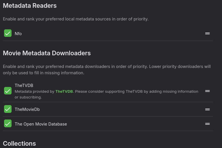

lordairivis 9 Posted July 17, 2025 Posted July 17, 2025 (edited) 6 hours ago, brothom said: @lordairivisif one of the version disappears ONLY when parental controls are enabled then one of these versions must have different metadata than the others. Can you sure the schema of your parental controls and possible also an NFO extract of all 3 movies? Attached the nfo files for each of the different versions I have. They all appear to be basically the same except for obviously the title/sorttitle and video file details. 4 hours ago, Happy2Play said: Do you write nfo files with media? Are you allowing or excluding tags in parental control? Testing this added three versions in different folder in same library search for media Manually grouped them Logged in with different user with "exclusive" allow tag No media showed up as nothing is tagged. Logged out and back in with admin Tagged the grouped media Logged in with restricted user One movie showed up from the grouped media ie the one Emby shows as primary when you go to edit metadata on the grouped items. Now I changed from Allow to Block and restricted user saw two versions grouped as one ie Emby primary item for group has a tag. One issue where edited metadata does not propagate to all versions. Got the same results in 4.8 and 4.9 So in the end you will have to look at the metadata for each item. My nfo files are generated elsewhere, not by Emby, and are stored alongside the video files. I am restricting by 1 tag, "exclusive", and currently none of the 3 files have any tags applied to them at all: Minus One (1080p): Minus One (2160p): Minus One Minus Color: IMDb, MovieDB, TMDb entries are all identical and everything else in the metadata window looks to be identical as well between all 3 versions. The parental controls look like this for my account: If I remove the tag from parental controls, I see all 3 versions after grouping the items. If I then add the tag back, one of the versions disappears. Sometimes when the items are grouped and I have the parental control filtering enabled, I will see just the main 1080p version and the 2160p version, and sometimes it's just the 2 1080p versions, but this probably has to do with which item Emby considers to be the primary item as it does not change unless I ungroup/regroup the 3 versions. Obviously something is different about these 3 files, but I am nearly certain that it's not the metadata. All the files exist on the same NFS network share with the same permissions to all files and the emby user has the appropriate permissions to this location. Grouped versions with parental controls as above enabled: Grouped versions with the parental control restriction removed: Godzilla Minus One (2023) [Bluray-2160p] [TrueHD Atmos].nfo Godzilla Minus One (2023) [Minus Color] [Bluray-1080p] [EAC3].nfo Godzilla Minus One (2023) [Bluray-1080p] [EAC3].nfo Edited July 17, 2025 by lordairivis

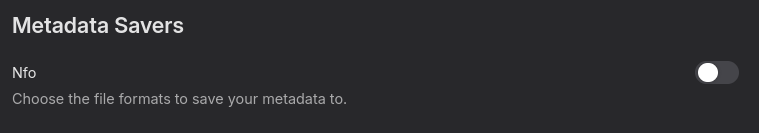

lordairivis 9 Posted July 17, 2025 Posted July 17, 2025 Not able to edit my last post for some reason so sorry for the double posting. My Movies library is set to have Nfo as the only Metadata reader, and no Metadata savers are enabled.

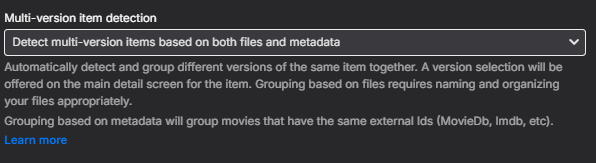

Happy2Play 9817 Posted July 18, 2025 Posted July 18, 2025 (edited) Not sure then as the nfo and ui are not showing the tag I can only guess a database issue. Have you verified the Access tab for the library? @lordairivis Is this reproducible in a different/new/test library with this content? Edited July 18, 2025 by Happy2Play
brothom 211 Posted July 18, 2025 Posted July 18, 2025 @lordairivisI'm having the exact same issues as @Happy2Play- none of the items will group at all in no way using your structure: I modified my Movies library to include: X:\Media\Movies X:\Media\Movies4K X:\Media\MoviesAlt and created the following files: X:\Media\Movies\Godzilla Minus One (2023)\Godzilla Minus One (2023) [Bluray-1080p] [EAC3].mkv X:\Media\Movies\Godzilla Minus One (2023)\Godzilla Minus One (2023) [Bluray-1080p] [EAC3].nfo X:\Media\Movies4K\Godzilla Minus One (2023)\Godzilla Minus One (2023) [Bluray-2160p] [TrueHD Atmos].mkv X:\Media\Movies4K\Godzilla Minus One (2023)\Godzilla Minus One (2023) [Bluray-2160p] [TrueHD Atmos].nfo X:\Media\MoviesAlt\Godzilla Minus One (2023)\Godzilla Minus One (2023) [Minus Color] [Bluray-1080p] [EAC3].mkv X:\Media\MoviesAlt\Godzilla Minus One (2023)\Godzilla Minus One (2023) [Minus Color] [Bluray-1080p] [EAC3].nfo This will just cause three different entries to be created because the (probably because the filesname are wildly different). Below is the homescreen latest Movies: This is a blank installation with only a handful of entries and NFO metadata readers enabled. Besides just creating the files, did you do anything else to get these to group? Did you manually edit something outside of the regular emby process?

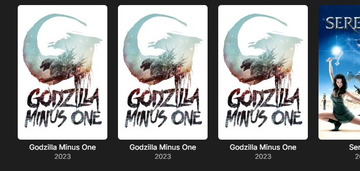

brothom 211 Posted July 18, 2025 Posted July 18, 2025 @lordairivisjust to be clear; the user that can't see all items when grouped and in parental mode; can this user see all three separate media entries when they're not grouped? I actually try to let Emby handle all my grouping and logic so I'm really curious what happens if you don't group them, but give them the same names and let emby handle creating the versions. In my case this works flawlessly: \\X\Series\Foundation (2021)\Season 01\HD\Foundation (2021) - s01e01 - The Emperor's Peace - 1080p.mkv \\X\Series\Foundation (2021)\Season 01\UHD\Foundation (2021) - s01e01 - The Emperor's Peace - 4K.mkv These are grouped as the screen below automatically: This also works for movies: \\XI\Movies\The Lord Of The Rings The Return Of The King (2003)\UHD Extended\The Lord Of The Rings The Return Of The King (2003) - 4K Extended Edition.mkv \\XI\Movies\The Lord Of The Rings The Return Of The King (2003)\HD Theatrical\The Lord Of The Rings The Return Of The King (2003) - 1080p Theatrical Edition.mkv To my knowledge Emby takes the "first part" of the filename for identification "The Lord Of The Rings The Return Of The King (2003)" and the second part(s) " - 4K Extended Edition" and "- 1080p Theatrical Edition" which then become versions of the "first part". Can you try to see if that works, if manual grouping doesn't?
lordairivis 9 Posted July 18, 2025 Posted July 18, 2025 (edited) 26 minutes ago, brothom said: @lordairivisjust to be clear; the user that can't see all items when grouped and in parental mode; can this user see all three separate media entries when they're not grouped? I actually try to let Emby handle all my grouping and logic so I'm really curious what happens if you don't group them, but give them the same names and let emby handle creating the versions. In my case this works flawlessly: \\X\Series\Foundation (2021)\Season 01\HD\Foundation (2021) - s01e01 - The Emperor's Peace - 1080p.mkv \\X\Series\Foundation (2021)\Season 01\UHD\Foundation (2021) - s01e01 - The Emperor's Peace - 4K.mkv These are grouped as the screen below automatically: This also works for movies: \\XI\Movies\The Lord Of The Rings The Return Of The King (2003)\UHD Extended\The Lord Of The Rings The Return Of The King (2003) - 4K Extended Edition.mkv \\XI\Movies\The Lord Of The Rings The Return Of The King (2003)\HD Theatrical\The Lord Of The Rings The Return Of The King (2003) - 1080p Theatrical Edition.mkv To my knowledge Emby takes the "first part" of the filename for identification "The Lord Of The Rings The Return Of The King (2003)" and the second part(s) " - 4K Extended Edition" and "- 1080p Theatrical Edition" which then become versions of the "first part". Can you try to see if that works, if manual grouping doesn't? Yes, with or without the parental control filtering in place, both my personal user and the test user I created are able to see each of the 3 versions of the movie as long as they are not grouped. I've tried all varieties of naming the files and they don't automatically group because (I assume) the files are in different folders on the network share, due to limitations of other software not related to Emby. As another test I created a new movies library with a copy of each version of the movie in a single folder and named them like this: /TestLibrary/Godzilla Minus One (2023)/Godzilla Minus One (2023) - HD.mkv /TestLibrary/Godzilla Minus One (2023)/Godzilla Minus One (2023) - UHD.mkv /TestLibrary/Godzilla Minus One (2023)/Godzilla Minus One (2023) - Minus Color.mkv I removed the existing .nfo files and enabled metadata saving for the test library and had Emby generate the appropriate nfo files, which it did successfully for each version of the movie in the folder. With parental control filtering enabled, the items did automatically group but I can still only select between 2 of the 3 versions. If I disable the parental control filtering and change nothing else, I am able to select between all 3 different versions. I attached the nfo files that Emby generated here, and they appear to be identical except for obviously the file information. This genuinely appears to be related to the parental control filtering. Godzilla Minus One (2023) - HD.nfo Godzilla Minus One (2023) - Minus Color.nfo Godzilla Minus One (2023) - UHD.nfo Edited July 18, 2025 by lordairivis

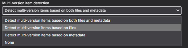

Happy2Play 9817 Posted July 18, 2025 Posted July 18, 2025 4 minutes ago, lordairivis said: I've tried all varieties of naming the files and they don't automatically group because (I assume) the files are in different folders Correct but will change in 4.9 as you have options to group per library But I am out of ideas as I cannot reproduce the issues in 4.8 or 4.9 even using your nfo files. As no media shows up with your nfo files as they do not contain the blocking "Tag". And all show up when removing the "Tag" restriction.
lordairivis 9 Posted July 18, 2025 Posted July 18, 2025 13 minutes ago, Happy2Play said: Correct but will change in 4.9 as you have options to group per library But I am out of ideas as I cannot reproduce the issues in 4.8 or 4.9 even using your nfo files. As no media shows up with your nfo files as they do not contain the blocking "Tag". And all show up when removing the "Tag" restriction. Just to be clear, since your post was not exactly clear to me: this isn't an issue with the items grouping or not grouping, or the items appearing or not appearing in the library when ungrouped. The items are all visible in the library when ungrouped and are being successfully grouped regardless of whether it's done manually or automatically by Emby. It's an issue with the visibility of the items in the group based on whether or not the parental controls are enabled, despite none of the items in the group being tagged in a way that should be affected by the parental controls. I appreciate everyone's help and input in trying to figure out what's going on here, but to me this looks like a bug in the software. Maybe I've hit some weird edge case that I'm not able to identify.
brothom 211 Posted July 18, 2025 Posted July 18, 2025 1 hour ago, lordairivis said: ... I appreciate everyone's help and input in trying to figure out what's going on here, but to me this looks like a bug in the software. Maybe I've hit some weird edge case that I'm not able to identify. As a programmer I can safely say that anything that looks like a bug, always has a logical explanation lol. The thing is that we can't reproduce this issue on new installs so it has to do with something in the database. Wiping these items would be a good start. I don't know if you have an extra PC or laptop on which you can try to reproduce this bug yourself? That'll help us a lot too since we can't reproduce it and you're currently the only one that can. 1
