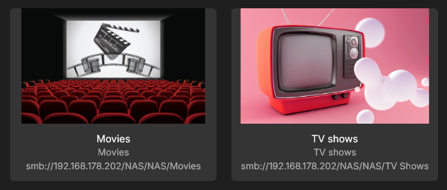

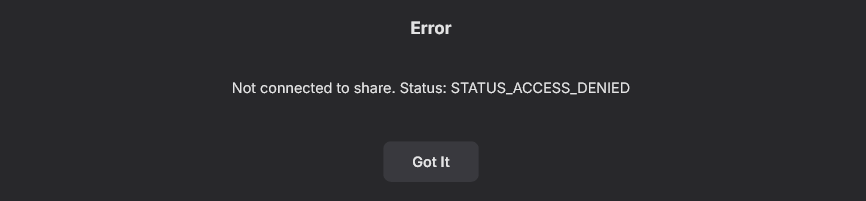

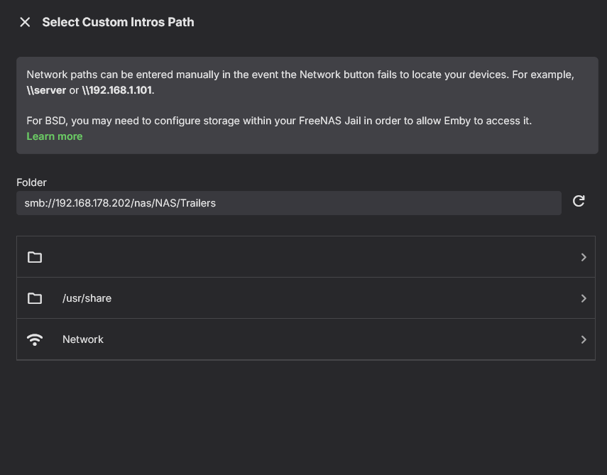

exilis 0 Posted July 31, 2024 Posted July 31, 2024 Really hoping I'm posting this in the right place... I'm running EMBY via a jail on TrueNAS CORE, and I'm trying to get a custom intro for my server via the Cinema Intros plugin, which I have already put in place on the NAS drive where the EMBY Server is referencing for all content. But when I attempt to point to where the trailer file(s) via smb, EMBY doesn't prompt for a username or password. I have been able to enter the username and password for my NAS when attempting to link up the libraries for both Movies and TV Shows in the past, and have been able to watch content from these for a while. I recently purchased the lifetime Premier pass to I was hoping to add a little more flavour to the server with a custom intro for everything. I've attempted to enter the location as it is, and I get told "Not connected to share. Status: STATUS_ACCESS_DENIED", which I'm assuming is relating to it wanting the username and password to my NAS, which it's not asking for... I'm not sure if it's a bug with a recent update as the last time I attempted to connect to my local NAS it asked perfectly fine. I don't want to run the risk of disconnecting the current libraries in case it breaks the entire server. The NAS isn't showing up on the Network list either so that's not a great help, but I was able to get around this last time by putting in the SMB address for the Library. Now that's not wanting to work. I did attempt to copy one of the trailers directly into the "/usr/share" directory but that's locked down (and for good reason I imagine so I won't be tinkering with those permissions). Any ideas?

Luke 42150 Posted July 31, 2024 Posted July 31, 2024 HI, yes it's going to take a bit of work to get this applied to all directory pickers. The best thing you can do is instead mount the share to a local path on the NAS and then use the local path in Emby Server.

Luke 42150 Posted August 1, 2024 Posted August 1, 2024 Quote \\192.168.178.202\NAS\Trailers smb:\\192.168.178.202\NAS\Trailers As we previously established, I wouldn't use unc paths or smb paths because there is currently no way to configure the authentication in emby server.
Luke 42150 Posted August 1, 2024 Posted August 1, 2024 Quote /mnt/NAS/TV Shows/Trailers /NAS/TV Shows/Trailers /TV Shows/Trailers /mnt/NAS Maybe a good way to figure out what the correct path is would be to open up the contents of /mnt/NAS in a file browser, and then locate the intros folder underneath there. That should tell you what the full path to use in emby server is.

Luke 42150 Posted September 14, 2024 Posted September 14, 2024 On 8/14/2024 at 2:54 PM, exilis said: Hi Luke, nope still no resolution. Still not sure why the Emby settings don't prompt for SMB credentials It's because this dialog hasn't yet added support for saving credentials. It will get there, but in the meantime you could avoid having to enter those credentials in Emby if you were to mount the folder to a local path in the OS, and then use the local path in Emby Server.
