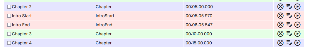

rbjtech 5344 Posted July 31, 2024 Posted July 31, 2024 (edited) As Emby have not implemented a way to view/edit the Intro markers () then may I suggest you install a 3rd party plugin called 'Chapter API'. It's in the Emby plugin catalogue. This will allow you to view (and edit if necessary) the detection markers. Note, on the Intro button and/or auto into skip - after it has run once per episode - it will not run a second time until you close that episode and re-open it. This is so you can go back and watch something that was possibly incorrectly 'skipped'. Edited July 31, 2024 by rbjtech

ThomasPdt 4 Posted July 31, 2024 Author Posted July 31, 2024 50 minutes ago, rbjtech said: As Emby have not implemented a way to view/edit the Intro markers () then may I suggest you install a 3rd party plugin called 'Chapter API'. It's in the Emby plugin catalogue. This will allow you to view (and edit if necessary) the detection markers. Note, on the Intro button and/or auto into skip - after it has run once per episode - it will not run a second time until you close that episode and re-open it. This is so you can go back and watch something that was possibly incorrectly 'skipped'. It's not true that Emby has not implemented a way to view the Intro markers. In the Emby for Android TV app, I can see the Intro chapters. But I can't see them in the Emby for Android TV and Emby for LG apps, that's true. I have Chapters API installed already. And there also I can see all my episodes have Intro Start and Intro End chapters (although they are highlighted in red, not sure if this means anything?). How can I test what you're saying about the running only once per episode? I turned off the TV since this morning, when I came back home tonight, it still didn't work. How do I close an episode to test if it really works?
rbjtech 5344 Posted July 31, 2024 Posted July 31, 2024 35 minutes ago, ThomasPdt said: It's not true that Emby has not implemented a way to view the Intro markers. In the Emby for Android TV app, I can see the Intro chapters. But I can't see them in the Emby for Android TV and Emby for LG apps, that's true. Sure - the AndroidTV and I believe the Roku App gives you the option to display them - it's very basic and simply inserts them regardless of the existing chapters. Unless they have changed it - showing intro start and intro end is just ugly. 41 minutes ago, ThomasPdt said: How can I test what you're saying about the running only once per episode? I turned off the TV since this morning, when I came back home tonight, it still didn't work. How do I close an episode to test if it really works? a) I presume you have premier - this does not work on the free tier. b) Red is fine - it's just highlighting the 'hidden' chapters. c) have you set the client to 'button or skip' on intro ? When you play this episode - Once it gets to 5:06 - it should either present a button or skip to 6:05 If you miss it - or scroll past 5:05 - then you simply need to back out and press play again. Once past 5:05/6:05 - you can't 'rewind' before this and expect the Intro button/skipintro to re-kick in again - that's what I'm saying. Just exit that episode and start again to check.
ThomasPdt 4 Posted August 1, 2024 Author Posted August 1, 2024 14 hours ago, rbjtech said: a) I presume you have premier - this does not work on the free tier. b) Red is fine - it's just highlighting the 'hidden' chapters. c) have you set the client to 'button or skip' on intro ? Like explained in my original post, I'm in trial mode. But trial mode is supposed to give me the same features as Premiere, isn't it? 14 hours ago, rbjtech said: c) have you set the client to 'button or skip' on intro ? Yes, I did, in all apps. 14 hours ago, rbjtech said: If you miss it - or scroll past 5:05 - then you simply need to back out and press play again. Once past 5:05/6:05 - you can't 'rewind' before this and expect the Intro button/skipintro to re-kick in again - that's what I'm saying. Just exit that episode and start again to check. I tried that, it doesn't work either.

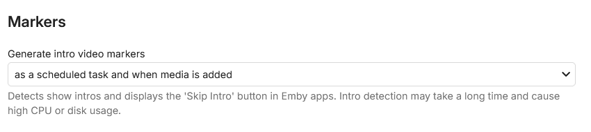

seanbuff 1356 Posted August 1, 2024 Posted August 1, 2024 48 minutes ago, ThomasPdt said: Like explained in my original post, I'm in trial mode. But trial mode is supposed to give me the same features as Premiere, isn't it? The two week trial is for the Android TV client app only. Intro Skipping is a Premiere feature of the Server, so the trial does not cover that. I think that may be the problem you're facing here, but I'll let one of the Devs comment further.
ThomasPdt 4 Posted August 1, 2024 Author Posted August 1, 2024 51 minutes ago, seanbuff said: The two week trial is for the Android TV client app only. Intro Skipping is a Premiere feature of the Server, so the trial does not cover that. I think that may be the problem you're facing here, but I'll let one of the Devs comment further. Ok, it would be nice to know indeed. But that doesn't explain why it worked a few times already. Or is it part of the trial, that it just shows it once or twice to show how it works? In my opinion, this should be part of the trial. How do they expect us to upgrade to Premiere if we cannot even fully test it?
Solution ebr 16337 Posted August 1, 2024 Solution Posted August 1, 2024 3 hours ago, seanbuff said: The two week trial is for the Android TV client app only. Intro Skipping is a Premiere feature of the Server, so the trial does not cover that. I think that may be the problem you're facing here, but I'll let one of the Devs comment further. Correct. The trial in the app is for playback only - not Premiere features. Emby Premiere Feature Matrix
