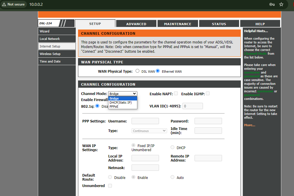

Bobwood 6 Posted August 3, 2024 Author Posted August 3, 2024 What settings must i change? SSID name and it was on bridge, so change to what?

Solution Lessaj 477 Posted August 4, 2024 Solution Posted August 4, 2024 4 hours ago, Bobwood said: What settings must i change? SSID name and it was on bridge, so change to what? At minimum you should change the SSID name so that all your devices are connected to the same point. How does the Unifi come into play exactly? Is it connected to the DLink and being powered with POE and used as an additional WAP? I'm not familiar with the DLink configuration options but while trying to look into it a little I came across a video for setting up a DLink as a wireless access point which is from a different model but the web configuration pages look the same so I think there is good information in this video which you may find helpful. In this example this would be expanding upon the current network, rather than acting as a separate one which is I think what the Bridge mode setting is doing. I'm not sure if this is what you want to be doing with connecting to your landlords network but if you were already connecting to it then extending the network shouldn't be an issue, you may want to confirm that. 1

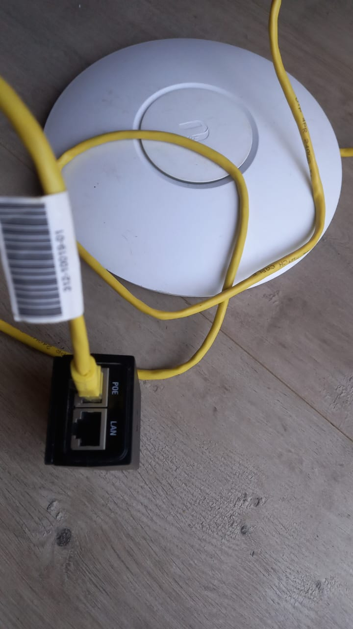

Bobwood 6 Posted August 4, 2024 Author Posted August 4, 2024 8 hours ago, Lessaj said: At minimum you should change the SSID name so that all your devices are connected to the same point. How does the Unifi come into play exactly? Is it connected to the DLink and being powered with POE and used as an additional WAP? I'm not familiar with the DLink configuration options but while trying to look into it a little I came across a video for setting up a DLink as a wireless access point which is from a different model but the web configuration pages look the same so I think there is good information in this video which you may find helpful. In this example this would be expanding upon the current network, rather than acting as a separate one which is I think what the Bridge mode setting is doing. I'm not sure if this is what you want to be doing with connecting to your landlords network but if you were already connecting to it then extending the network shouldn't be an issue, you may want to confirm that. The Unify was connected where the link now is, there were renovations so it was a temporary solution. Now I can't find the POE power cable. Thanks for the video, I will change SSID or setup like in video or alternatively get a power cable and setup the Unify as I think it will manage the network more intelligently. Thanks for your help 1 1
