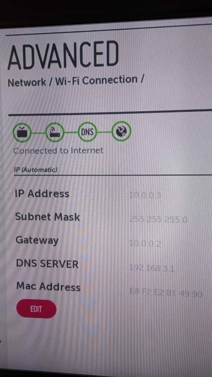

Bobwood 6 Posted July 30, 2024 Author Posted July 30, 2024 no i never restarted the system, will try it now. also have to sleep soon can we try later please, this my tv config does this look correct?
Happy2Play 9814 Posted July 30, 2024 Posted July 30, 2024 So everything is not on the same network. I will guess the two are not talking to each other but can only guess.
Bobwood 6 Posted July 30, 2024 Author Posted July 30, 2024 but they have to be its the only wifi connection and laptop and tv have internet connection, must be on same network? does the tv addresses look incorrect?
Happy2Play 9814 Posted July 30, 2024 Posted July 30, 2024 Your TV in on a 10.0.0.x network while Emby is on 192.168.3.x. So are these networks actually talking to each other as your must have two DHCP servers.

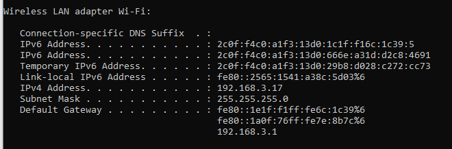

Bobwood 6 Posted July 31, 2024 Author Posted July 31, 2024 (edited) Im not a network guy and im confused as to how to fix this. cant even connect to my router web address, its a dlink should be 10.0.0.2, here is the ipconfig/all ``` Microsoft Windows [Version 10.0.19045.4651] (c) Microsoft Corporation. All rights reserved. C:\Windows\system32>ipconfig/all Windows IP Configuration Host Name . . . . . . . . . . . . : DESKTOP-LR74QM7 Primary Dns Suffix . . . . . . . : Node Type . . . . . . . . . . . . : Hybrid IP Routing Enabled. . . . . . . . : No WINS Proxy Enabled. . . . . . . . : No Ethernet adapter Ethernet: Media State . . . . . . . . . . . : Media disconnected Connection-specific DNS Suffix . : Description . . . . . . . . . . . : Realtek PCIe FE Family Controller Physical Address. . . . . . . . . : A0-2B-B8-59-A0-58 DHCP Enabled. . . . . . . . . . . : Yes Autoconfiguration Enabled . . . . : Yes Ethernet adapter Ethernet 2: Connection-specific DNS Suffix . : Description . . . . . . . . . . . : VirtualBox Host-Only Ethernet Adapter Physical Address. . . . . . . . . : 0A-00-27-00-00-03 DHCP Enabled. . . . . . . . . . . : No Autoconfiguration Enabled . . . . : Yes Link-local IPv6 Address . . . . . : fe80::fc53:1490:92bc:5987%3(Preferred) IPv4 Address. . . . . . . . . . . : 192.168.56.1(Preferred) Subnet Mask . . . . . . . . . . . : 255.255.255.0 Default Gateway . . . . . . . . . : DHCPv6 IAID . . . . . . . . . . . : 688521255 DHCPv6 Client DUID. . . . . . . . : 00-01-00-01-2B-98-C5-A3-A0-2B-B8-59-A0-58 DNS Servers . . . . . . . . . . . : fec0:0:0:ffff::1%1 fec0:0:0:ffff::2%1 fec0:0:0:ffff::3%1 NetBIOS over Tcpip. . . . . . . . : Enabled Wireless LAN adapter Local Area Connection* 9: Media State . . . . . . . . . . . : Media disconnected Connection-specific DNS Suffix . : Description . . . . . . . . . . . : Microsoft Wi-Fi Direct Virtual Adapter Physical Address. . . . . . . . . : 16-2D-27-CF-6C-1F DHCP Enabled. . . . . . . . . . . : Yes Autoconfiguration Enabled . . . . : Yes Wireless LAN adapter Local Area Connection* 10: Media State . . . . . . . . . . . : Media disconnected Connection-specific DNS Suffix . : Description . . . . . . . . . . . : Microsoft Wi-Fi Direct Virtual Adapter #2 Physical Address. . . . . . . . . : 16-2D-27-CF-64-1F DHCP Enabled. . . . . . . . . . . : No Autoconfiguration Enabled . . . . : Yes Wireless LAN adapter Wi-Fi: Connection-specific DNS Suffix . : Description . . . . . . . . . . . : Broadcom BCM43142 802.11 bgn Wi-Fi Adapter Physical Address. . . . . . . . . : 14-2D-27-CF-6C-1F DHCP Enabled. . . . . . . . . . . : Yes Autoconfiguration Enabled . . . . : Yes IPv6 Address. . . . . . . . . . . : 2c0f:f4c0:a1f3:13d0:1c1f:f16c:1c39:5(Preferred) Lease Obtained. . . . . . . . . . : Wednesday, 31 July 2024 09:07:36 Lease Expires . . . . . . . . . . : Wednesday, 31 July 2024 11:07:37 IPv6 Address. . . . . . . . . . . : 2c0f:f4c0:a1f3:13d0:666e:a31d:d2c8:4691(Preferred) Temporary IPv6 Address. . . . . . : 2c0f:f4c0:a1f3:13d0:e940:715c:a7c2:6d41(Preferred) Link-local IPv6 Address . . . . . : fe80::2565:1541:a38c:5d03%6(Preferred) IPv4 Address. . . . . . . . . . . : 192.168.3.89(Preferred) Subnet Mask . . . . . . . . . . . : 255.255.255.0 Lease Obtained. . . . . . . . . . : Wednesday, 31 July 2024 09:07:43 Lease Expires . . . . . . . . . . : Wednesday, 31 July 2024 10:07:42 Default Gateway . . . . . . . . . : fe80::1e1f:f1ff:fe6c:1c39%6 fe80::1a0f:76ff:fe7e:8b7c%6 192.168.3.1 DHCP Server . . . . . . . . . . . : 192.168.3.1 DHCPv6 IAID . . . . . . . . . . . : 605302055 DHCPv6 Client DUID. . . . . . . . : 00-01-00-01-2B-98-C5-A3-A0-2B-B8-59-A0-58 DNS Servers . . . . . . . . . . . : fe80::1e1f:f1ff:fe6c:1c39%6 192.168.3.1 NetBIOS over Tcpip. . . . . . . . : Enabled Ethernet adapter Bluetooth Network Connection: Media State . . . . . . . . . . . : Media disconnected Connection-specific DNS Suffix . : Description . . . . . . . . . . . : Bluetooth Device (Personal Area Network) Physical Address. . . . . . . . . : 14-2D-27-CF-6C-20 DHCP Enabled. . . . . . . . . . . : Yes Autoconfiguration Enabled . . . . : Yes C:\Windows\system32>``` Edited July 31, 2024 by Bobwood

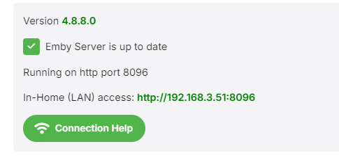

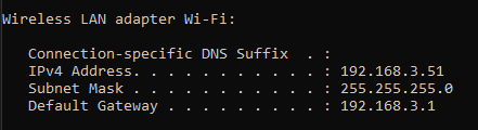

Lessaj 486 Posted August 1, 2024 Posted August 1, 2024 It seems that your devices are on different subnets, but that isn't necessarily an issue as long as the networks are routable to each other. Based on your posted ipconfig the server address has now changed to 192.168.3.89. The first thing you should do is set the server to have a static address. You can either do this on the device through the adapter properties, or you can try to access your default gateway 192.168.3.1 and look for a way to set a static address within the DHCP server settings which is what I would recommend doing. Once the server has a static address then you know that it at least won't change and you always know exactly what it is.

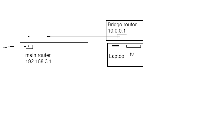

Bobwood 6 Posted August 2, 2024 Author Posted August 2, 2024 (edited) Excuse the drawing but it shows what i found out , i live in the flat in the right with tv and laptop, it seems my laptop is somehow connecting wirelessly or i don't know how to main router, I can connect with Emby on my mobile app if i walk over there, the tv is connected to the bridge router so that's why i cant watch Emby on my tv, it has worked before but i think it was when my laptop hooked up to bridge router, then they were on the same network. I cant understand how my laptop is connected to the main router(Huawei) with full signal when the bridge one (dlink) is right next door. and what steps i need to connect laptop to bridge? Edited August 2, 2024 by Bobwood

Lessaj 486 Posted August 3, 2024 Posted August 3, 2024 5 hours ago, Bobwood said: Excuse the drawing but it shows what i found out , i live in the flat in the right with tv and laptop, it seems my laptop is somehow connecting wirelessly or i don't know how to main router, I can connect with Emby on my mobile app if i walk over there, the tv is connected to the bridge router so that's why i cant watch Emby on my tv, it has worked before but i think it was when my laptop hooked up to bridge router, then they were on the same network. I cant understand how my laptop is connected to the main router(Huawei) with full signal when the bridge one (dlink) is right next door. and what steps i need to connect laptop to bridge? If you don't want it connecting to the main router you can forget the network or change it to not connect automatically, because unless you're connecting an ethernet cable you could only be connecting wirelessly to it. Your IP is different every single time you've provided the details about the device so it seems this main router is not holding the DHCP lease long enough, or you're disconnected from it long enough to get a new lease next time it connects, so you need to isolate the wireless connection to the access point you actually want to be connected to, and you'll want to get a static IP from that access point so the IP doesn't keep changing on the device. 1 1
