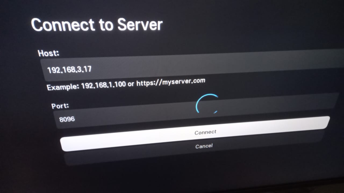

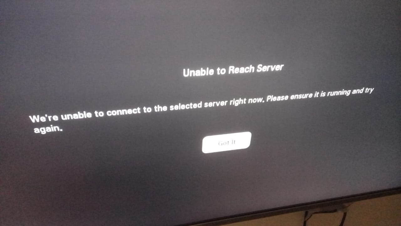

Bobwood 6 Posted July 30, 2024 Posted July 30, 2024 I have a Lg web os 2 smart tv and running an emby server on my windows 10 laptop, no vpn and firewall whitelisted, im bridging on a second wifi and the ip is dynamic, my lan connection is very hit and miss and i cant understand why. some evenings it works and the other evenings it just doesn't connect. "Unable to reach server" what steps can i take to fix this please.

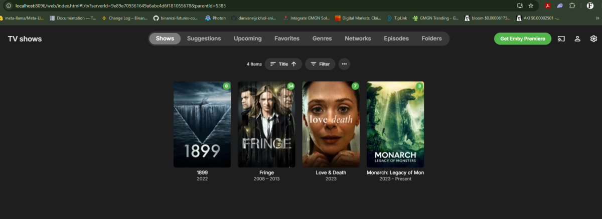

Bobwood 6 Posted July 30, 2024 Author Posted July 30, 2024 The Emby web interface is working, server is running on laptop, but when i try connect with my Emby app on my LG smart to it says "Unable to reach server"

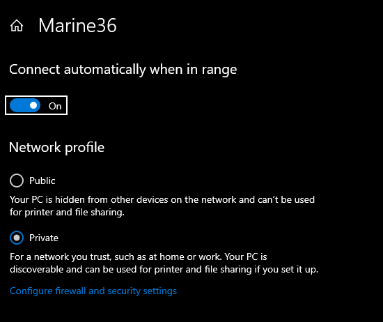

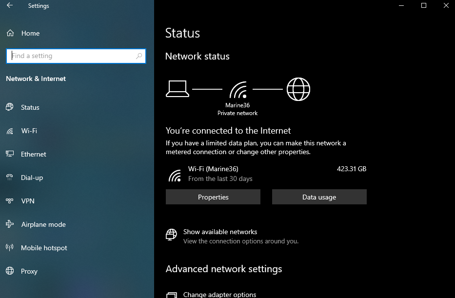

Happy2Play 9814 Posted July 30, 2024 Posted July 30, 2024 Since this is within your LAN can other devices connect to Emby as this sounds like a firewall issue. On the Windows 10 laptop what is the connection type Public or Private as the is a common issue affecting Firewall.
Bobwood 6 Posted July 30, 2024 Author Posted July 30, 2024 (edited) cant connect in the browser just says "web page not available" @Happy2Play cant connect with my mobile through mobile emby or mobile web, how do i change connection type and which one do i need to set it to? edit: i see it was on Public, i changed to Private now Edited July 30, 2024 by Bobwood
Happy2Play 9814 Posted July 30, 2024 Posted July 30, 2024 1 minute ago, Bobwood said: cant connect in the browser just says "web page not available" @Happy2Play cant connect with my mobile through mobile emby or mobile web, how do i change connection type and which one do i need to set it to? Open Network and Internet setting, what does it show for network type?
Bobwood 6 Posted July 30, 2024 Author Posted July 30, 2024 i just changed to private now, it was on public 2
Happy2Play 9814 Posted July 30, 2024 Posted July 30, 2024 Are you all set now? As this is a Windows default change especially in W11. If not we will need to look at your firewall rules for Emby.

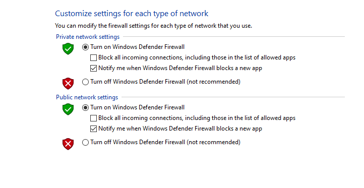

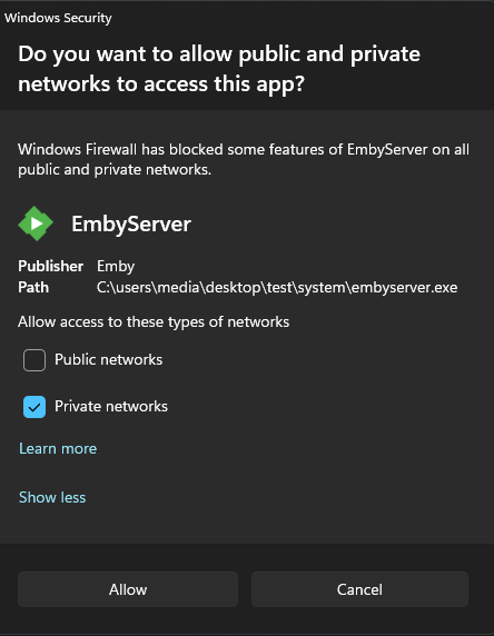

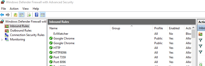

Happy2Play 9814 Posted July 30, 2024 Posted July 30, 2024 Okay let start over here. Please delete Emby firewall rules. Ensure notifications are enabled for firewall changes Shutdown Emby and go to C:\Users\USERNAME\AppData\Roaming\Emby-Server\programdata\config\system.xml Change <IsPortAuthorized>true</IsPortAuthorized> to <IsPortAuthorized>false</IsPortAuthorized> and save Start Emby and should see firewall pop-ups. 1
Bobwood 6 Posted July 30, 2024 Author Posted July 30, 2024 sorry how do i get to that first customize settings window?

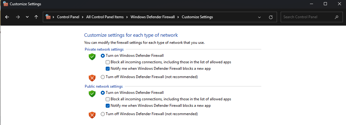

Happy2Play 9814 Posted July 30, 2024 Posted July 30, 2024 1 minute ago, Bobwood said: sorry how do i get to that first customize settings window? I just click Windows key and type Firewall, enter then click change Notifications settings.

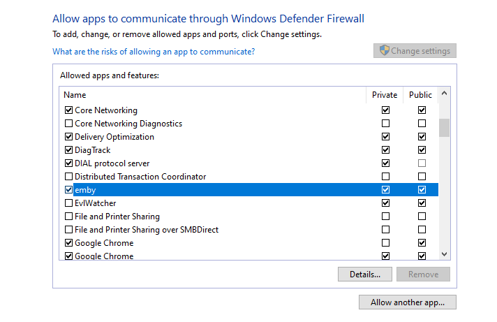

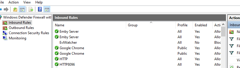

Bobwood 6 Posted July 30, 2024 Author Posted July 30, 2024 i think i did all but not getting that popup, don't think i removed from firewall properly
Bobwood 6 Posted July 30, 2024 Author Posted July 30, 2024 its just automatically adding emby back to firewall without popup

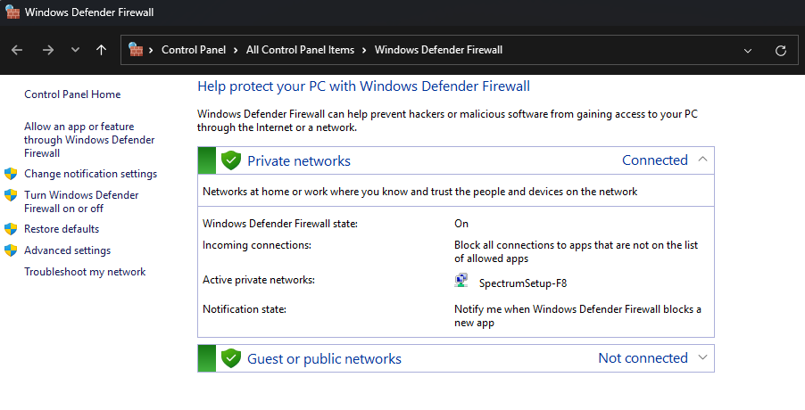

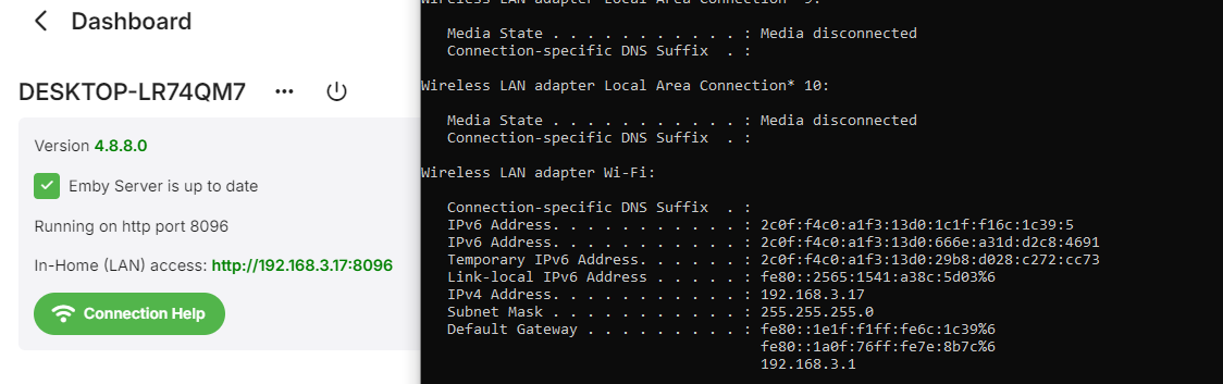

Happy2Play 9814 Posted July 30, 2024 Posted July 30, 2024 Looks correct but that is really all that will block LAN connections. Everything is on the same LAN network correct ie 192.168.3.x?
