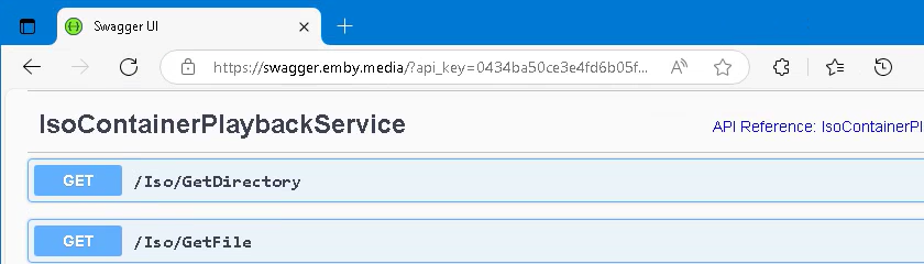

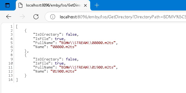

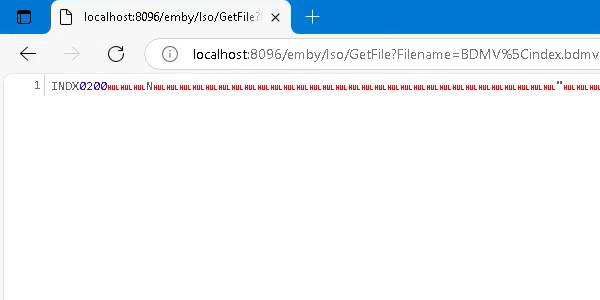

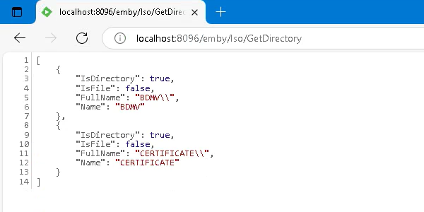

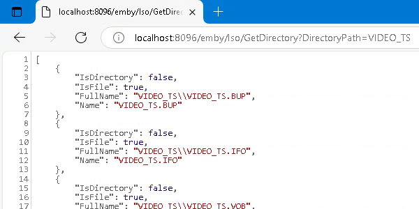

Peckmore 23 Posted October 12, 2024 Author Posted October 12, 2024 (edited) 8 hours ago, Luke said: OK that was quick and you’ve verified that these both work by testing in the browser? Hi Luke, My apologies, I'd made a small mistake and placed the [Unauthenticated] attribute in the wrong place, but I've fixed this now, and also tweaked a couple of other bits (including merging the services into a single service). With an ISO in the expected hard-coded location, the API is accessible from within a browser, as shown in the screenshots below. At the moment, the GetFile method on the service just returns the Stream object directly, which (I believe) results in it being written to the response stream. Is this sufficient, or is there anything else required when returning a Stream object? I'm not making use of ResultFactory at the moment as I wasn't sure whether that would be needed? Cheers! Edited October 12, 2024 by Peckmore 1

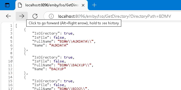

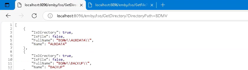

Luke 42243 Posted October 12, 2024 Posted October 12, 2024 And is it able to get the contents of a subfolder, such as bdmv/backup?
Peckmore 23 Posted October 13, 2024 Author Posted October 13, 2024 9 hours ago, Luke said: And is it able to get the contents of a subfolder, such as bdmv/backup? Yep, no problem! BluRay / /BDMV /BDMV/STREAM /BDMV/index.bdmv DVD / /VIDEO_TS /VIDEO_TS/VIDEO_TS.IFO 2
