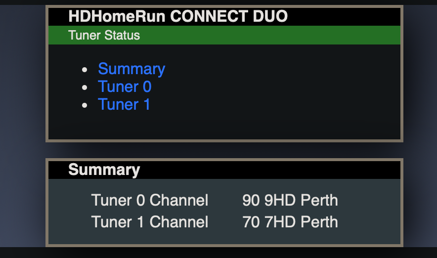

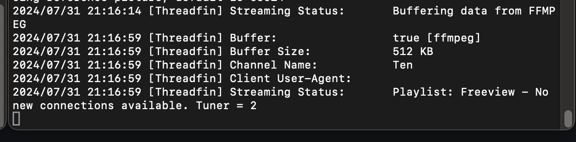

tree2369 16 Posted July 31, 2024 Author Posted July 31, 2024 On 30/07/2024 at 18:54, sa2000 said: Hi Trying to find out from the devs what has been received The testflight data would hopefully help with the ios app crash. Are there repro steps for the crashes? I do not expect the Testflight diagnostics to help with the second issue - of the emby server ending up with the locked tuner. I do not know what timeouts there are in Emby Server for tuner live tv sessions but emby server debug logs coinciding with the time of the emby ios app crash would help - I think there would also need to be logs captured say 20 minutes later to see if there were any timeouts. There would also be ffmpeg logs together with the embyserver logs Logs can be downloaded - cleaned of tokens / api keys using the emby web server settings logs interface. But please do enable debug logging beforehand and restart the server before reproducing the problem so that there would be complete set of debug logs. Okay. So the sequence of events for these logs and pictures are: 1. Load ch9 (90) on iOS Emby app, change quality twice to produce a crash 2. Load ch7 (70) on iOS Emby app, change quality twice to produce the same crash. 3. View HDHR tuner Status web page - both tuners still in use. 4. Try to load ch10 on iOS Emby app, loads the buffer 'stream limit' image from thread fin. 5. Check threadfin(xteve) logs that I run my HDHR through (to bwdif=1 deinterlace), says the tuner limit was reached on the last channel tune attempt. In the 5 or so minutes since finishing those steps and writing this, the tuners are still listed as in use according to the HDHR tuner status webpage, but are not where to be seen on the Emby dashboard. embyserver-2.txt 1 1
sa2000 697 Posted August 1, 2024 Posted August 1, 2024 Thanks @tree2369for the detail and the debug log covering the whole sequence. I have referred this to the development team. i do see the ffmpeg session being terminated so this is not a stuck transcoder process issue.
