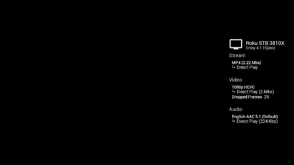

speechles 2062 Posted July 30, 2024 Posted July 30, 2024 (edited) 16 hours ago, Blam84 said: Video is direct playing (2mbs). When the "stats for nerds" is enabled the Roku will report dropped frames and stream errors. Usually these are caused by environmental factors, such as poor WiFi signal at that time, or someone literally standing in the way of the signal or something. If they always happen consistently in the same spot is has something to do with how they are encoded. How many audio streams, subtitles, etc are within the file? The MP4 file format doesn't support as many as the MKV file format does. It is hard to pinpoint one reason without seeing the file and looking for issues inside it. Can you post one of your problem files somewhere so we can find the root cause and reproduce the issue? 16 hours ago, Blam84 said: Video is direct playing (2mbs). Same as what I am playing above at 2mbs. What resolution is your file playing as? Edited July 30, 2024 by speechles
user84 48 Posted July 30, 2024 Author Posted July 30, 2024 8 minutes ago, speechles said: When the "stats for nerds" is enabled the Roku will report dropped frames and stream errors. Usually these are caused by environmental factors, such as poor WiFi signal at that time, or someone literally standing in the way of the signal or something. If they always happen consistently in the same spot is has something to do with how they are encoded. How many audio streams, subtitles, etc are within the file? The MP4 file format doesn't support as many as the MKV file format does. It is hard to pinpoint one reason without seeing the file and looking for issues inside it. Can you post one of your problem files somewhere so we can find the root cause and reproduce the issue? Are you asking for an example MP4? If so, let me know the most appropriate way to share that.

speechles 2062 Posted July 30, 2024 Posted July 30, 2024 (edited) @Blam84Thank you for the sample. I see exactly what you mean on my Roku 4K streaming stick 3810X. The stutter isn't caused by the frame drop or stream errors. It is just straight up playing it incorrectly. Update: It is the tags/metadata embedded in the MP4. According to Roku tags/metadata are not allowed in MP4. Directly muxing this into an MKV solved the stuttering. There is no need to remove the tags when this is inside an MKV. https://en.wikipedia.org/wiki/Roku#Feature_comparison Edited July 30, 2024 by speechles 1

user84 48 Posted July 31, 2024 Author Posted July 31, 2024 1 hour ago, speechles said: @Blam84Thank you for the sample. I see exactly what you mean on my Roku 4K streaming stick 3810X. The stutter isn't caused by the frame drop or stream errors. It is just straight up playing it incorrectly. Update: It is the tags/metadata embedded in the MP4. According to Roku tags/metadata are not allowed in MP4. Directly muxing this into an MKV solved the stuttering. There is no need to remove the tags when this is inside an MKV. https://en.wikipedia.org/wiki/Roku#Feature_comparison Great! Thanks so much for the feedback. Two questions: 1. If I play this on Plex, would I get the same issue? If not, why not? 2. Is the only solution to remux this into MKV or find a new file?
Solution speechles 2062 Posted July 31, 2024 Solution Posted July 31, 2024 (edited) 10 minutes ago, Blam84 said: Great! Thanks so much for the feedback. Two questions: 1. If I play this on Plex, would I get the same issue? If not, why not? 2. Is the only solution to remux this into MKV or find a new file? 1. Yes. The same Roku having the problem with Emby would have the same problem with Roku Media Player, Plex or JellyFin. https://exiftool.org/forum/index.php?topic=11977.msg64661#msg64661 The older Roku was more lenient about the specification. You could even play 10bit color h264 directly and get horrible colors but it direct played. Since firmware 11.5 they have added new methods to read capabilities and have deprecated the older methods. It makes it easier to detect what a Roku will play, but the Roku is now much more strict on newer hardware about what it will play and will now actively refuse to play some material that could be direct played before. It would be better if it were in an MKV since any version of Roku could then play it. Or you would have to see if you could strip the tags without having to reencode the entire MP4 which should be possible. I just am not that familiar with removing tags from MP4 since I always convert them to MKV when it isn't DolbyVision. Edited July 31, 2024 by speechles 1
