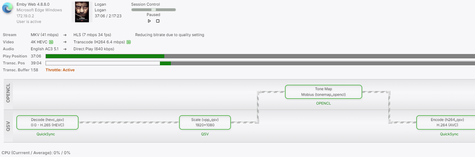

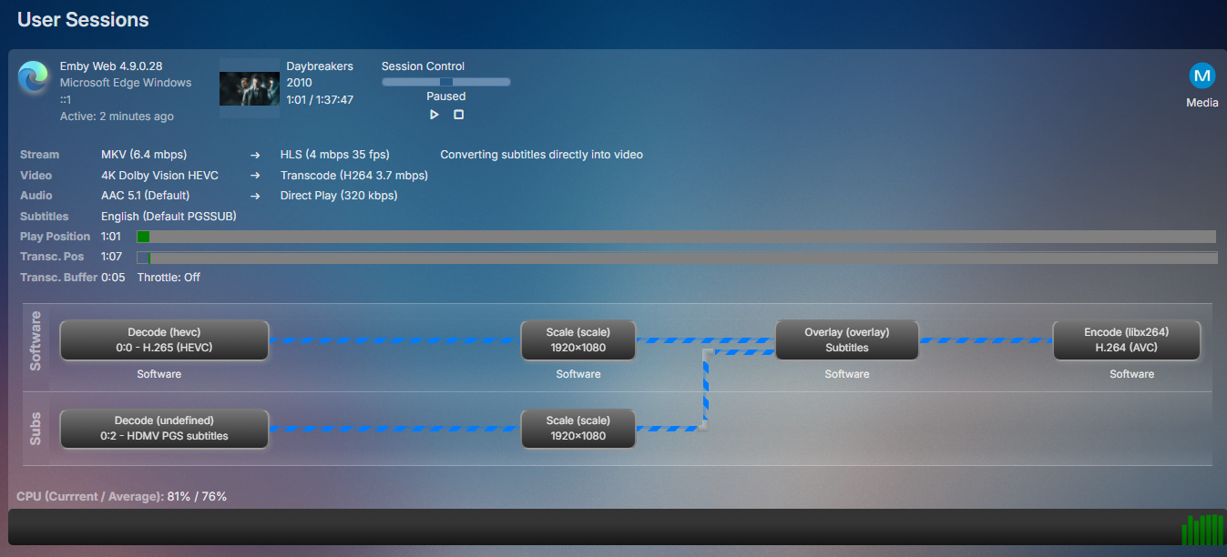

Happy2Play 9812 Posted July 27, 2024 Posted July 27, 2024 So far under 4 minutes gets killed after 60 seconds. Will look at the back side now to see it the same applies. As mentioned only testing Edge browser.
Happy2Play 9812 Posted July 27, 2024 Posted July 27, 2024 Will stop here but with 10 minutes left and pause session is killed after 60 seconds. So the Playback Resume variables are pretty close. Front side under 4 minutes and back side with 10 minutes to the end as paused session gets killed after 60 seconds in my testing via Edge browser on beta 4.9.0.28.

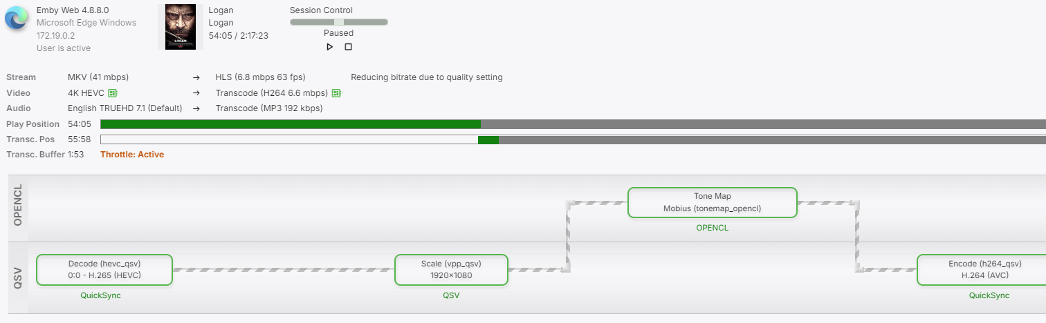

Jcheinaman 19 Posted July 27, 2024 Author Posted July 27, 2024 (edited) 36 minutes ago, Happy2Play said: Pause at 5 minutes via browser. Still held at 4:02 minutes. I avoided my Unraid server and tested directly on the bare windows installation and played on the same local host machine. Here are two examples, one around 5 minutes and one around 30 minutes. Both drop after 60 seconds. I had to record from my phone and I installed none of the plugins so I don’t have access to user sessions, but I recorded the dashboard and it should achieve the same result. I apologize. I had to record my monitor using my phone. I shared the videos via iCloud links. They were too large to upload here. https://share.icloud.com/photos/0adK59KFyI7_9K7HSJLYk1Oqw https://share.icloud.com/photos/0demHyDukxUveDkbPuCjxVNMg Edited July 27, 2024 by Jcheinaman
Happy2Play 9812 Posted July 27, 2024 Posted July 27, 2024 6 minutes ago, Jcheinaman said: I avoided my Unraid server and tested directly on the bare windows installation and played on the same local host machine. Here are two examples, one around 5 minutes and one around 30 minutes. Both drop after 60 seconds. I had to record from my phone and I installed none of the plugins so I don’t have access to user sessions, but I recorded the dashboard and it should achieve the same result. I apologize. I had to record my monitor screen using my phone. I shared the videos via iCloud links. They were too large to upload here. https://share.icloud.com/photos/0adK59KFyI7_9K7HSJLYk1Oqw https://share.icloud.com/photos/0demHyDukxUveDkbPuCjxVNMg Neither open but can only guess there is a client variable also then.
Jcheinaman 19 Posted July 27, 2024 Author Posted July 27, 2024 (edited) 9 minutes ago, Happy2Play said: Neither open but can only guess there is a client variable also then. I apologize. I had a power outage overnight and had my opnsense router take a dump on me so I'm currently connected on my cellular hotspot. I assure you it stopped at exactly 60 seconds again. I wanted to use the brand new windows emby install without any settings or other modifications to rule out the other machine. I don't know if this would matter or not, but my entire library is HEVC. I don't see how that would affect emby dropping the session, but it is worth a mention. It's always been HEVC, even prior to this issue. Edited July 27, 2024 by Jcheinaman
Happy2Play 9812 Posted July 27, 2024 Posted July 27, 2024 2 minutes ago, Jcheinaman said: I don't know if this would matter or not, but my entire library is HEVC. I don't see how that would affect emby dropping the session, but it is worth a mention. I will test on a HEVC file but don't see codecs really making a difference here. 3 minutes ago, Jcheinaman said: I wanted to use the brand new windows emby install without any settings or other modifications to rule out the other machine. I have multiple portables on my test system for beta and release testing just a matter of changing ports after install. Emby Server for Windows If you want the beta you have to get from GitHub Releases · MediaBrowser/Emby.Releases (github.com)
