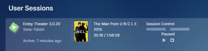

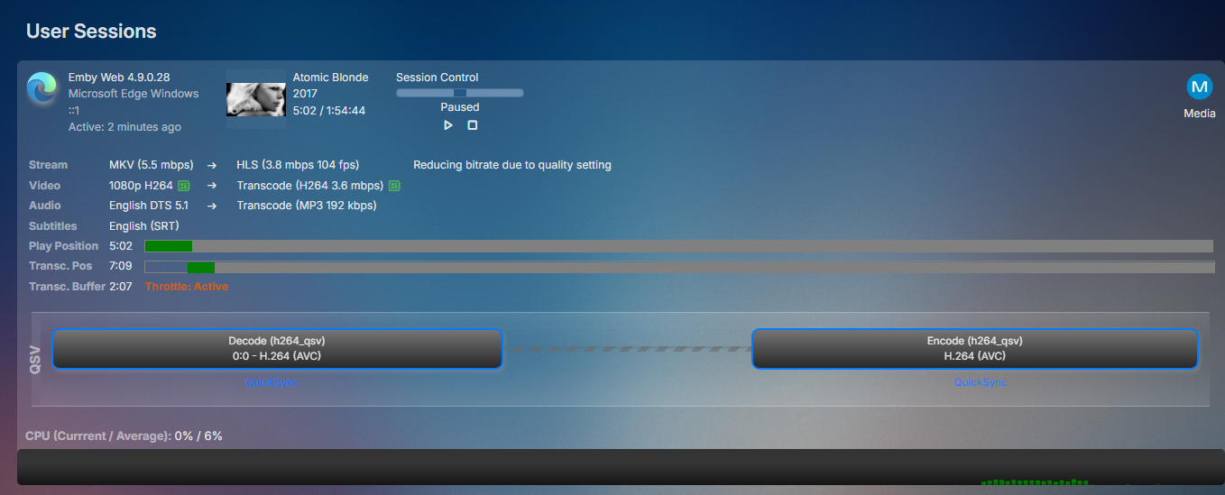

Happy2Play 9812 Posted July 27, 2024 Posted July 27, 2024 @Q-DroidLuke already confirmed it is normal behavior, but really surprised it has not been reported before now unless it is new. There has to be variables here as I showed above in ET. But for it causing issue yes that would have to be troubleshot further as yes it will create playback issues as the session has to be restarted when unpaused the transcode has to be redone. But further testing appears to be playback position related but have no idea of the threshold of killing the session as was only know so far pausing at the beginning under a minute will kill the session per tests and videos provided. 1

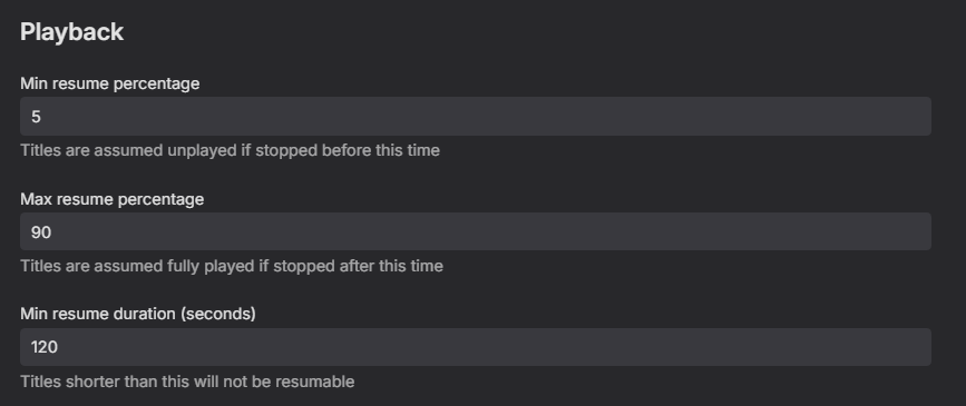

Happy2Play 9812 Posted July 27, 2024 Posted July 27, 2024 Best guess here would be Playback Resume variables.
Q-Droid 1011 Posted July 27, 2024 Posted July 27, 2024 13 minutes ago, Happy2Play said: Best guess here would be Playback Resume variables. But those apply to stop/start (leaving) , right? Not for pausing?
Happy2Play 9812 Posted July 27, 2024 Posted July 27, 2024 1 minute ago, Q-Droid said: But those apply to stop/start (leaving) , right? Not for pausing? Potentially yes but there has to be a variable that kills a paused session at a specific playback position. Guess the only way to know would be pausing every minute to see when it no longer kills the session after 60 seconds of being paused.

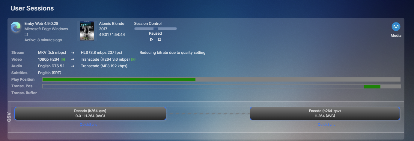

Happy2Play 9812 Posted July 27, 2024 Posted July 27, 2024 3 minutes ago, Jcheinaman said: The only variable I can connect is that Emby drops the user session of transcoded streams after 60 seconds of idle time. And can you test say pausing in the middle of the media as I have shown works in ET and Browser? To me there is a playback position variable. As I showed it being killed at 60 in my first image ie paused after a few seconds of playback but my last image show playback at 49 minutes maintained the pause for over 7 minutes.

Happy2Play 9812 Posted July 27, 2024 Posted July 27, 2024 (edited) Pause at 5 minutes via browser. Still held at 4:02 minutes. But pause at 4:00 minutes session was killed after 60 seconds. Only testing via Edge browser. Edited July 27, 2024 by Happy2Play update testing
