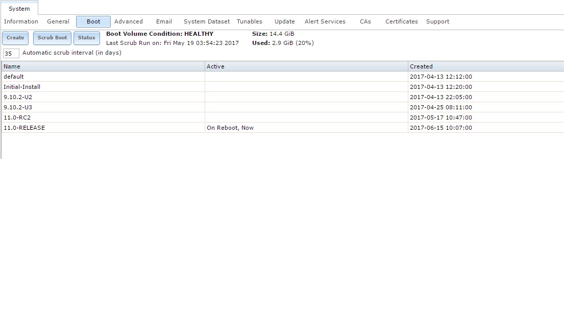

eraser8 55 Posted June 15, 2017 Posted June 15, 2017 (edited) Oh, did I forget to mention that I ran on FN11-RC2 since 4 weeks ago with absolutely no problem? Moreover, I just update it with the up-to-date FN11-RELEASE version without any problems. All working great! Edited June 15, 2017 by eraser8
Eddie 12 Posted June 15, 2017 Posted June 15, 2017 Was it a fresh install or an update from fn 9.10 it's been a while ago but I know there was a problem maybe it was with upgrading
eraser8 55 Posted June 15, 2017 Posted June 15, 2017 Was it a fresh install or an update from fn 9.10 it's been a while ago but I know there was a problem maybe it was with upgrading Update from 9.10 Here is my boot options
