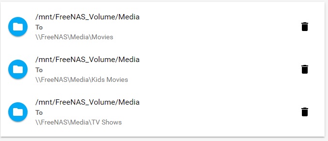

SavageAUS 0 Posted July 22, 2016 Posted July 22, 2016 I have been studying this thread for quite some time now and have finally decided to post and as for some help in getting my path substitution to work correctly. My current setup is a FreeNAS box with Emby installed and storage mounted in the Emby_1 jail like so: Source /mnt/FreeNAS_Volume/Media Destination /media The "receiver" device is a raspberry pi with LibreElec with the Emby Addon. I have performed the initial sync and all can be viewed but i am unable to play any media. The GUI asks to remove the file from the library. Any suggestions on path substitutions would be appreciated.
Luke 42239 Posted July 22, 2016 Author Posted July 22, 2016 I have been studying this thread for quite some time now and have finally decided to post and as for some help in getting my path substitution to work correctly. My current setup is a FreeNAS box with Emby installed and storage mounted in the Emby_1 jail like so: Source /mnt/FreeNAS_Volume/Media Destination /media The "receiver" device is a raspberry pi with LibreElec with the Emby Addon. I have performed the initial sync and all can be viewed but i am unable to play any media. The GUI asks to remove the file from the library. Any suggestions on path substitutions would be appreciated. Check the media info of the video in the web interface, that is the path that the Emby for Kodi add-on will attempt to use. If that path is not correct then you need to revise your path substitution. Once it's correct, if you're still having an issue, then I would create a topic in the kodi section of the forum.
SavageAUS 0 Posted July 22, 2016 Posted July 22, 2016 After setting my path subs like attached my movies are playing once more. When i go into movie info inside kodi the path is plugin://plugin.video.emby.movies/?dbid etc... is this normal? Have i done it correctly? Even though its working its not showing the direct path to the movies etc its going to a plugin path?
Luke 42239 Posted July 22, 2016 Author Posted July 22, 2016 After setting my path subs like attached my movies are playing once more. When i go into movie info inside kodi the path is plugin://plugin.video.emby.movies/?dbid etc... is this normal? Have i done it correctly? Even though its working its not showing the direct path to the movies etc its going to a plugin path? I'm not the best person to answer questions that are specific to the Emby for Kodi add-on. Please try the test I mentioned in post #523. Check the media info of the video in the web interface, that is the path that the Emby for Kodi add-on will attempt to use. If that path is not correct then you need to revise your path substitution. Then, once you've ensured the paths are correct, if you're still having an issue, please open a topic in the Emby for Kodi section: http://emby.media/community/index.php?/forum/99-kodi/ Thanks!
