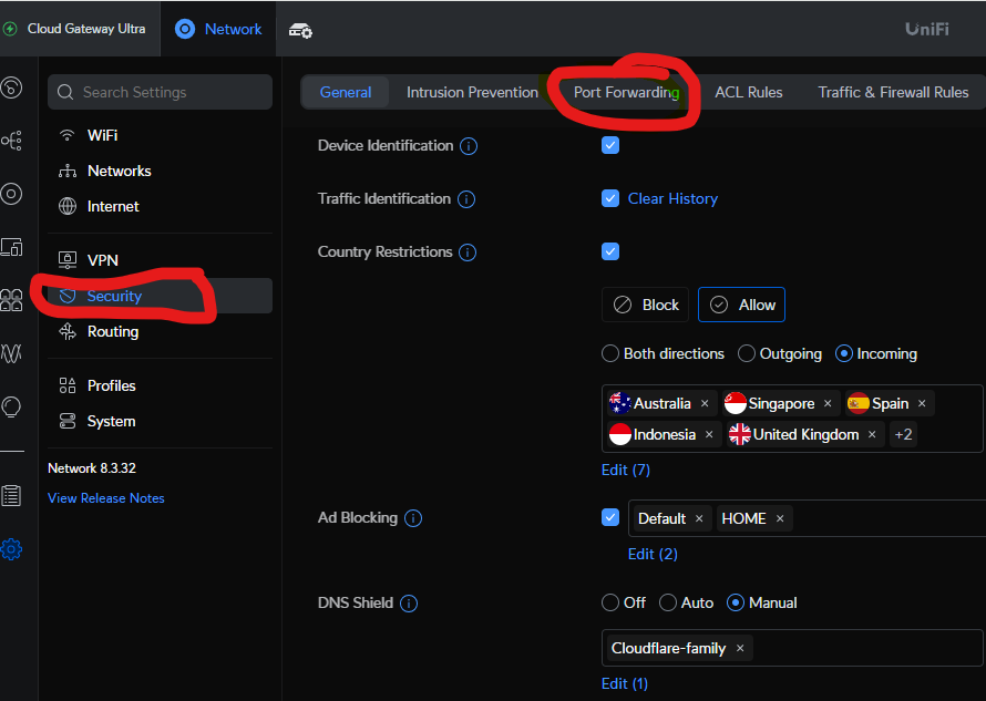

vaise 340 Posted July 25, 2024 Posted July 25, 2024 Dunno if it helps, but on my unifi cloud gateway ultra, its here :
AP123 13 Posted July 26, 2024 Author Posted July 26, 2024 1 hour ago, vaise said: Dunno if it helps, but on my unifi cloud gateway ultra, its here : Spoiler So i found my way there but now stupidly when I try to make the rule I get stuck on what my ipv4 is. As you can tell, this isnt my strong suit.

AP123 13 Posted July 26, 2024 Author Posted July 26, 2024 1 hour ago, vaise said: Dunno if it helps, but on my unifi cloud gateway ultra, its here : Unfortunately didn’t work for me. I created the rule and my emby still can’t be accessed remotely.
