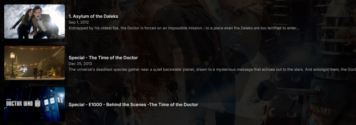

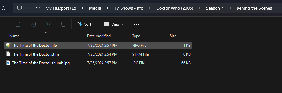

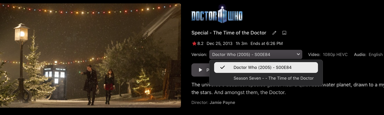

Bigmack3000 108 Posted July 25, 2024 Author Posted July 25, 2024 More logs attached. Ok I made a generic "behind the scenes" folder for season 7, instead of doing one for each individual episode. It says this is possible in the wiki. It looks like it will work, in that it now plays the episode. However, it still gets thrown into the pull down bar as another version of the episode. Also, now it won't play the backdrop video. Saying "compatibility error" embyserver (1).txt
Happy2Play 9814 Posted July 25, 2024 Posted July 25, 2024 (edited) At least it applied to the correct same named special, but I believe will come back to metadata provider incorrect identification. As technically this additions cannot be provider searched. Will test some more but suspect naming scheme will be an issue also. Edited July 25, 2024 by Happy2Play

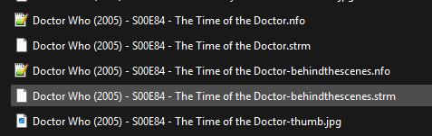

Happy2Play 9814 Posted July 25, 2024 Posted July 25, 2024 (edited) Guess I will have to test your naming scheme now. Might be from not have S00E84 also. Edited July 25, 2024 by Happy2Play
Happy2Play 9814 Posted July 25, 2024 Posted July 25, 2024 (edited) 19 minutes ago, Happy2Play said: Guess I will have to test your naming scheme now. Might be from not have S00E84 also. Yep that was it as all specials/extras no matter their location fall under lookup of Season 0/Specials and get merged per their metadata misidentification but technically the episode already exists by name. Changing naming scheme in season you the existing special with positioning data and the behind the scenes as I broke the identification issue. Since these are extras for existing files lookup becomes the issue. Not sure on the theme backdrop issue though. Edited July 25, 2024 by Happy2Play

Happy2Play 9814 Posted July 25, 2024 Posted July 25, 2024 Luke will have to comment as that is what looks like is happening. If special already exist all these additions get grouped into existing special. The complexity here will only get worse as you are adding extras items that technically already exist and so should be with their parent episode. But that is just my take on it. So no existing item can add really anything but if existing item is present you will get multi-versioning no matter location as they are all classified Season 0/Special.

Happy2Play 9814 Posted July 25, 2024 Posted July 25, 2024 In theory your behind the scenes should be like this so it appear with said episode.
