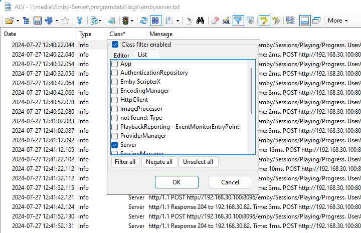

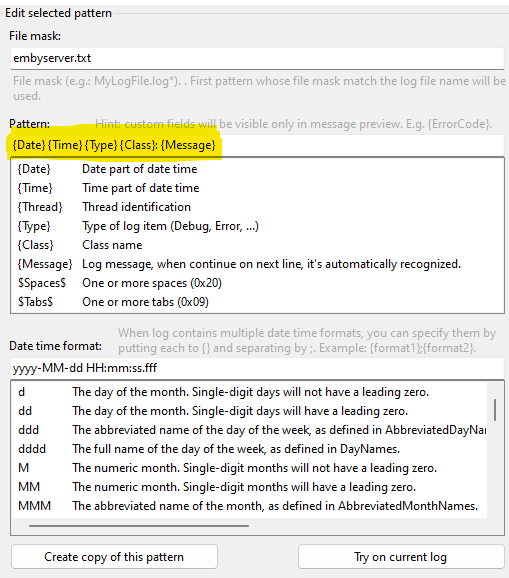

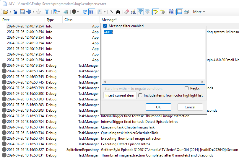

rbjtech 5412 Posted July 26, 2024 Posted July 26, 2024 (edited) If you use a decent log viewer - then you can simply filter it out - on live logs if you wish. I use Advanced Log Viewer - Free on Github. Then just create an Emby template/parser - Emby uses standard Date, Type, Class, Message - so all very easy. You can then filter on anything you like, Classes, Error only etc etc. To get rid of any web notices - simple negate http .. they all disappear from the list. All new messages are auto scrolled so you can watch things live once you have setup a filter ... Reading ANY log as is (not just Emby) simply cannot be effectively done without these tools .. personally, I think they should be integrated into emby (the basics anyway). But having said all of that - the option to remove 'playback' entries at source is a good idea, especially on a busy server. Edited July 26, 2024 by rbjtech 1 1

rbjtech 5412 Posted July 27, 2024 Posted July 27, 2024 (edited) 1 hour ago, ebr said: The point of the log is for diagnostics and, for that, context is very important. it would be difficult to separate what is "playback" activity vs not and, once you did, it would then be that much harder to derive the context when looking for issues. I personally don't see any true benefit to introducing this complexity to our logging. Agree 100% - putting it all in one log is far easier to parse - especially as in a decent log viewer, you simply specify you want the last x minutes for example. If you are verbose logging with debug enabled, then the logs can get big and 'slow down' after a while - so I actually rotate the log file ever 4 hours. @vaise As indicated above, the 'Class' of the log also allows you to filter or exclude by function - so for all 'Playback/http' activity - emby class this as 'Server'. The log quality is pretty good tbh - you just need the tools to extract what you need. You'll likely be able to find what you want in seconds. Then add a time filter for 5 seconds before and 5 seconds after (for example) and you'll have a snapshop of everything that happended on a 'single page' or less. The parsing template is very simply - see my example below for ALV (for embyserver.txt) :- Edited July 27, 2024 by rbjtech

rbjtech 5412 Posted July 28, 2024 Posted July 28, 2024 14 minutes ago, vaise said: I installed it, it seems way too complicated. Not sure where to start with it really. Icons dont seem to match yours. I had a stroke in 2021 and maybe I will find it easier in the morning after I have eaten. The wife says I am useless come evening..... You are almost there - you need to setup a log parser so it knows what's what in the log - goto 'more > parser patterns' and then copy the parser I've shown above. Once all the columns are good (match mine) then save. Yes it's a powerful log viewer, but once setup, you'll be able to find anything you could ever wish for .. 1

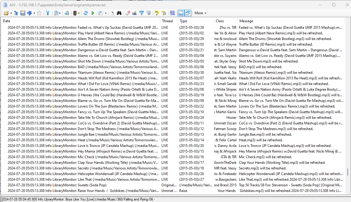

vaise 349 Posted July 28, 2024 Posted July 28, 2024 Should it be so buggy ? The more dropdown works once, but then it flashes and the app freezes, and clicking anywhere just dings the PC and I have to kill it with task manager. Its now stuck llist this, start the app, click more, then parser, it flashes up, goes away and then all crashed. I will try and un-install and re-install.
rbjtech 5412 Posted July 28, 2024 Posted July 28, 2024 (edited) 5 minutes ago, vaise said: Should it be so buggy ? The more dropdown works once, but then it flashes and the app freezes, and clicking anywhere just dings the PC and I have to kill it with task manager. Its now stuck llist this, start the app, click more, then parser, it flashes up, goes away and then all crashed. I will try and un-install and re-install. I don't have any issues at all - what version have you installed ? - I'm using 10.0.1 on Win 11 edit - ah, I see there is a new version - maybe try 10.0.1 as the new version has moved to .net 8 Edited July 28, 2024 by rbjtech
vaise 349 Posted July 28, 2024 Posted July 28, 2024 11.0.2. An uninstall and reinstall has fixed that lockup (so far) - I am back at it, but will be called for dinner soon.
