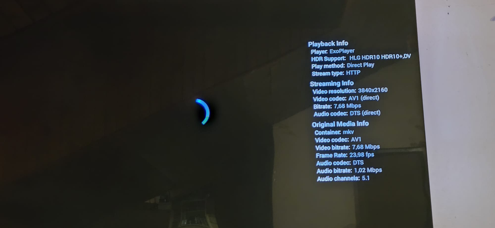

izzy198888 2 Posted July 24, 2024 Posted July 24, 2024 I tried to play a couple of av1 videos on my Google TV, but the videos just load/buffer indefinitely. Is there any solution. I am not interested in transcoding, only direct play. Yes, my TV supports AV1. Built in player plays them without a hitch.

izzy198888 2 Posted July 24, 2024 Author Posted July 24, 2024 So this is the situation. The video just loads and the screen is black. AV1 works on my tv even in Kodi and other video apps.

izzy198888 2 Posted July 24, 2024 Author Posted July 24, 2024 2024-07-24 19:32:40.360 Info SessionManager: Playback start reported by app AndroidTv 2.1.14g on 65OLED718/12 playing Underworld: Awakening. Started at 1322430 ms. PlaySessionId: 74cb8ecfb4ac4789bc82c94d4b91911f 2024-07-24 19:32:40.360 Info Server: http/1.1 Response 204 to host1. Time: 2ms. POST http://192.168.100.6:8096/emby/Sessions/Playing 2024-07-24 19:32:40.472 Info Server: http/1.1 GET http://192.168.100.6:8096/emby/videos/117295/original.mkv?DeviceId=24fed9fb5ab7e88f&MediaSourceId=b0a56d293625d1e597499a91c670d38c&PlaySessionId=74cb8ecfb4ac4789bc82c94d4b91911f&api_key=x_secret4_x. Connection=keep-alive, Host=host2, User-Agent=Emby/2.1.14g (Linux;Android 12) ExoPlayerLib/2.18.7, Accept-Encoding=identity, Icy-MetaData=1 2024-07-24 19:32:40.821 Info Server: http/1.1 Response 200 to host1. Time: 349ms. GET http://192.168.100.6:8096/emby/videos/117295/original.mkv?DeviceId=24fed9fb5ab7e88f&MediaSourceId=b0a56d293625d1e597499a91c670d38c&PlaySessionId=74cb8ecfb4ac4789bc82c94d4b91911f&api_key=x_secret4_x 2024-07-24 19:32:40.876 Info Server: http/1.1 GET http://192.168.100.6:8096/emby/videos/117295/original.mkv?DeviceId=24fed9fb5ab7e88f&MediaSourceId=b0a56d293625d1e597499a91c670d38c&PlaySessionId=74cb8ecfb4ac4789bc82c94d4b91911f&api_key=x_secret4_x. Connection=keep-alive, Host=host2, User-Agent=Emby/2.1.14g (Linux;Android 12) ExoPlayerLib/2.18.7, Accept-Encoding=identity, Range=bytes=4847956243-, Icy-MetaData=1 2024-07-24 19:32:40.956 Info Server: http/1.1 Response 206 to host1. Time: 80ms. GET http://192.168.100.6:8096/emby/videos/117295/original.mkv?DeviceId=24fed9fb5ab7e88f&MediaSourceId=b0a56d293625d1e597499a91c670d38c&PlaySessionId=74cb8ecfb4ac4789bc82c94d4b91911f&api_key=x_secret4_x 2024-07-24 19:32:41.189 Info Server: http/1.1 GET http://192.168.100.6:8096/emby/videos/117295/original.mkv?DeviceId=24fed9fb5ab7e88f&MediaSourceId=b0a56d293625d1e597499a91c670d38c&PlaySessionId=74cb8ecfb4ac4789bc82c94d4b91911f&api_key=x_secret4_x. Connection=keep-alive, Host=host2, User-Agent=Emby/2.1.14g (Linux;Android 12) ExoPlayerLib/2.18.7, Accept-Encoding=identity, Range=bytes=10477-, Icy-MetaData=1 2024-07-24 19:33:21.358 Info Server: http/1.1 Response 206 to host1. Time: 40168ms. GET http://192.168.100.6:8096/emby/videos/117295/original.mkv?DeviceId=24fed9fb5ab7e88f&MediaSourceId=b0a56d293625d1e597499a91c670d38c&PlaySessionId=74cb8ecfb4ac4789bc82c94d4b91911f&api_key=x_secret4_x 2024-07-24 19:34:20.209 Info SessionManager: Session 74cb8ecfb4ac4789bc82c94d4b91911f has gone idle while playing 2024-07-24 19:34:20.210 Info SessionManager: Playback stopped reported by app AndroidTv 2.1.14g on 65OLED718/12 playing Underworld: Awakening. Stopped at 1411430 ms. PlaySessionId: 74cb8ecfb4ac4789bc82c94d4b91911f 2024-07-24 19:34:20.210 Info SessionManager: Removing playSession 74cb8ecfb4ac4789bc82c94d4b91911f from session 870b5d1cc095d9b0068a4d760446df0c 2024-07-24 19:34:41.954 Info Server: http/1.1 POST http://192.168.100.6:8096/emby/Sessions/Playing/Stopped. UserAgent: Dalvik/2.1.0 (Linux; U; Android 12; Philips Google TV TA1 Build/STT2.230831.001) 2024-07-24 19:34:41.954 Info SessionManager: Playback stopped reported by app AndroidTv 2.1.14g on 65OLED718/12 playing unknown item. Stopped at 1322430 ms. PlaySessionId: 74cb8ecfb4ac4789bc82c94d4b91911f 2024-07-24 19:34:41.954 Info Server: http/1.1 Response 204 to host1. Time: 0ms. POST http://192.168.100.6:8096/emby/Sessions/Playing/Stopped
