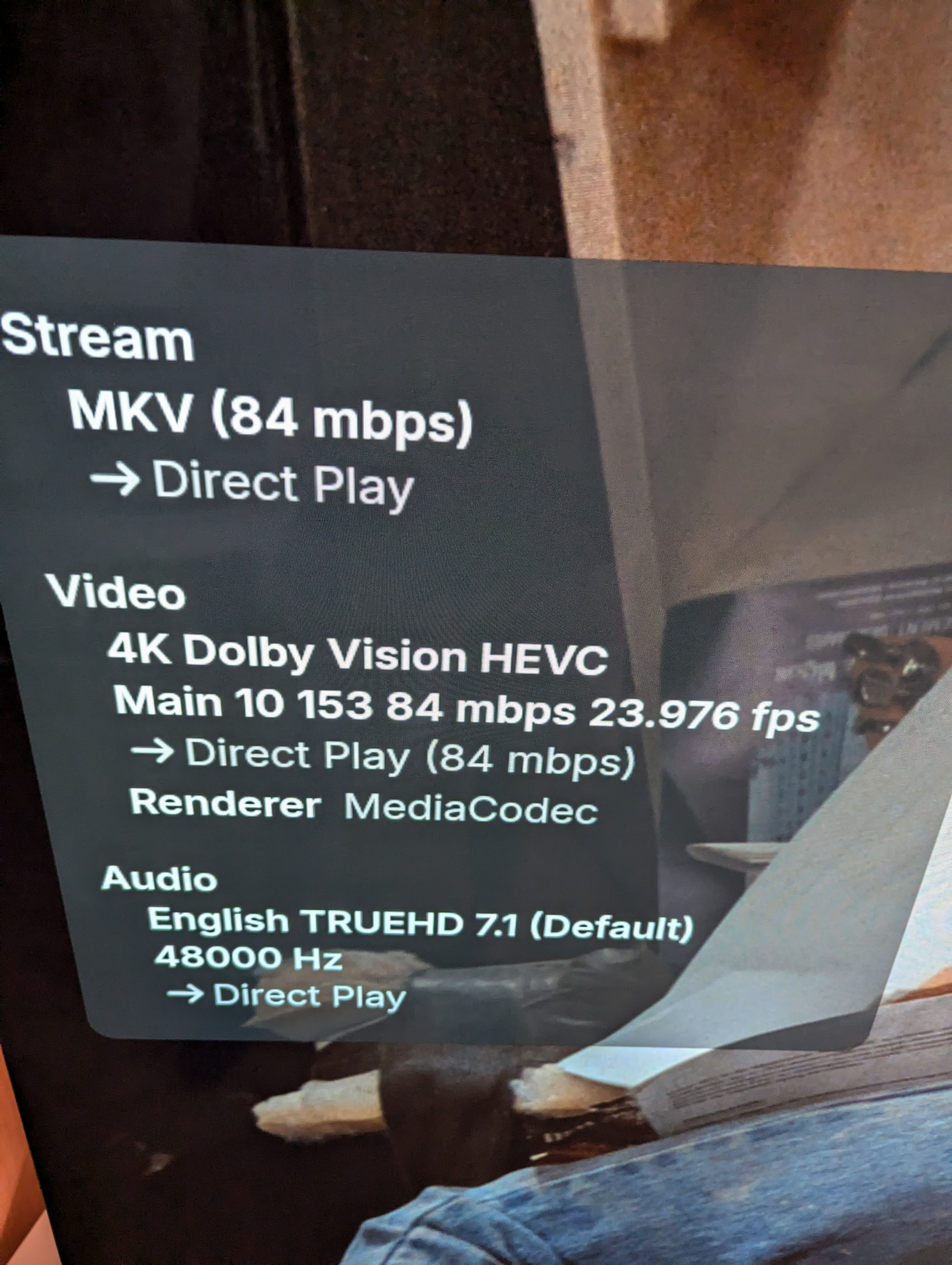

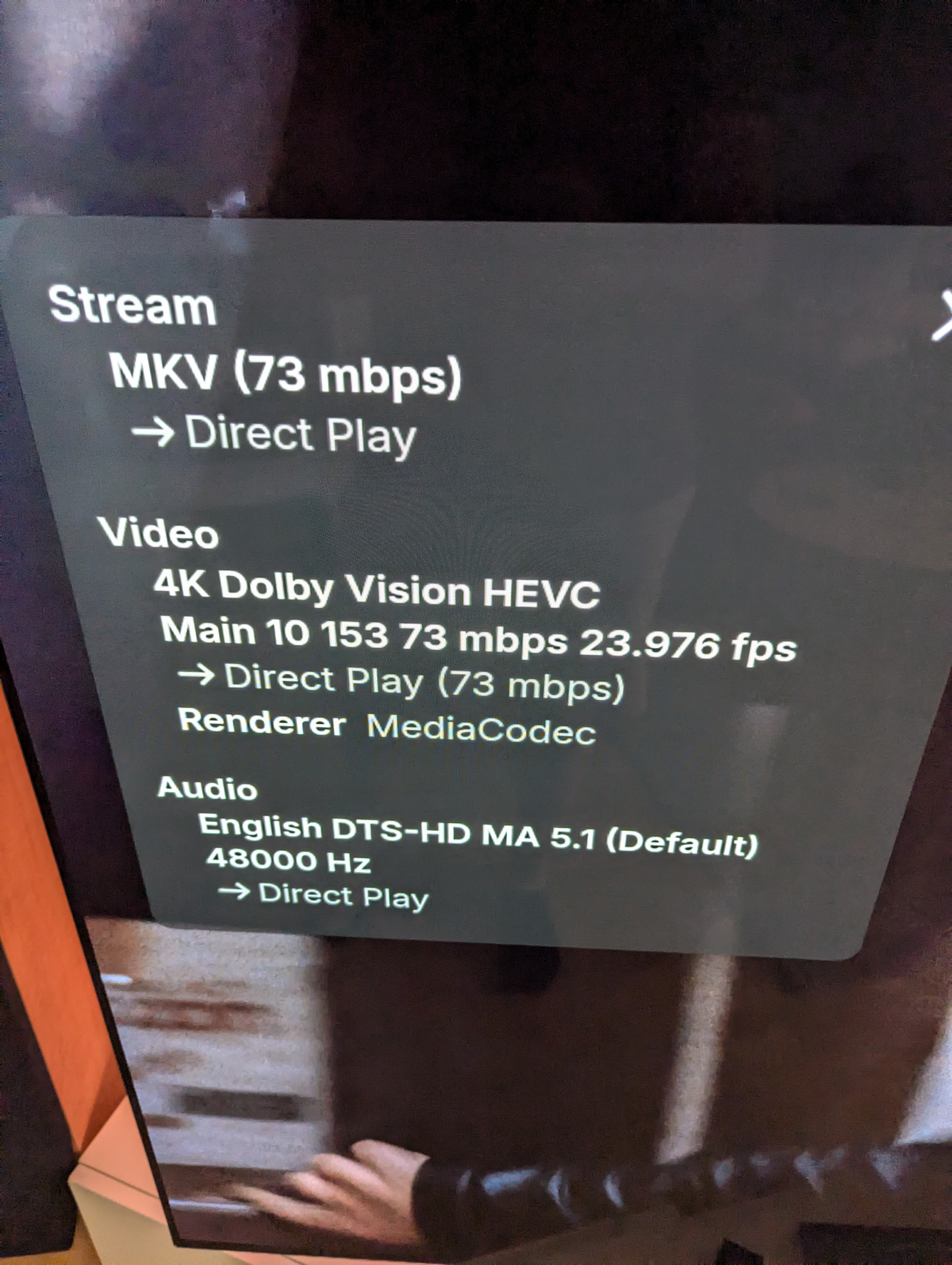

As777 27 Posted July 22, 2024 Author Posted July 22, 2024 (edited) I made some more tests. If i turn off audio and video transcoding for my profile it stil transcodes the audio to AC3. Even the DTS HD MA stereo stream is being transcoded. When I play the same file in Kodi I get the DTS HD MA text on my receiver confirming the correct audio stream. I tested a different movie in Emby that also has DTS HD MA and it passes through correctly. So it is only certain movies this is happening, not all. Edited July 22, 2024 by As777

As777 27 Posted July 23, 2024 Author Posted July 23, 2024 (edited) 11 minutes ago, ebr said: If you want full HD audio support, you need to bypass the TV. I don't think any of them will pass thru HD audio formats from an Android device via ARC. I bet to differ but they absolutely do. My receiver will not display the DTS HD MA and 7:1 does not work when it transcodes (transcodes to 5:1). When it passes through the 7:1 works perfectly. You obviously haven't read the tests I made yesterday after quoting you as it's only some streams that are not passing through in Emby. "Stats for nerds" doesn't show it is transcoding when the stream passes through but it does when it transcodes. The receiver also shows that the stream is not DTS HD MA which is how I know it was suddenly transcoding in the first place. It also doesn't transcode to 7:1 but only 5:1. Kodi always passes through correctly to the receiver. If you use Emby on the TV and not the Shield then it never passes through the DTS HS MA stream, which is one of the reasons I upgraded to the Shield Pro (it is the only device I have found that does HD audio). There are no Android TVs that I am aware of that can pass through uncompressed audio. But on my LG C3 the passthrough works from the Shield just fine (as it does on my Sony tv too). I am unsure why you are insistent that I need to plug it into the receiver when I've already said in my original post that it works perfectly well from Kodi. For the record, TrueHD has always passed through correctly. Edited July 23, 2024 by As777

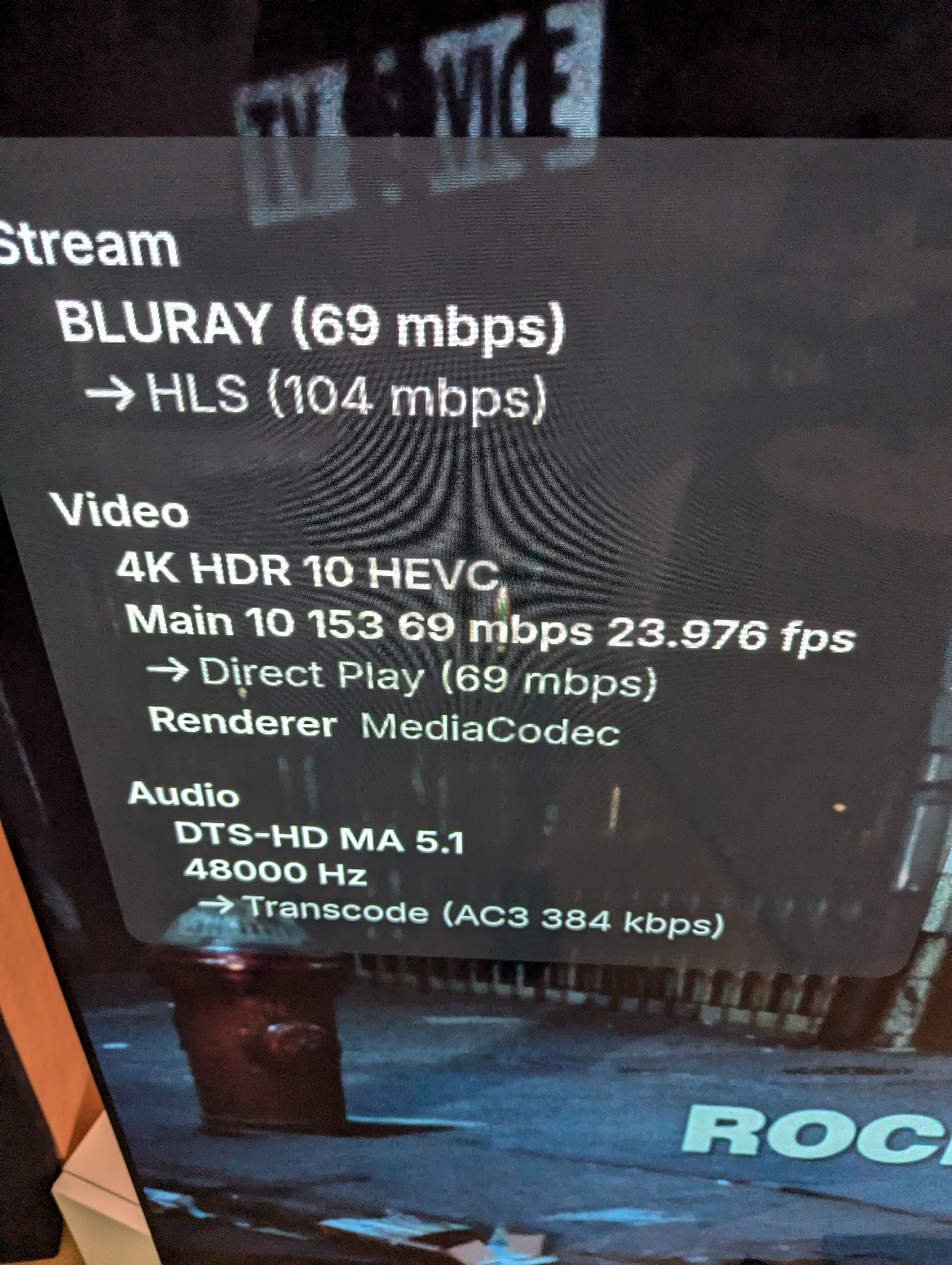

As777 27 Posted July 23, 2024 Author Posted July 23, 2024 Maybe the last picture is a bad example as I just realised now it's not actually an mkv container but direct bluray. But this is also an example of the original problem - even if the video decides to transcode so does the audio stream too. And I don't want that.
ebr 16337 Posted July 23, 2024 Posted July 23, 2024 37 minutes ago, As777 said: even if the video decides to transcode so does the audio stream too. If the item needs to be transcoded or remuxed for any reason, then we can no longer send HD audio because we are now delivering via HLS.
As777 27 Posted July 23, 2024 Author Posted July 23, 2024 (edited) 1 hour ago, ebr said: If the item needs to be transcoded or remuxed for any reason, then we can no longer send HD audio because we are now delivering via HLS. Ah ok, then that's the origin of the problem then. Is it not possible to transcode to 7:1 flac or E-AC3 in these cases? I mostly don't want to downgrade to 5:1 when transcoding. Edited July 23, 2024 by As777
ebr 16337 Posted July 23, 2024 Posted July 23, 2024 5 hours ago, As777 said: Ah ok, then that's the origin of the problem then. Is it not possible to transcode to 7:1 flac or E-AC3 in these cases? I mostly don't want to downgrade to 5:1 when transcoding. It is complicated and there is a lot of previous discussion out here but the short answer is not at this time.
