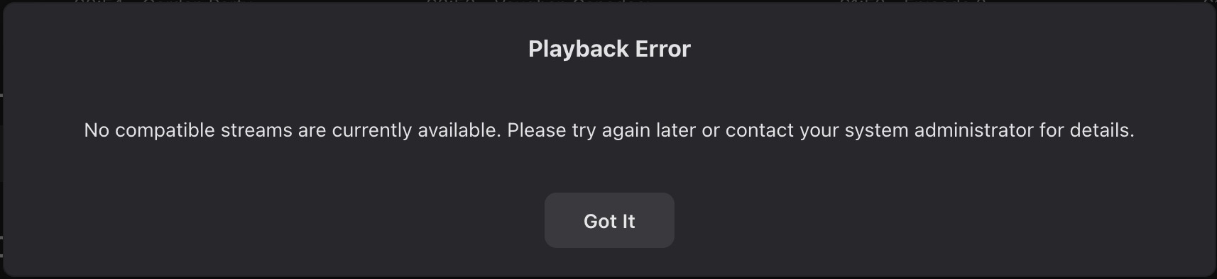

Spexor 3 Posted July 22, 2024 Posted July 22, 2024 On 7/15/2022 at 5:52 PM, Luke said: That's great. I think it will. We'll get it into a 4.7.X release next month once they've published. Im doing the same thing as the original poster and running into the same issue except trying to play the PST stream with the offset just crashes. So looks like it's still a problem in 2024.

Spexor 3 Posted July 26, 2024 Author Posted July 26, 2024 Here you go. I replicated it and grabbed the log and screenshot. ffmpeg-transcode-8aec6b25-917d-4d07-98c6-461fbf059352_1.txt
Spexor 3 Posted July 26, 2024 Author Posted July 26, 2024 2 hours ago, Luke said: OK and you think it's stripping url arguments? if i try playing it regularly through the integrated IPTV of Emby I get that error and log output. If I use the IPTV plugin and add "http://api.toonamiaftermath.com:3000/est/playlist.m3u8?streamDelay=180&useHttps=true" in it plays instantly with no issue. It only crashes if I use the built in IPTV feature. As far as I can tell the only difference between the EST and PST stream is the added URL arguments for the PST stream. It used to work but at some point it stopped.
Spexor 3 Posted July 27, 2024 Author Posted July 27, 2024 16 hours ago, Luke said: How did you set it up in Emby live TV? I take the .m3u URL from the docker and add it. The other Toonami channels work but they don't have any extra arguments. I just tried directly adding that m3u8 url from my previous post to Emby live TV and strangely enough that worked. So the URL by itself with the arguments works but when trying to play from inside the m3u file with the arguments it doesn't work. If it helps I uploaded the m3u file. ToonamiAftermath.m3u
