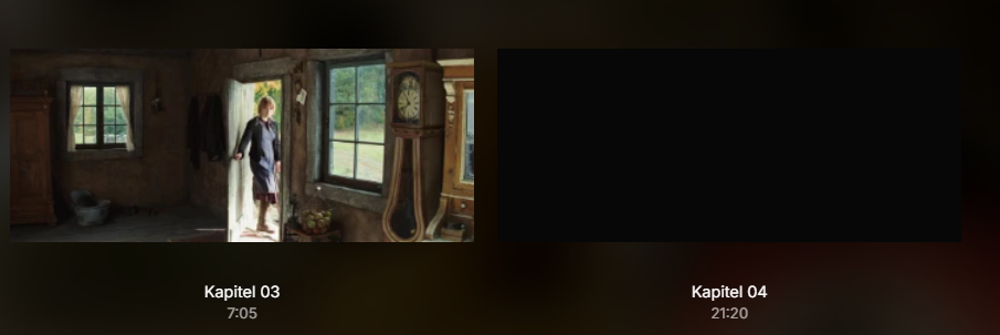

I have multiple movies with uncomplete chapter images. This happens just with HEVC/x265 HDR content it seems.
Library is set up to generate images when doing a library scan and when media is added. Interval for extraction is "chapter markers". I do not have BIF files.
Attached is the server log and image extraction logs for two movies I added together, one finishes successful, one finishes to early.
Manually trigger the create thumbnails or generate HDR-> SDR task does not solve the problem.

I ran the Thumbnail Image HDR-SDR Image Generation task, and some thumbs like in the images above are gone.
The provided log does not show any image extraction for the media in the screenshot "Kapitel"

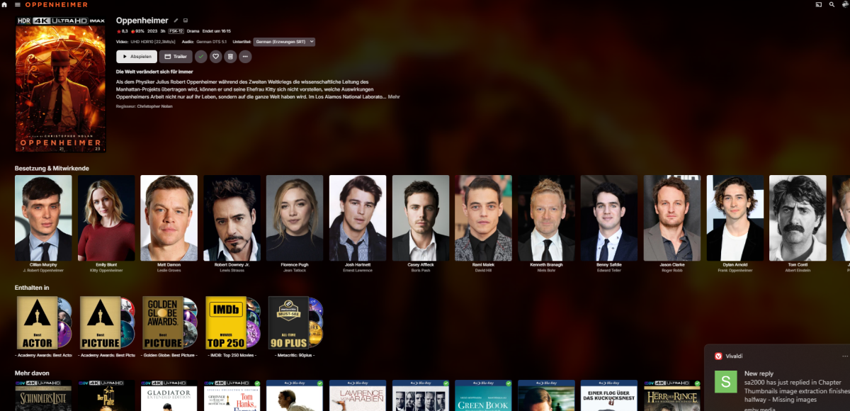

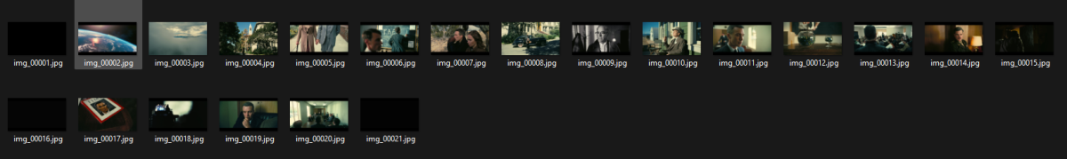

 When I add new media, chapter thumbnails are generated, but it seems after the next library scan, some chapter images (if not all) are missing. This just happens with my 4K (HDR/DV) movies. After @rbjtechsuggestion, before doing the test I deactivated all boxes regarding the usage of HDR-SDR conversion in the media toolbox plugin. So the upcoming test was just done with the Emby inbuilt image extraction.
For clean logs:
1. Added a new movie (Oppenheimer)
4. made a library scan

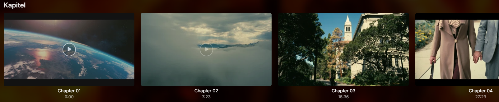

Result: All chapter thumbs are present in temp folder and Detail page of the movie (image extract log attached).
5. Made a second library scan without changing anything.
Result: Images are still in temp folder, but they are gone in the Detail Page.
Oppenheimer ist the worst, since chapter section in WebUI is totally gone because of no images to show. Some other movies Detail pages show the Chapter section but for example just 3 chapter thumbs out of 15.
embyserver (14).txt extract-multi-image-0AF172EC915F_1_all images_present.txt
