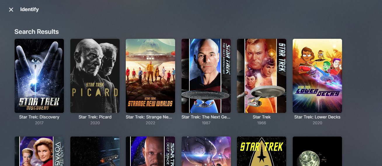

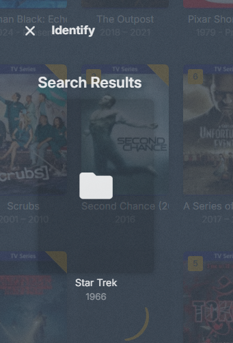

Happy2Play 9814 Posted July 22, 2024 Posted July 22, 2024 (edited) Without server log for the series import it is hard to say but first guess would be the year but since you mention you added providerid to name we would still need to see server log and specific naming scheme. But see no issues with identify by name as 1966 version appears. or by tvdbid=77526 Edited July 22, 2024 by Happy2Play

1jfeldman 1 Posted December 1, 2025 Posted December 1, 2025 I realize this is more than a year later, but I had this problem as well and it was resolved simply by naming the files “Star Trek TOS” instead of just “Star Trek”, which seemed to lead emby to think that it was Star Trek Discovery. Using 1966 instead did not work. All episodes also had to be renamed, not just the top folder, so “Star Trek TOS - s01e01” and so on. I hope this helps someone else. Cheers. 1
