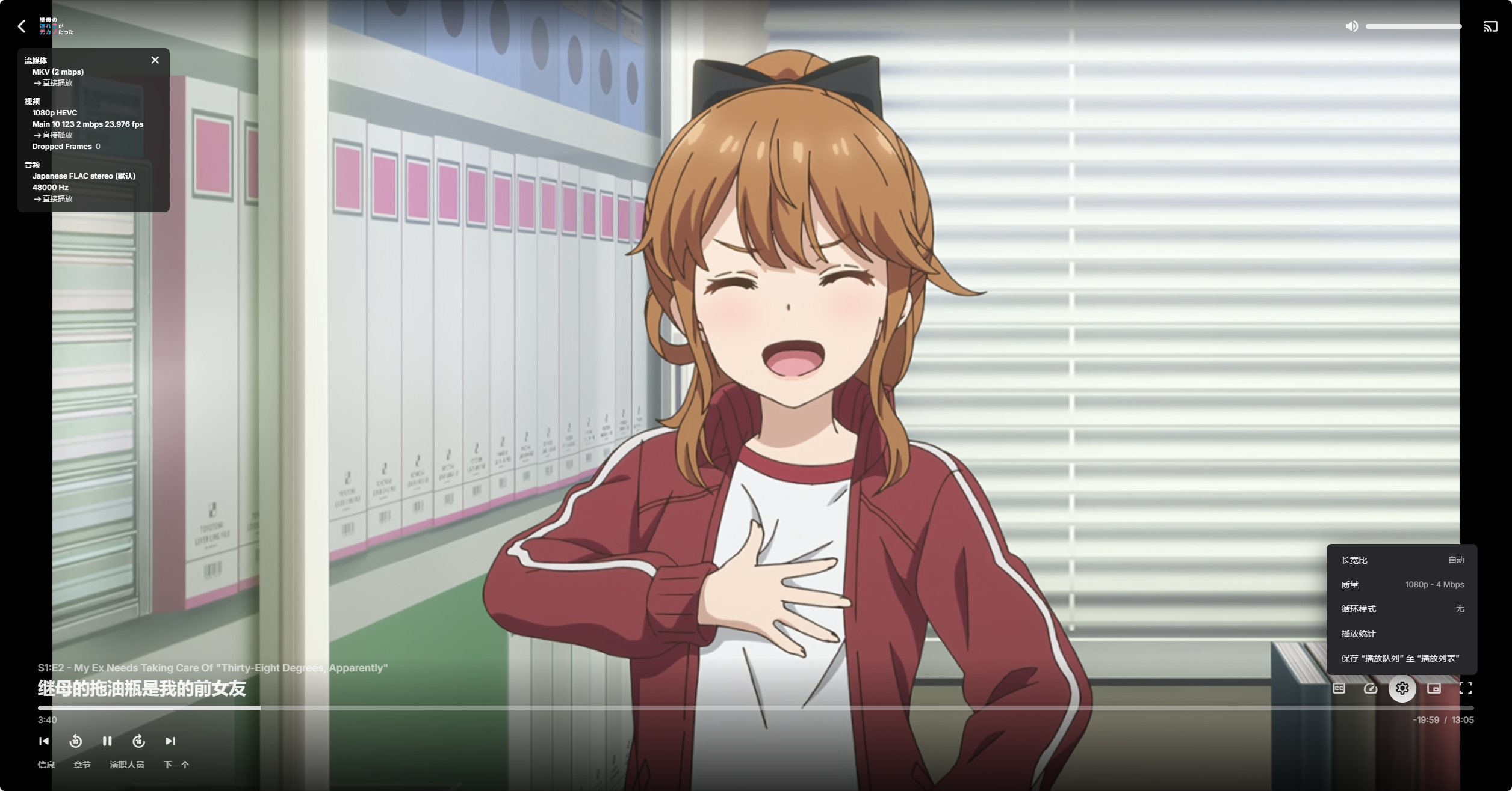

SakuraRainSnow 3 Posted July 18, 2024 Posted July 18, 2024 I don't konw why but when I access emby from the external network, the media loading will be very slow in every frist time.when i open media,i need wait 2+ mins to loading it. And when it's loading,I can see that emby is using all my upload bandwidth(About 50Mbps,The video code rate is less than 1080p-30Mbps ) I don' t know why it's happend,and on the contrary, if I play it directly without emby, the video can load quickly (using VLC player) In addition, if I use the intranet IP to access, the video loading speed is completely normal embyserver.txt

SakuraRainSnow 3 Posted July 20, 2024 Author Posted July 20, 2024 2 hours ago, Luke said: Hi, I would try lowering the in-app quality setting. That will usually help with this kind of issue. Please let us know if this helps. Thanks ! Thanks for your reply,I test set my internet quality setting to 720P-4Mbps,then the media loading will be fast.and it triggers emby hardware transcoding. When I set it to 1080p-4Mbps, emby will use my all upload of nearly 50Mbps. Is this normal?

SakuraRainSnow 3 Posted July 27, 2024 Author Posted July 27, 2024 On 7/23/2024 at 12:13 AM, Lessaj said: A 300 MB file being transferred at 50 Mbps would take 48 seconds, likely not maintaining full speed the whole time so closer to a minute seems about right. I'm not sure how direct play preloading works exactly, if it's a duration of time, or a set amount of data, but it should start to play within a few seconds if your connection is being maxed out, it shouldn't take 2 minutes to start. I know that,so I find it weird. I can see emby uses a much larger amount of data than the source file to load the video for 400MB file,emby can used more than 500MB data upload... I can even record a video of data usage
SakuraRainSnow 3 Posted July 27, 2024 Author Posted July 27, 2024 On 7/23/2024 at 12:13 AM, Lessaj said: A 300 MB file being transferred at 50 Mbps would take 48 seconds, likely not maintaining full speed the whole time so closer to a minute seems about right. I'm not sure how direct play preloading works exactly, if it's a duration of time, or a set amount of data, but it should start to play within a few seconds if your connection is being maxed out, it shouldn't take 2 minutes to start. for loading this file,emby used 400MB+ upload,but source file just 400MB,And in the process of playing, it is still continuously uploaded,this is so strange..
SakuraRainSnow 3 Posted July 27, 2024 Author Posted July 27, 2024 (edited) On 7/20/2024 at 12:27 PM, Luke said: Was it direct playing in that case? Can you take a look at my reply?And log file was upload embyserver (1).txt Edited July 27, 2024 by SakuraRainSnow
SakuraRainSnow 3 Posted July 29, 2024 Author Posted July 29, 2024 On 7/20/2024 at 12:27 PM, Luke said: Was it direct playing in that case? I discovered a strange phenomenon If the video I play triggers hardware transcoding, this problem no longer exists and playback from external networks is completely fine. Even though its transcoding quality is 1080P 4Mbps
