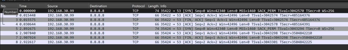

Volfan6415 19 Posted July 17, 2024 Posted July 17, 2024 Ok so i have been having a weird playback issue that i couldn't track down. It only happens on some 4k hevc videos. I thought it was video network related etc. but ruled everything out. What i do see happening is that when i watch the roku device in my microtik router the freezes happen when roku tries to "phone home" using googles dns (8.8.8.8, 8.8.4.4) I should add that I have a pihole setup on the primary dns given out by my router. There are numerous attempts between the roku trying the hard coded addresses but once the attempts at the hard coded dns addresses happen the video paues and playback takes a few seconds (20-30) to resume again. Has anyone else seen this behavior? I really don't want to have to let the roku bypass pihole. Is this something with the EMBY app that it thinks network connectivity is being lost? I am using server version 4.9.0.26 and the current version of the emby roku app.

Volfan6415 19 Posted July 17, 2024 Author Posted July 17, 2024 Ok so i have done some more testing. I whitelisted the scribes.logs.roku in pihole. No change in behavior roughly every five minutes there is a pause in the video feed and my router shows dns calls to 8.8.8.8 and the video freezes. I also tested two other roku apps (ESPN and Pluto.TV) and watched the tracelogs on the microtik. There were never any attempts at 8.8.8.8. These only occurred with playback in the EMBY for roku app. I am on version 4.1.24 of the roku app.
Volfan6415 19 Posted July 17, 2024 Author Posted July 17, 2024 I used packet sniffer in microtik the pcap file is below. But these are the packets that get generated that I was talking about at the time of the freeze capture.pcap
