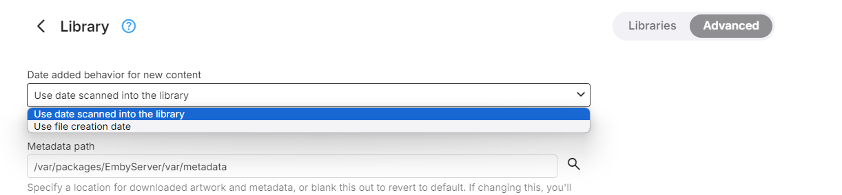

GrimReaper 4926 Posted July 15, 2024 Posted July 15, 2024 What is your Date added behavior for newly added content set to in Settings>Library tab>Advanced?
maxnb 1 Posted July 15, 2024 Author Posted July 15, 2024 Hi I tested both of these (see attached image), I had "use file creation date" which I changed now to "Use date scanned into the library", doing that didn't change the list. Should I clear sometihng for effect to take place or? List is basically exactly the same as before change.
Solution GrimReaper 4926 Posted July 15, 2024 Solution Posted July 15, 2024 6 minutes ago, maxnb said: I had "use file creation date" which I changed now to "Use date scanned into the library" And that is the one you want, going forward. 7 minutes ago, maxnb said: doing that didn't change the list. It won't affect existing items as their Date Added is already written as File creation date per your previous settings; you'd have to remove those items out of your Movies root, Scan media library to clear db, move them back and run a Scan again. Newly added content will behave as expected. 1
