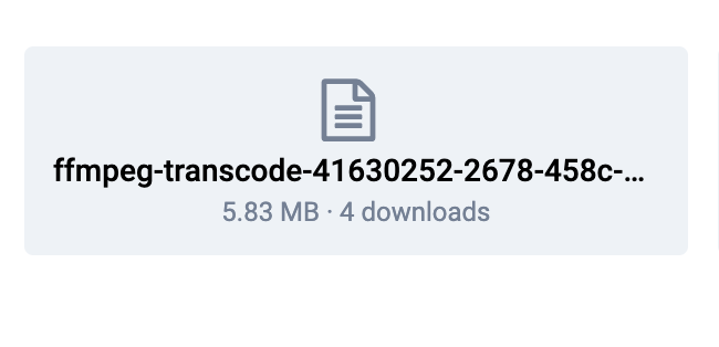

Jcheinaman 19 Posted July 14, 2024 Posted July 14, 2024 Ok, hear me out please. I originally ran into this issue running the Emby beta on Unraid and started randomly having this freezing and skipping issue. After ripping my hair out trying to figure out what was causing this, I switched back to the public release of Emby with a fresh install. Unfortunately, I still have the same problem. It doesn’t seem to matter if it’s a tv show or a movie. It will randomly freeze and I’ll have to hit stop and play again. other times when I pause a movie or show, it will play for a bit, then skip back a few minutes. It seems like it gets stuck in a loop and will keep doing this. I have to stop and start it again to fix the issue. I was recently watching Megan and attached 3 ffmpeg logs and the Emby server log. can someone who understands what they’re looking at help me figure this out please? Thank you!! ffmpeg-remux-842631d4-a024-4e45-9bb6-1d9848156e46_1.txt ffmpeg-transcode-41630252-2678-458c-b5ba-718d9fafdbfe_1.txt embyserver.txt ffmpeg-remux-fad1fbd0-7d16-4fb1-8aeb-a754911bf485_1.txt

SamES 1084 Posted July 14, 2024 Posted July 14, 2024 I can see that you have a global remote bitrate set which is causing the transcoding in one of the logs, and it looks like your server can't keep up with transcoding as the speed drops below 1.0x >> ThrottleBySegmentRequest: RequestPosition: 00:00:00 - TranscodingPosition: 00:02:37 - ThrottleBuffer: 158s (Treshold: 120s) 19:54:01.693 elapsed=00:03:12.36 frame= 4000 fps= 21 q=21.0 size=N/A time=00:02:37.80 bitrate=N/A throttle=100 speed=0.82x 19:54:02.195 elapsed=00:03:12.86 frame= 4001 fps= 21 q=28.0 size=N/A time=00:02:37.84 bitrate=N/A throttle=100 speed=0.818x 19:54:02.697 elapsed=00:03:13.36 frame= 4002 fps= 21 q=28.0 size=N/A time=00:02:37.90 bitrate=N/A throttle=100 speed=0.817x 19:54:03.199 elapsed=00:03:13.86 frame= 4003 fps= 21 q=28.0 size=N/A time=00:02:37.93 bitrate=N/A throttle=100 speed=0.815x >> ThrottleBySegmentRequest: RequestPosition: 00:00:00 - TranscodingPosition: 00:02:37 - ThrottleBuffer: 158s (Treshold: 120s) 19:54:03.701 elapsed=00:03:14.37 frame= 4004 fps= 21 q=21.0 size=N/A time=00:02:37.96 bitrate=N/A throttle=100 speed=0.813x 19:54:04.205 elapsed=00:03:14.87 frame= 4005 fps= 21 q=29.0 size=N/A time=00:02:38.03 bitrate=N/A throttle=100 speed=0.811x 19:54:04.706 elapsed=00:03:15.37 frame= 4006 fps= 21 q=28.0 size=N/A time=00:02:38.06 bitrate=N/A throttle=100 speed=0.809x 19:54:05.208 elapsed=00:03:15.87 frame= 4007 fps= 20 q=28.0 size=N/A time=00:02:38.09 bitrate=N/A throttle=100 speed=0.807x You're also trying to play audio tracks not supported by the TV - avoid TrueHD/Atmos and DTS. Select the AC3 track before you start playback and it should be better
Jcheinaman 19 Posted July 14, 2024 Author Posted July 14, 2024 (edited) 14 minutes ago, SamES said: I can see that you have a global remote bitrate set which is causing the transcoding in one of the logs, and it looks like your server can't keep up with transcoding as the speed drops below 1.0x >> ThrottleBySegmentRequest: RequestPosition: 00:00:00 - TranscodingPosition: 00:02:37 - ThrottleBuffer: 158s (Treshold: 120s) 19:54:01.693 elapsed=00:03:12.36 frame= 4000 fps= 21 q=21.0 size=N/A time=00:02:37.80 bitrate=N/A throttle=100 speed=0.82x 19:54:02.195 elapsed=00:03:12.86 frame= 4001 fps= 21 q=28.0 size=N/A time=00:02:37.84 bitrate=N/A throttle=100 speed=0.818x 19:54:02.697 elapsed=00:03:13.36 frame= 4002 fps= 21 q=28.0 size=N/A time=00:02:37.90 bitrate=N/A throttle=100 speed=0.817x 19:54:03.199 elapsed=00:03:13.86 frame= 4003 fps= 21 q=28.0 size=N/A time=00:02:37.93 bitrate=N/A throttle=100 speed=0.815x >> ThrottleBySegmentRequest: RequestPosition: 00:00:00 - TranscodingPosition: 00:02:37 - ThrottleBuffer: 158s (Treshold: 120s) 19:54:03.701 elapsed=00:03:14.37 frame= 4004 fps= 21 q=21.0 size=N/A time=00:02:37.96 bitrate=N/A throttle=100 speed=0.813x 19:54:04.205 elapsed=00:03:14.87 frame= 4005 fps= 21 q=29.0 size=N/A time=00:02:38.03 bitrate=N/A throttle=100 speed=0.811x 19:54:04.706 elapsed=00:03:15.37 frame= 4006 fps= 21 q=28.0 size=N/A time=00:02:38.06 bitrate=N/A throttle=100 speed=0.809x 19:54:05.208 elapsed=00:03:15.87 frame= 4007 fps= 20 q=28.0 size=N/A time=00:02:38.09 bitrate=N/A throttle=100 speed=0.807x You're also trying to play audio tracks not supported by the TV - avoid TrueHD/Atmos and DTS. Select the AC3 track before you start playback and it should be better I do believe it’s below 100 because I have transcoding throttle set to enabled. I don’t believe transcoding audio would be the cause of this. If I turn transcode throttling off, the entire audio stream is usually transcoded in less than a minute. FYI, I disabled throttling and experience this same issue, even though the entire audio stream was transcoded. Also, it wouldn’t explain the weird jumping backwards to randoms spots after resuming from paused. This issue only started a few months ago. Prior to this I’ve had no issues with the same hardware, files, and settings. I’ve been using Emby for a few years. I'm running a 16 core AMD 3950x cpu and encode video with NVENC hardware transcoding. Certainly that will keep up with audio transcoding. Edited July 14, 2024 by Jcheinaman
SamES 1084 Posted July 14, 2024 Posted July 14, 2024 (edited) if transcoding speed is < 1 then it's not keeping up with the playback speed. That's a problem Edited July 14, 2024 by SamES

Jcheinaman 19 Posted July 15, 2024 Author Posted July 15, 2024 12 hours ago, SamES said: if transcoding speed is < 1 then it's not keeping up with the playback speed. That's a problem I appreciate your input, but I disagree. I turned off throttling, the audio streams are all transcoded in a minute or less usually. The .80 is due to the throttle. When that kicks on, the audio stream is still far ahead, it just doesn't require that much processing power to get it to the next throttle down point. Any of the devs can correct me if I'm wrong, but audio is one of the easiest things to transcode.
SamES 1084 Posted July 15, 2024 Posted July 15, 2024 45 minutes ago, Jcheinaman said: I appreciate your input, but I disagree. I turned off throttling, the audio streams are all transcoded in a minute or less usually. The .80 is due to the throttle. When that kicks on, the audio stream is still far ahead, it just doesn't require that much processing power to get it to the next throttle down point. Any of the devs can correct me if I'm wrong, but audio is one of the easiest things to transcode. I think the log I checked and took the samples from was video transcoding, not just audio.
Jcheinaman 19 Posted July 15, 2024 Author Posted July 15, 2024 3 minutes ago, SamES said: I think the log I checked and took the samples from was video transcoding, not just audio. According to Emby, the video was direct play. Only audio transcoding. 16 hours ago, SamES said: I can see that you have a global remote bitrate set which is causing the transcoding in one of the logs, and it looks like your server can't keep up with transcoding as the speed drops below 1.0x >> ThrottleBySegmentRequest: RequestPosition: 00:00:00 - TranscodingPosition: 00:02:37 - ThrottleBuffer: 158s (Treshold: 120s) 19:54:01.693 elapsed=00:03:12.36 frame= 4000 fps= 21 q=21.0 size=N/A time=00:02:37.80 bitrate=N/A throttle=100 speed=0.82x 19:54:02.195 elapsed=00:03:12.86 frame= 4001 fps= 21 q=28.0 size=N/A time=00:02:37.84 bitrate=N/A throttle=100 speed=0.818x 19:54:02.697 elapsed=00:03:13.36 frame= 4002 fps= 21 q=28.0 size=N/A time=00:02:37.90 bitrate=N/A throttle=100 speed=0.817x 19:54:03.199 elapsed=00:03:13.86 frame= 4003 fps= 21 q=28.0 size=N/A time=00:02:37.93 bitrate=N/A throttle=100 speed=0.815x >> ThrottleBySegmentRequest: RequestPosition: 00:00:00 - TranscodingPosition: 00:02:37 - ThrottleBuffer: 158s (Treshold: 120s) 19:54:03.701 elapsed=00:03:14.37 frame= 4004 fps= 21 q=21.0 size=N/A time=00:02:37.96 bitrate=N/A throttle=100 speed=0.813x 19:54:04.205 elapsed=00:03:14.87 frame= 4005 fps= 21 q=29.0 size=N/A time=00:02:38.03 bitrate=N/A throttle=100 speed=0.811x 19:54:04.706 elapsed=00:03:15.37 frame= 4006 fps= 21 q=28.0 size=N/A time=00:02:38.06 bitrate=N/A throttle=100 speed=0.809x 19:54:05.208 elapsed=00:03:15.87 frame= 4007 fps= 20 q=28.0 size=N/A time=00:02:38.09 bitrate=N/A throttle=100 speed=0.807x You're also trying to play audio tracks not supported by the TV - avoid TrueHD/Atmos and DTS. Select the AC3 track before you start playback and it should be better I do believe it’s below 100 because I have transcoding throttle set to enabled. I don’t believe transcoding audio would be the cause of this. If I turn transcoding throttling off, the entire audio stream is usually transcoded in less than a minute. FYI, I disabled throttling and experience this same issue, even though the entire audio stream was transcoded. Also, it wouldn’t explain the weird jumping backwards to randoms spots after resuming from paused. This issue only started a few months ago. Prior to this I’ve had no issues with the same hardware, files, and settings. I’ve been using Emby for a few years. I'm running a 16 core AMD 3950x cpu and encode video with NVENC hardware transcoding. Certainly that will keep up with audio transcoding.
SamES 1084 Posted July 15, 2024 Posted July 15, 2024 This log is a transcode. If you believe that you server performance is fine, then I would say most likely it is a network issue. Are you playing on the same local network as the server? Restart all your network gear and check everything is working as expected
