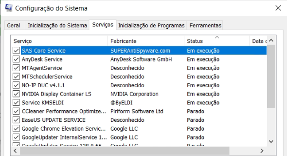

Luke 42288 Posted July 14, 2024 Posted July 14, 2024 It sounds like an issue of system resources and not related to the license. What other software runs on the machine?
trekflix 5 Posted July 14, 2024 Author Posted July 14, 2024 Attached is the list of active programs. All are needed: Use AnyDesk for remote connection. No-IP is what makes the external connection to Emby as a website.

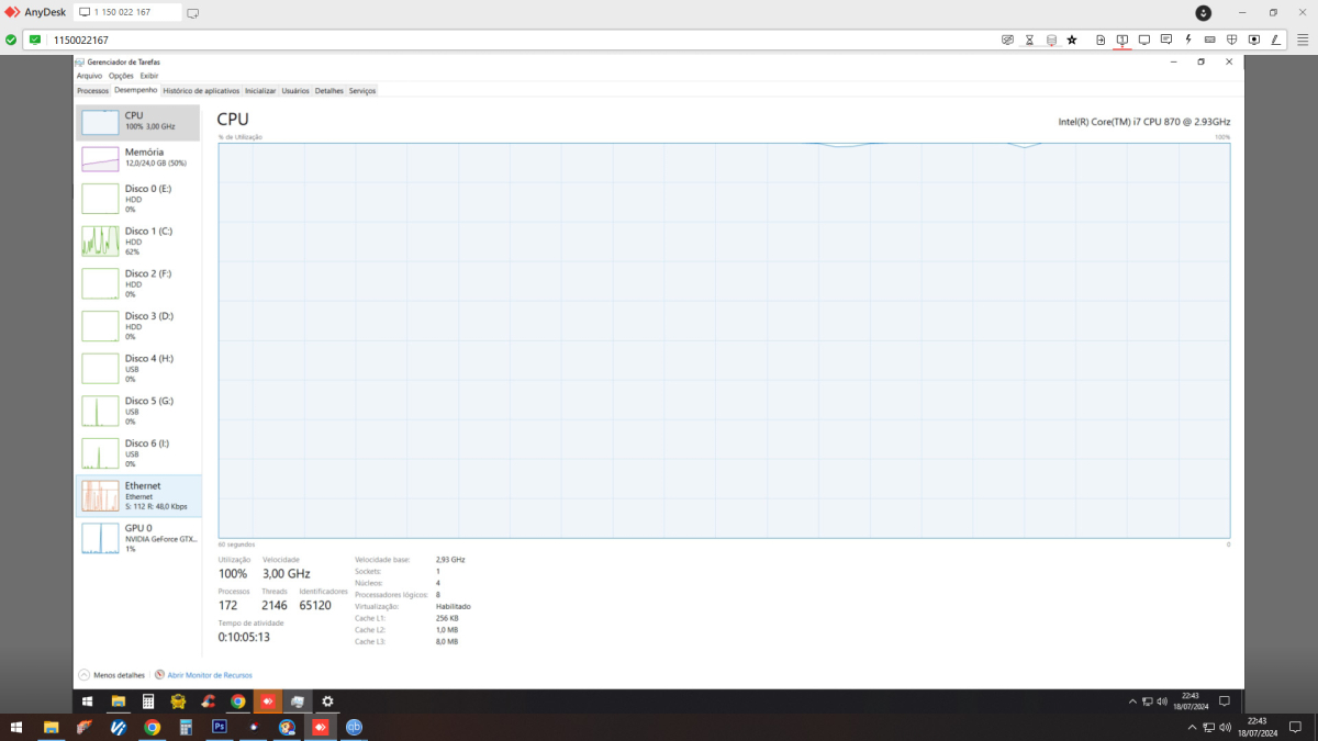

seanbuff 1360 Posted July 19, 2024 Posted July 19, 2024 You still have not provided any information regarding the state of your machine prior to the system crashing. Are you monitoring your resource levels during these periods? What does it look like with 10 sessions, 20 sessions, 30 sessions? Take a look at your 'Performance' tab in Task Manager, which one of these resources are spiking? Emby logs are helpful, but they're only showing part of the picture.

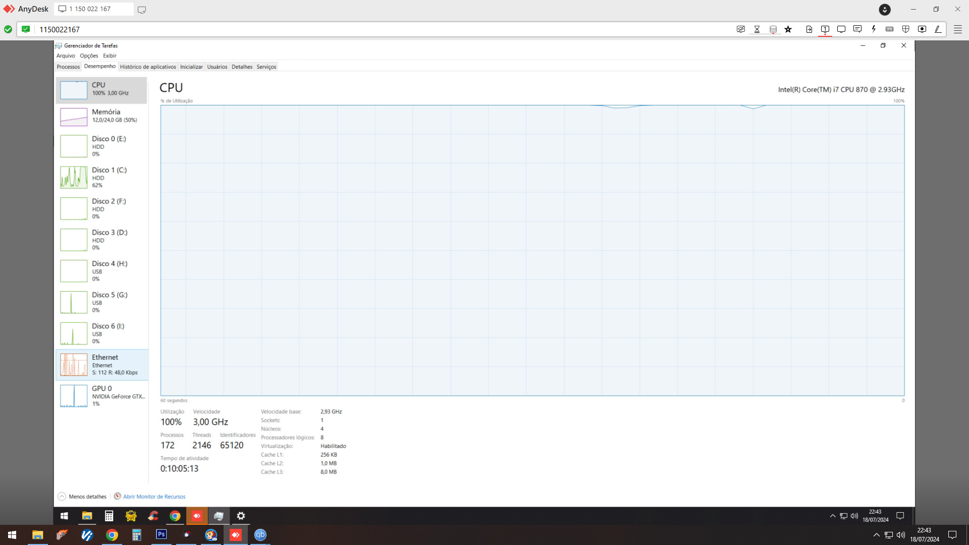

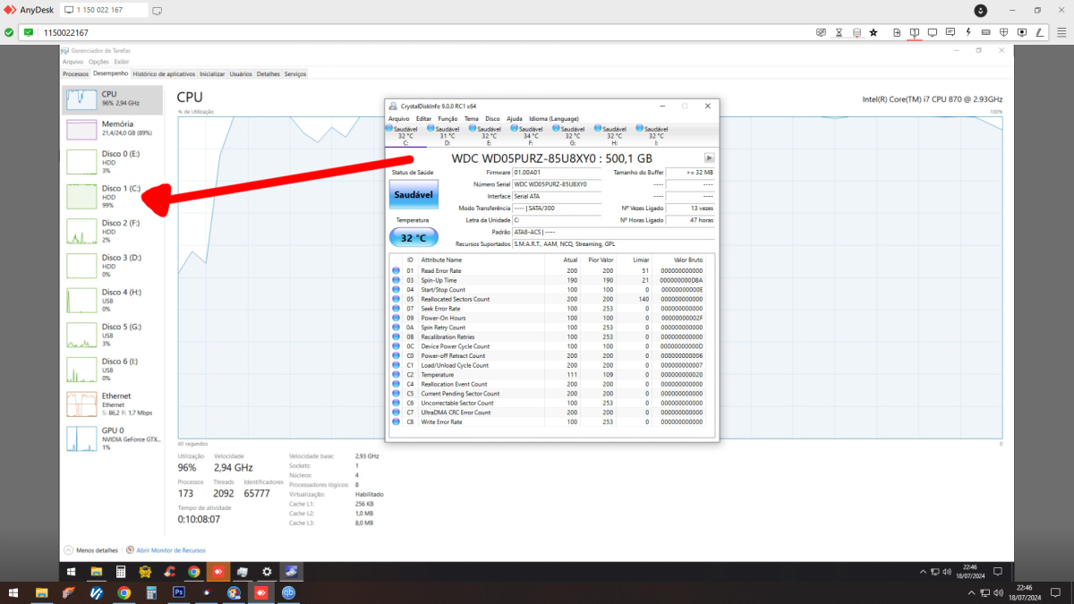

trekflix 5 Posted July 19, 2024 Author Posted July 19, 2024 I made a print now of the managed tasks. I was using a system SSD, but I thought it might have problems, I bought a new HDD, but it seems that this HDD has 100% processing. Could you tell me what I could improve on my machine so that I no longer have simultaneous transcoding problems.

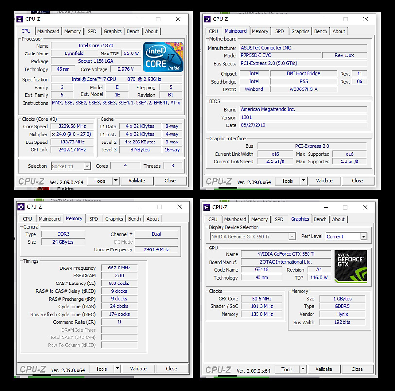

Lessaj 486 Posted July 19, 2024 Posted July 19, 2024 Wow that's a 15 year old CPU, and that 550 Ti is almost just as old. I'm not sure what version the driver is but in theory the limit should be 8 streams, though if it's an older driver it may still be limited to 4 or even less, since this is a consumer grade card. This would then force a CPU transcode, which that old CPU is really not up to the task for and would explain why it's at 100%. Using a hard drive for the OS is definitely a downgrade from an SSD. You need to look at the dashboard for the reasons transcodes are happening. Maybe you can avoid it by converting some of it, but otherwise you need at least a more recent and powerful GPU to handle more transcoding streams. 4
trekflix 5 Posted July 19, 2024 Author Posted July 19, 2024 Could anyone tell me a CPU and video card configuration that is newer than mine, but not the most expensive? They told me Intel generation 12 or newer.

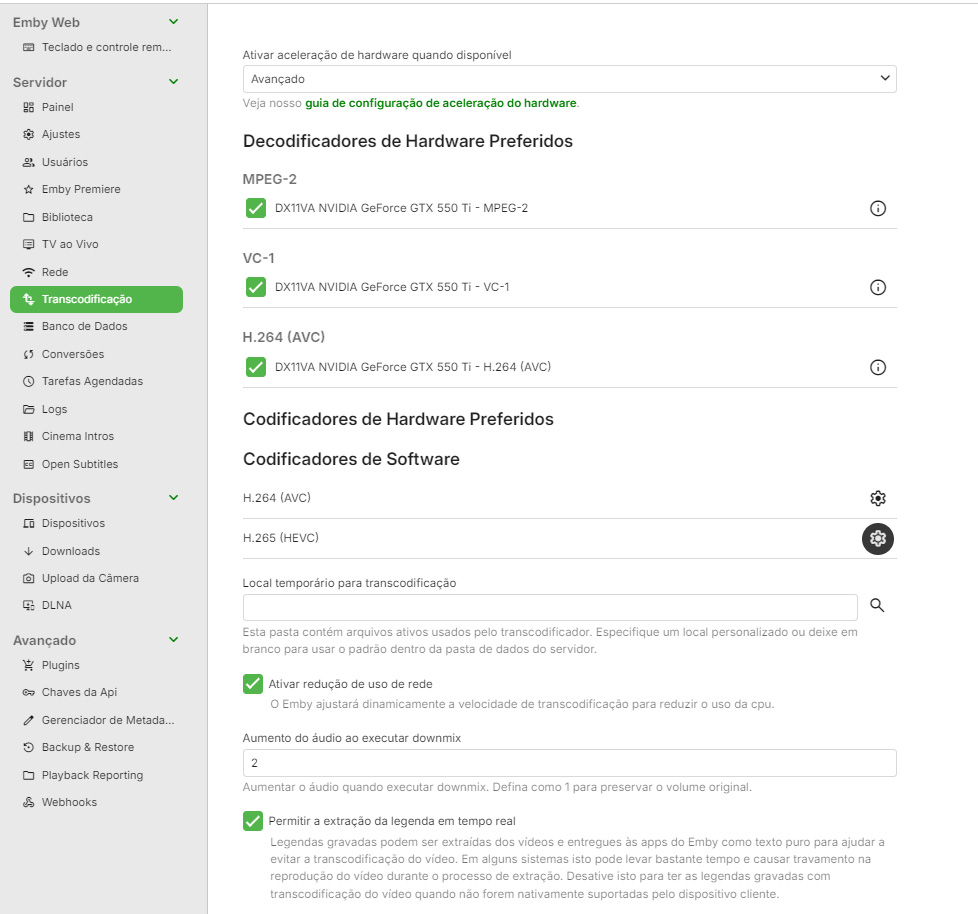

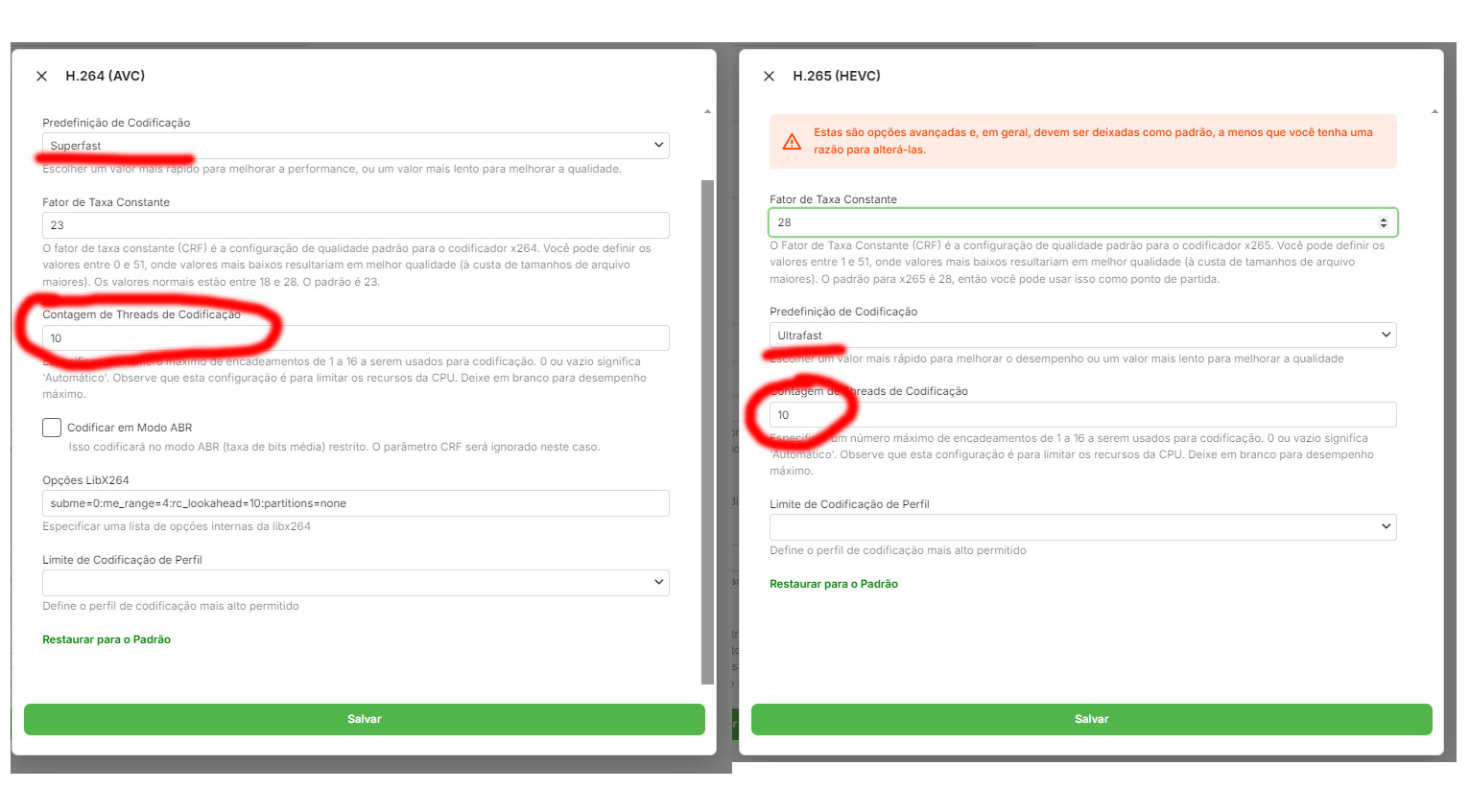

RanmaCanada 503 Posted July 26, 2024 Posted July 26, 2024 2 hours ago, trekflix said: I changed my CPU to a 12th generation i5. 32GB of memory. I'm waiting for the new GTX 1650 4GB video card to arrive. I did a general upgrade. I want to see if it improves after installing the new video card. The most difficult thing to transcode are the H265 files. I don't have 4K or Full HD videos. Thanks to everyone who gave their opinion. You do not need a video card as the 12th gen i5 will handle all your transcoding needs. The 1650 will actually be a massive bottleneck as it can not handle as many encodes as the i5 due to the memory limitiations 4GB imposes on it even with a hacked driver. Try your system as it is now and then try it with the video card, and you will see that the i5 will handle more transcodes better than the 1650 will. The i5 will only be limited by your array's bandwidth in regards to how many transodes it can do. 1 2
trekflix 5 Posted July 26, 2024 Author Posted July 26, 2024 I'm testing my new i5 12 generation motherboard. but it still used 100% memory (32gb) to transcode some H265 videos. This has been happening for about 2 months, even with the old card I had. A lot of work to transcode h265 videos for those using Chromecast, Roku, Fire Stick, something that didn't give me a headache before. I bought this new video card to see if it helps anything. Because even with the new i5, I noticed a crash in the Emby Panel where it shows the Activities that those who are watching. I can't even say if it stopped playing the films in the house of those who were watching, but it was 100% in memory and I didn't see anyone watching it. I mean, it didn't have the Activities look in 'Now Playing'. Feedback
