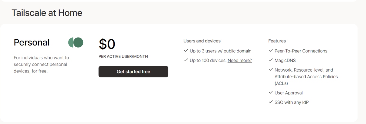

Happy2Play 9814 Posted July 21, 2024 Posted July 21, 2024 If you are now behind cgNAT then you would have to contact your ISP for public IP or uses something like tailscale or vpn to circumvent it.
Noel Grassy 42 Posted July 21, 2024 Author Posted July 21, 2024 1 hour ago, Happy2Play said: If you are now behind cgNAT then you would have to contact your ISP for public IP or uses something like tailscale or vpn to circumvent it. Tailscale looks interesting. Is it really free? Because in my experience nothing is.
Happy2Play 9814 Posted July 21, 2024 Posted July 21, 2024 2 minutes ago, Noel Grassy said: Tailscale looks interesting. Is it really free? Because in my experience nothing is. Guess it really depends on usage needs but currently yes.
