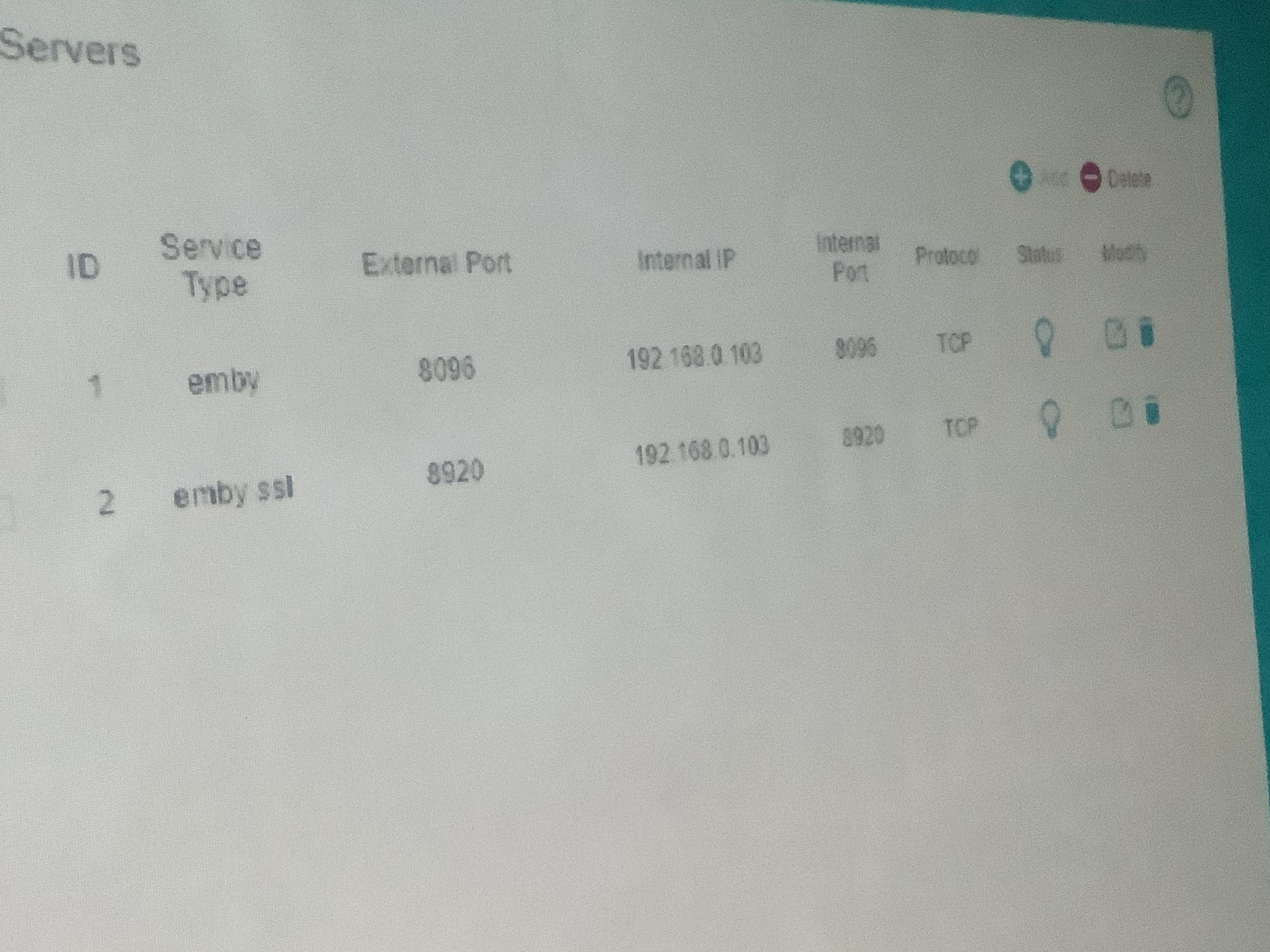

Luke 42289 Posted July 15, 2024 Posted July 15, 2024 Can you show screenshots of how you configured port forwarding in your router? Have you researched to check if your ISP might be using a CGNat?
Noel Grassy 42 Posted July 15, 2024 Author Posted July 15, 2024 16 hours ago, Luke said: Can you show screenshots of how you configured port forwarding in your router? Have you researched to check if your ISP might be using a CGNat? 1
Noel Grassy 42 Posted July 15, 2024 Author Posted July 15, 2024 16 hours ago, Luke said: Can you show screenshots of how you configured port forwarding in your router? Have you researched to check if your ISP might be using a CGNat? I ran tracert 8.8.8.8 and it didn't match any of the numbers outside of the first line so i don't think so.
justinrh 270 Posted July 15, 2024 Posted July 15, 2024 (edited) 103 is the address assigned to the server? (you probably checked that, but have to ask) Any other services on that box accessible from the outside? What are the firewall details? What is the response when you browse to http://youripordomain:8096? Edited July 15, 2024 by justinrh
rbjtech 5345 Posted July 16, 2024 Posted July 16, 2024 Forwarded Ports look reasonable. From another device on the same lan (192.168.0.x) - can you connect to http://192.168.0.103:8096 ? If yes, then your firewall on the emby server is ok. Worth checking you have entered the correct subnet mask (likely 255.255.255.0) and router gateway (192.168.0.x) on any static IP used for the emby server.
