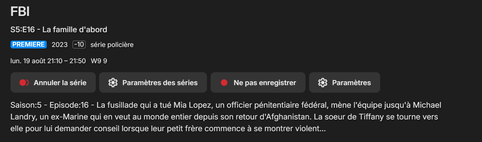

pdeliot 10 Posted August 19, 2024 Author Posted August 19, 2024 (edited) This was functional in the past... I believe it stopped working starting 4.8. Maybe a change in the way episodes were identified. In the recording planning section, the episode numbers seems properly identified. Here an example with "FBI" because HPI has no more broadcast at the moment. Edited August 19, 2024 by pdeliot
sa2000 703 Posted August 20, 2024 Posted August 20, 2024 22 hours ago, pdeliot said: Here an example with "FBI" because HPI has no more broadcast at the moment. That is good to know. For the HPI repro, i am using a cutback xmltv file with just channel C192.api.telerama.fr and one airing only - the S1E6 airing. I just change the start and endtime to do my tests. I have one DVR channel mapped to this channel I would like to establish if the issue is confined to xmltv - so with the FBI airings on channel W9, I will set that on another DVR channel mapping to the W9 channel on OTA Emby Guide lineup and see if same outcome
sa2000 703 Posted August 20, 2024 Posted August 20, 2024 1 hour ago, sa2000 said: I would like to establish if the issue is confined to xmltv - so with the FBI airings on channel W9, I will set that on another DVR channel mapping to the W9 channel on OTA Emby Guide lineup and see if same outcome @pdeliotappears to be only happening on xmltv. Just realized there is no Emby guide for France. I have tried with a UK channel for FBI Most Wanted airing and the episode that I put in the library does not show in the schedule or Live TV Series screen for FBI Most Wanted. I will refer the diagnostics I captured on my xmltv test to the development team 1

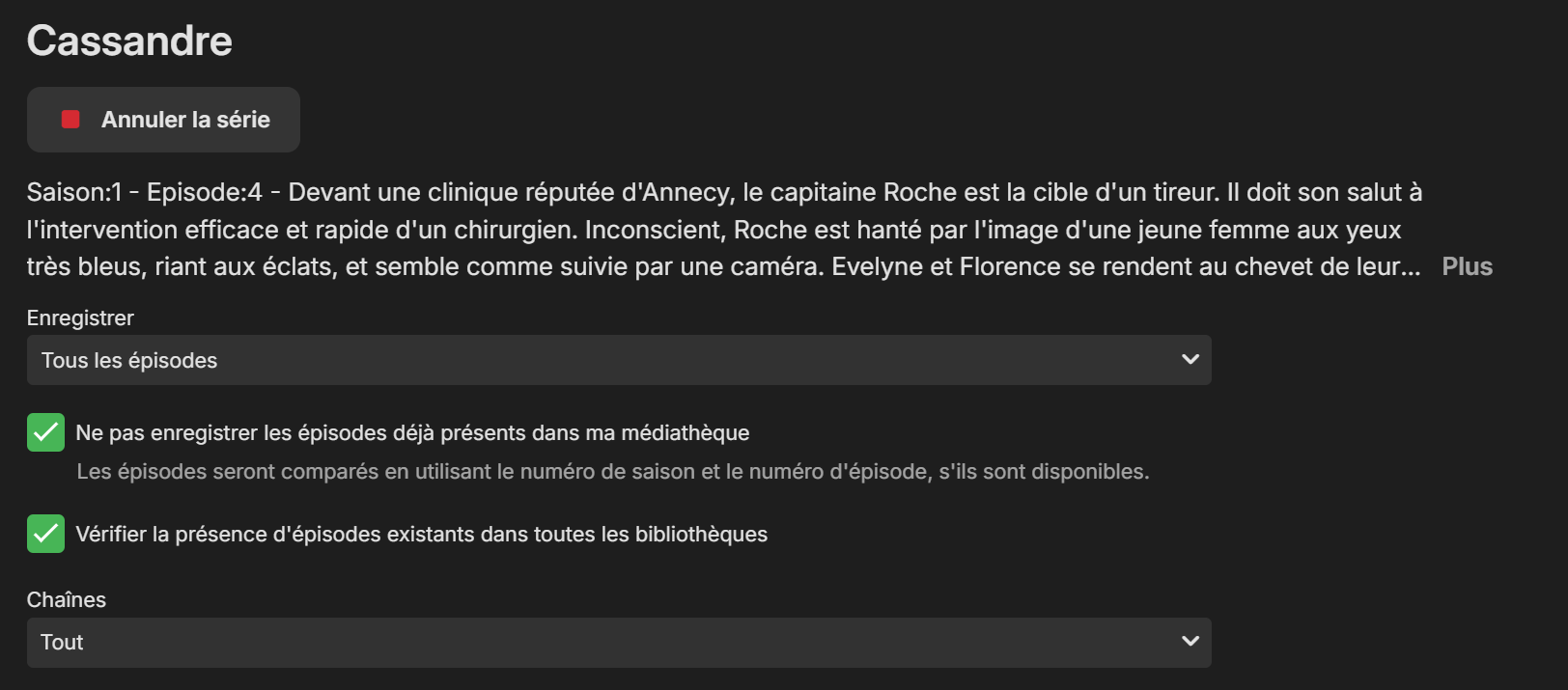

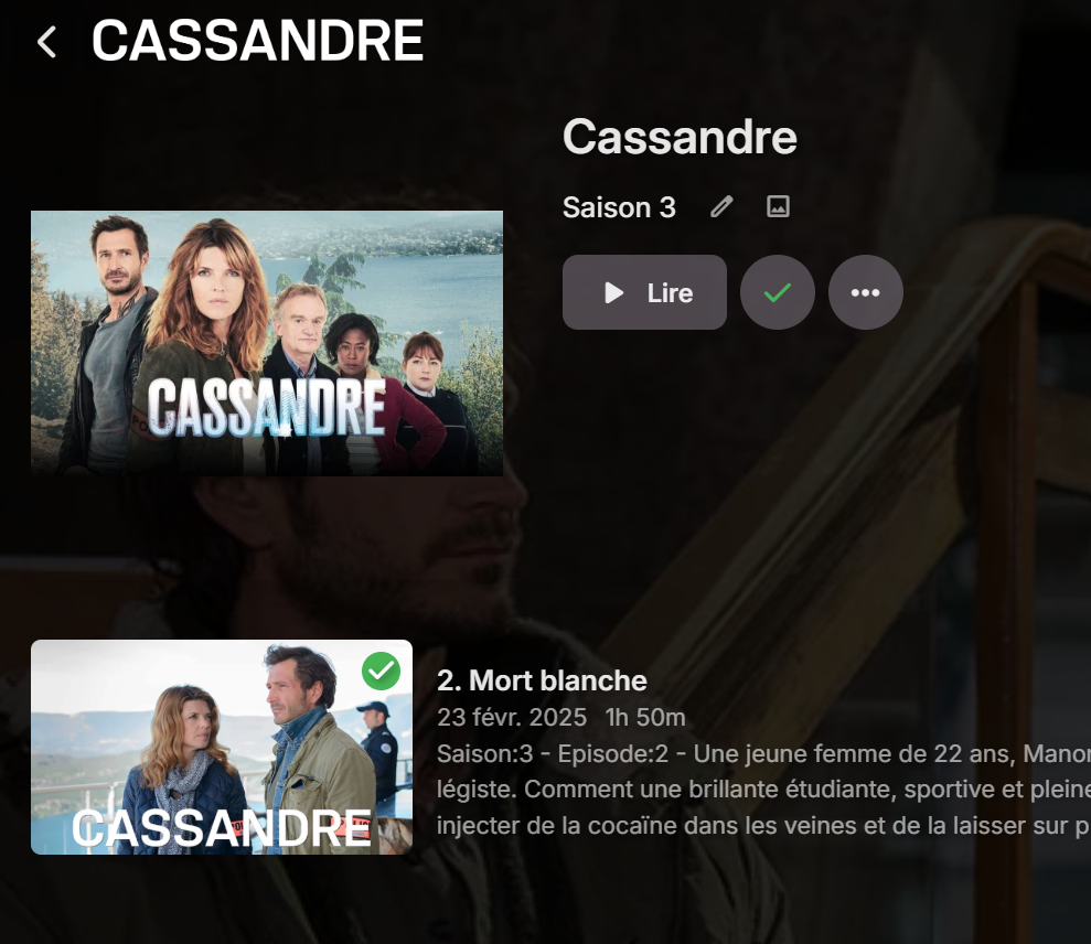

pdeliot 10 Posted February 23, 2025 Author Posted February 23, 2025 (edited) Hi, I've installed the beta and the result give me a mixed felling. It seems working for some series, but not for others. For example, a series called CASSANDRE... still recorded old episodes existing in the library. Same name, same external ids.. Once recoder, Emby was able to find properly the "watched" status. For example, after recodring, in "Recordings" library: We can seed the just recorded episode marked as read.. and it is true, see from the over library were it exists. You will find an XMLTV containing next planned broadcast for CASSANDRE. Anothert exemple: "Meurtres en eaux troubles" If I can provide more details to help solving this behavior, feel free to ask... telerama (3).zip Edited February 23, 2025 by pdeliot
Luke 42288 Posted February 23, 2025 Posted February 23, 2025 HI, do you have two of the same series in the library?
pdeliot 10 Posted February 24, 2025 Author Posted February 24, 2025 Hi Luke, Not sure to understand your question, but series exists in Both "Recording" and another library. And they are configured to avoid recording if existing in all libraries. Duplicate recording are (or may) not exists in "Recordings"
