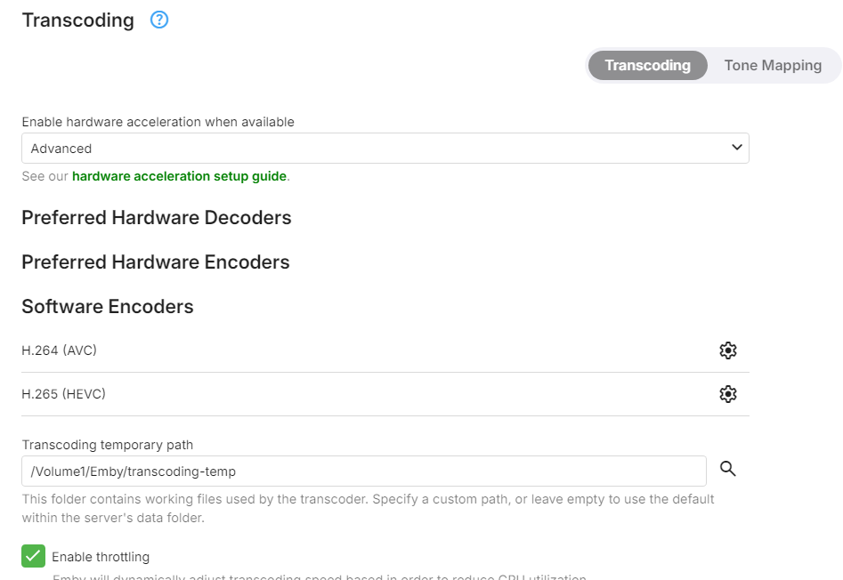

hackthis02 130 Posted July 11, 2024 Posted July 11, 2024 I can't find any information on this. After upgrading my F2-221 from TOS 4.x to 5.1 I've lost all hardware transcode options. Can anyone point me in the right direction? embyserver.txt hardware_detection-63856252102.txt

hackthis02 130 Posted July 18, 2024 Author Posted July 18, 2024 (edited) Yes, it said 5.1.x was the highest current version. I've gone ahead and downgraded back to 4.x while I do more research. I was able to get hardware transcoding working before I reverted back. But anytime it need OpenCL it would failback to software. Edited July 18, 2024 by hackthis02

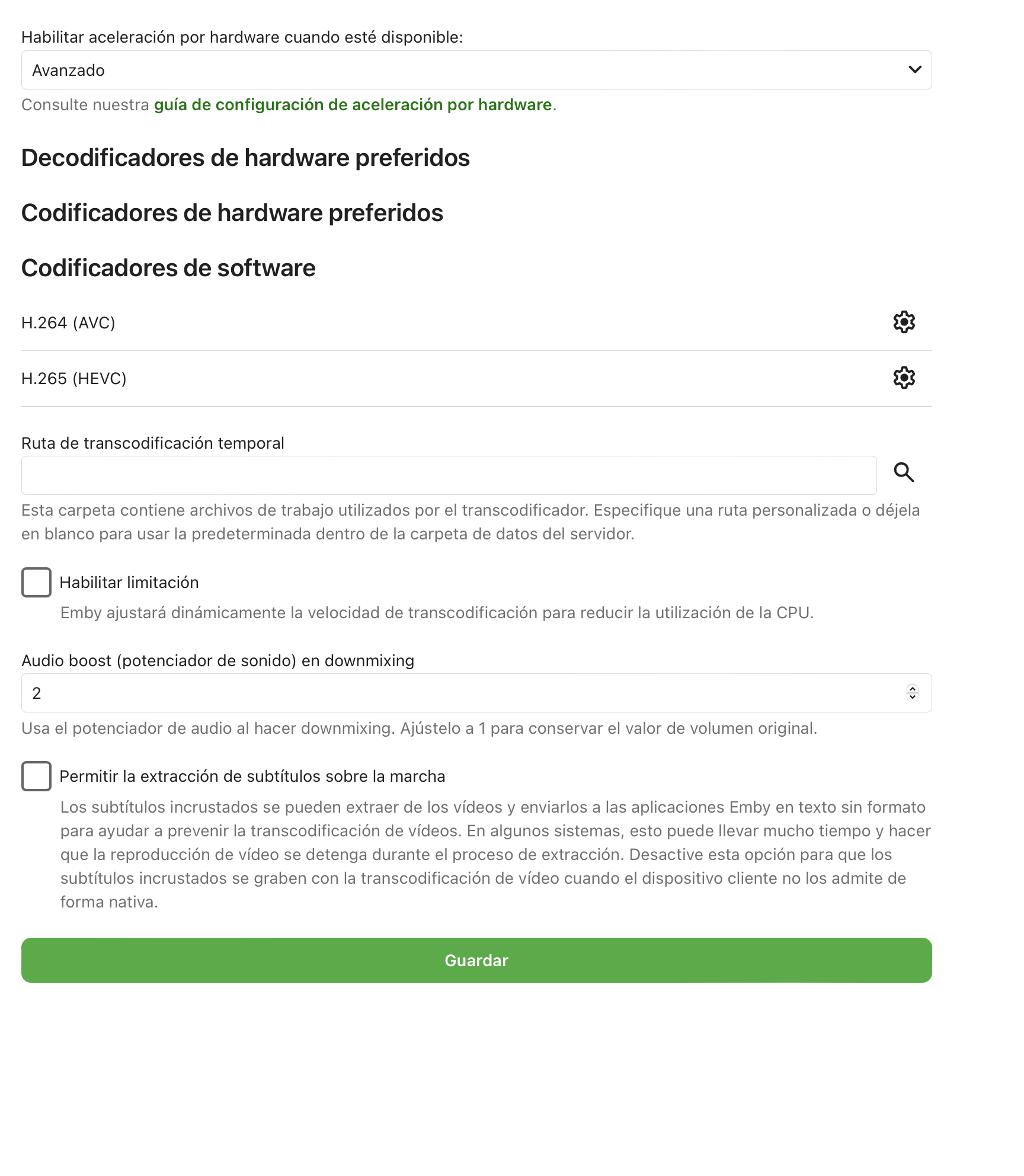

ManelN7 0 Posted September 7, 2024 Posted September 7, 2024 Any solution for this? I'm still using TOS 5.1.67 and emby server 4.8.8.0 and the problem persists.

ManelN7 0 Posted September 22, 2024 Posted September 22, 2024 The beta 4.9 not work. Terramaster F5.221 TOS 5.1.67
richt 95 Posted September 24, 2024 Posted September 24, 2024 No problems with hardware encoding on an F4-423 running TOS 5.1.131. Haven't upgraded to 5.1.67 as it didn't address any issues I'm having. One thing comes to mind and that is to make sure the account that runs emby has access to /dev/dri/renderD128. Maybe that was something that changed with the OS update. In my case I made sure that the emby user account is a member of the video group.
hackthis02 130 Posted September 24, 2024 Author Posted September 24, 2024 The issue I had was I factory reset it a few time with with 5.1.x and there would be cycles where /dev/dri/* just wouldn't be in the file system. The time it was, Emby could see the card for transcoding but anything that required OpenCL would fail back to software.
richt 95 Posted September 24, 2024 Posted September 24, 2024 2 minutes ago, hackthis02 said: cycles where /dev/dri/*just wouldn't be in the file system Wow... 2 minutes ago, hackthis02 said: anything that required OpenCL would fail back to software Not doing anything with OpenCL so I can't provide any insight.
hackthis02 130 Posted September 24, 2024 Author Posted September 24, 2024 1 minute ago, richt said: Not doing anything with OpenCL so I can't provide any insight. OpenCL is used for tone mapping HDR content to SDR.
