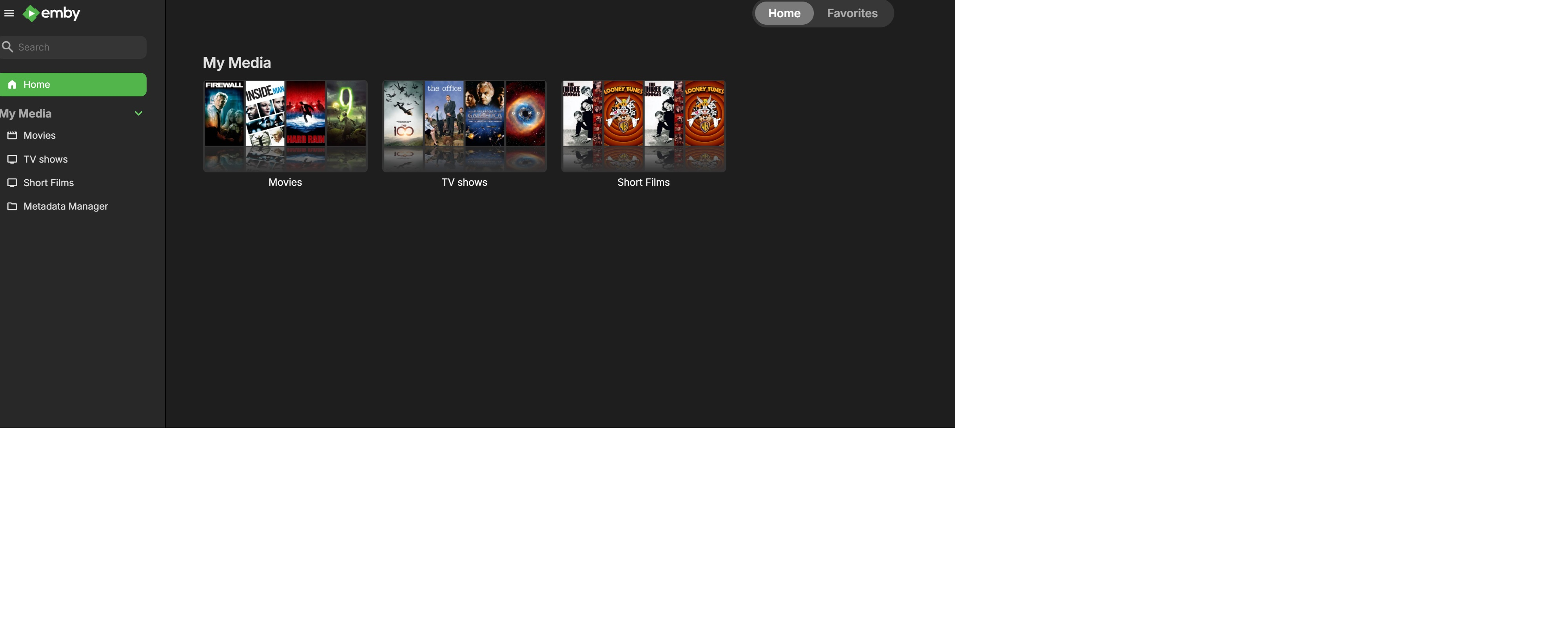

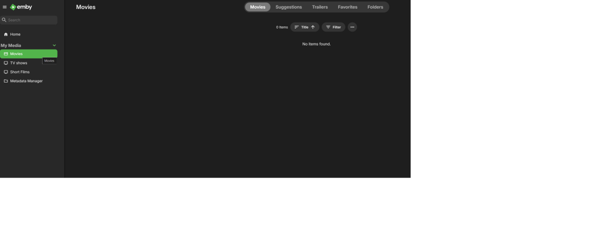

audiom3 12 Posted July 9, 2024 Posted July 9, 2024 I installed emby on my TrueNAS Core sometime around mid-day Sunday. Install went incredibly smooth and I was scanning libraries (movies, tv shows and short films) in literally a few minutes. It took a while to finish, then I began fixing incorrect matches and artwork. All in, about 14 hours of work. Somehow last night, emby lost my library of 1570 movies and over 100 tv shows. I have searched and searched for answers but to no avail. I am sure it must be a directory issue but how and why did this change overnight when I wasn't even using emby? Also, how do I get my media back? My homepage shows the icons but when I click either one, they are empty...or emby points me to empty folders. Here are a few screen shots as well as my server logs. Thank you for any help. embyserver.txt
Happy2Play 9811 Posted July 9, 2024 Posted July 9, 2024 Probably need to see a log before this one as this 30 minute log doesn't show anything. Are your media drives accessible? But a guess is drives go offline and Emby does schedule task scans and sees the media missing and removes.

Solution Happy2Play 9811 Posted July 9, 2024 Solution Posted July 9, 2024 The log 63856095029 is filled with MediaBrowser.Common.Extensions.DirectoryUnavailableException: Path Not Found errors for your smb paths. Probably need to go over how you setup your library folders also as this suggest a way that can not be done. Line 24943: 2024-07-08 18:23:12.145 Info App: Creating folder in database 192.168.50.20 - smb://192.168.50.20 Line 24944: 2024-07-08 18:23:12.148 Info App: Created folder in database 192.168.50.20 62686 - smb://192.168.50.20 Line 24945: 2024-07-08 18:23:12.150 Info App: Rebasing 4 smb://192.168.50.20/Media/Movies to be underneath 62686 smb://192.168.50.20 Line 24946: 2024-07-08 18:23:12.150 Info App: Rebasing 8 smb://192.168.50.20/Media/Short Films to be underneath 62686 smb://192.168.50.20 Line 24947: 2024-07-08 18:23:12.151 Info App: Rebasing 6 smb://192.168.50.20/Media/TV Shows to be underneath 62686 smb://192.168.50.20 Line 24951: 2024-07-08 18:23:12.327 Info App: Removing item from database, Type: Folder, Name: Movies, Path: smb://192.168.50.20/Media/Movies, Id: 4 Line 28119: 2024-07-08 18:23:12.986 Info App: Removing item from database, Type: Folder, Name: TV Shows, Path: smb://192.168.50.20/Media/TV Shows, Id: 6 Line 33816: 2024-07-08 18:23:13.562 Info App: Removing item from database, Type: Folder, Name: Short Films, Path: smb://192.168.50.20/Media/Short Films, Id: 8 Line 34484: 2024-07-08 18:26:00.931 Info App: Skipping creating folder smb://192.168.50.20 because it already exists 62686 smb://192.168.50.20 1

Happy2Play 9811 Posted July 9, 2024 Posted July 9, 2024 4 minutes ago, audiom3 said: But supposedly emby doesn't have smb support yet? Is that true? It does but the devs will have to explain the technical side but devs recommend mounting the libraries instead. But per the log it would suggest library path conflict with one library with a path that is covered in another library. Creating folder in database 192.168.50.20 - smb://192.168.50.20 2024-07-08 18:23:12.150 Info App: Rebasing 4 smb://192.168.50.20/Media/Movies to be underneath 62686 smb://192.168.50.20 2024-07-08 18:23:12.150 Info App: Rebasing 8 smb://192.168.50.20/Media/Short Films to be underneath 62686 smb://192.168.50.20 2024-07-08 18:23:12.151 Info App: Rebasing 6 smb://192.168.50.20/Media/TV Shows to be underneath 62686 smb://192.168.50.20 So the database kill all child libraries. 5 minutes ago, audiom3 said: Will media info/posters/art be saved within the server if I can get them all to reappear via a direct path to my array? If not saved with media no as it is linked to db items if not and the db has been purged.
