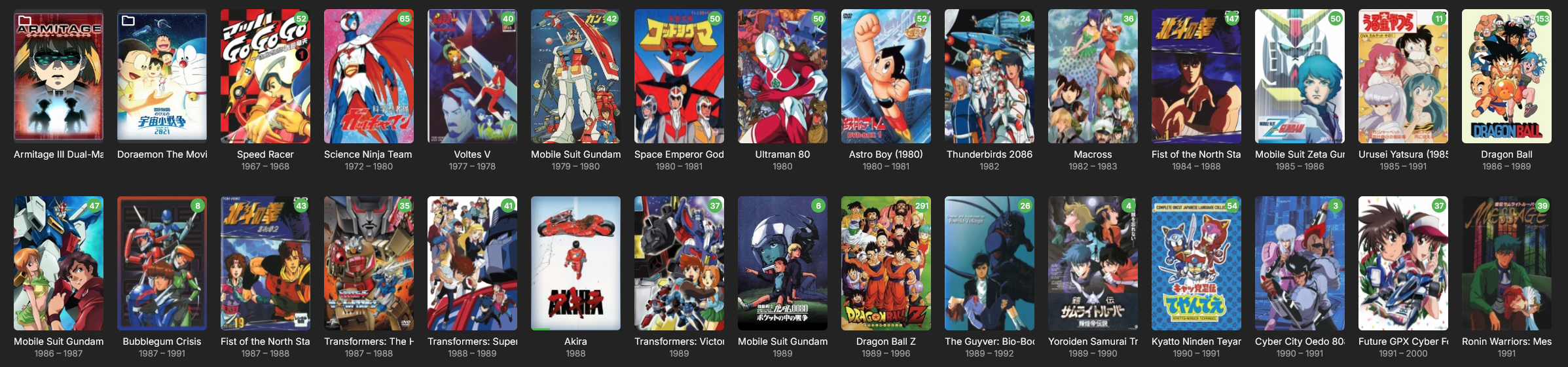

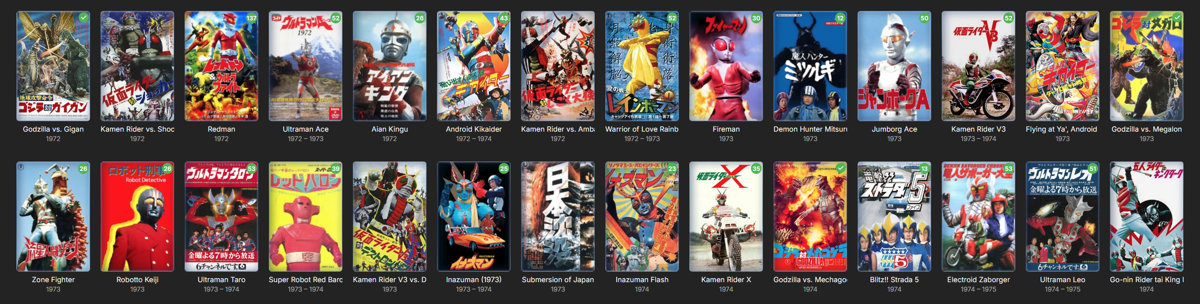

Iwamoto 0 Posted July 8, 2024 Posted July 8, 2024 Hey there Embists, So i noticed a weird difference that i'm trying to root out. I have 2 libraries that are mixed, with a Series and Movies folder. in both of the Movies folders, i have a mix of "loose files" and folders: When i look at the one (Tokusatsu) in Folder overview i get what i'd expect, a nice mix of movies and series (in this case date sorted) just living in harmony But with the other one (Anime) there is no mix, the movies in folders get displayed in folders separately from the rest. And i can't really find out why, there's no good indicator of what's different. (you can see 2 folders top left, but then the loose akira goes in nicely) Is there maybe a library setting i've overlooked? Thanks for reading, Cheers!
Luke 42184 Posted July 8, 2024 Posted July 8, 2024 Hi, the second screenshot is a more accurate representation of your folders, no?
Iwamoto 0 Posted July 8, 2024 Author Posted July 8, 2024 23 minutes ago, Luke said: Hi, the second screenshot is a more accurate representation of your folders, no? Possibly, but then i wonder why the 1st screenshot is able to do it like that (e.g. not show the folders, only show the contents), it's almost like it flattens the folders or something. To be clear, i'd like the end result to be able to have an overview of all movies and series mixed together (since it's a mixed media library for a reason)

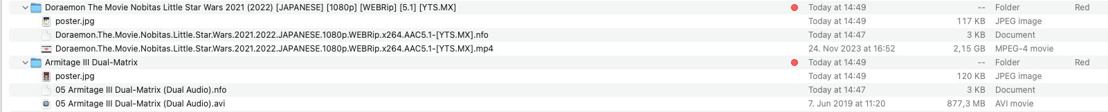

Happy2Play 9798 Posted July 8, 2024 Posted July 8, 2024 1 hour ago, Iwamoto said: Interestingly in the system.xlm, that collapse flag is set to true, But in a quick test with system.xml set to true the library options were ignored. I can only guess the folders that show the folder image are actually nested folder structure. example So we may need to see the content of the first two folder shown in your image. As it could be doing what it is supposed to.
Iwamoto 0 Posted July 8, 2024 Author Posted July 8, 2024 As you can see, there's nothing really going on in those two, just a single video, i had already been checking this, since my assumption was also "ah, maybe it can't flatten"
