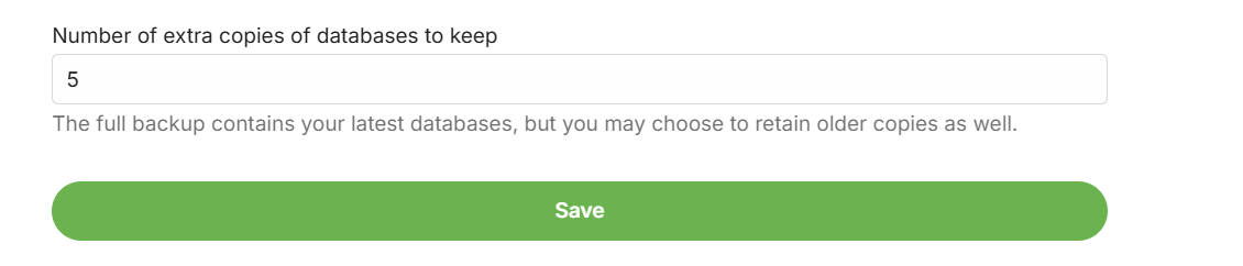

sa2000 695 Posted January 20 Posted January 20 7 minutes ago, Ford Fairlane said: and i cant stop this from happening which seems to be overwriting my backup that was created with the folder fully populated. There is an option of the backups configuration to keep more than one copy of the database files

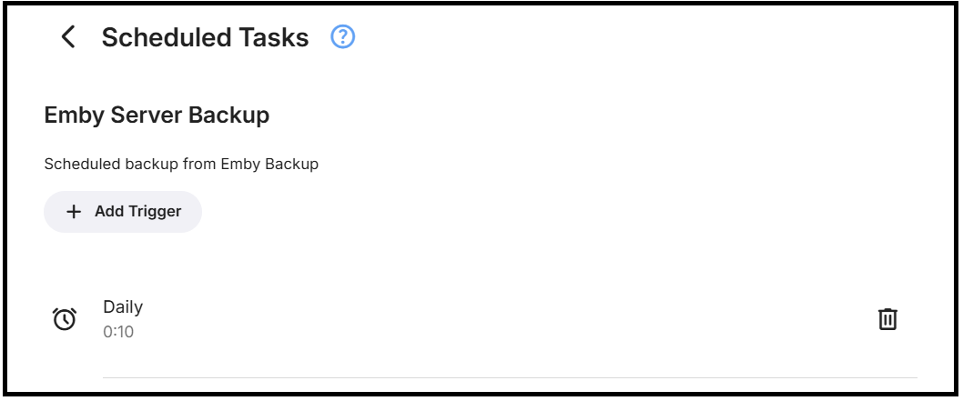

Ford Fairlane 17 Posted January 20 Author Posted January 20 5 minutes ago, sa2000 said: There is an option of the backups configuration to keep more than one copy of the database files yeah ive done that and dragged a copy to a separate folder to be double sure that it wont get over written. is there a way to stop the automatic backup?
sa2000 695 Posted January 20 Posted January 20 2 minutes ago, Ford Fairlane said: is there a way to stop the automatic backup? So long as you have a good backup to go back to, you can delete the scheduled task trigger
