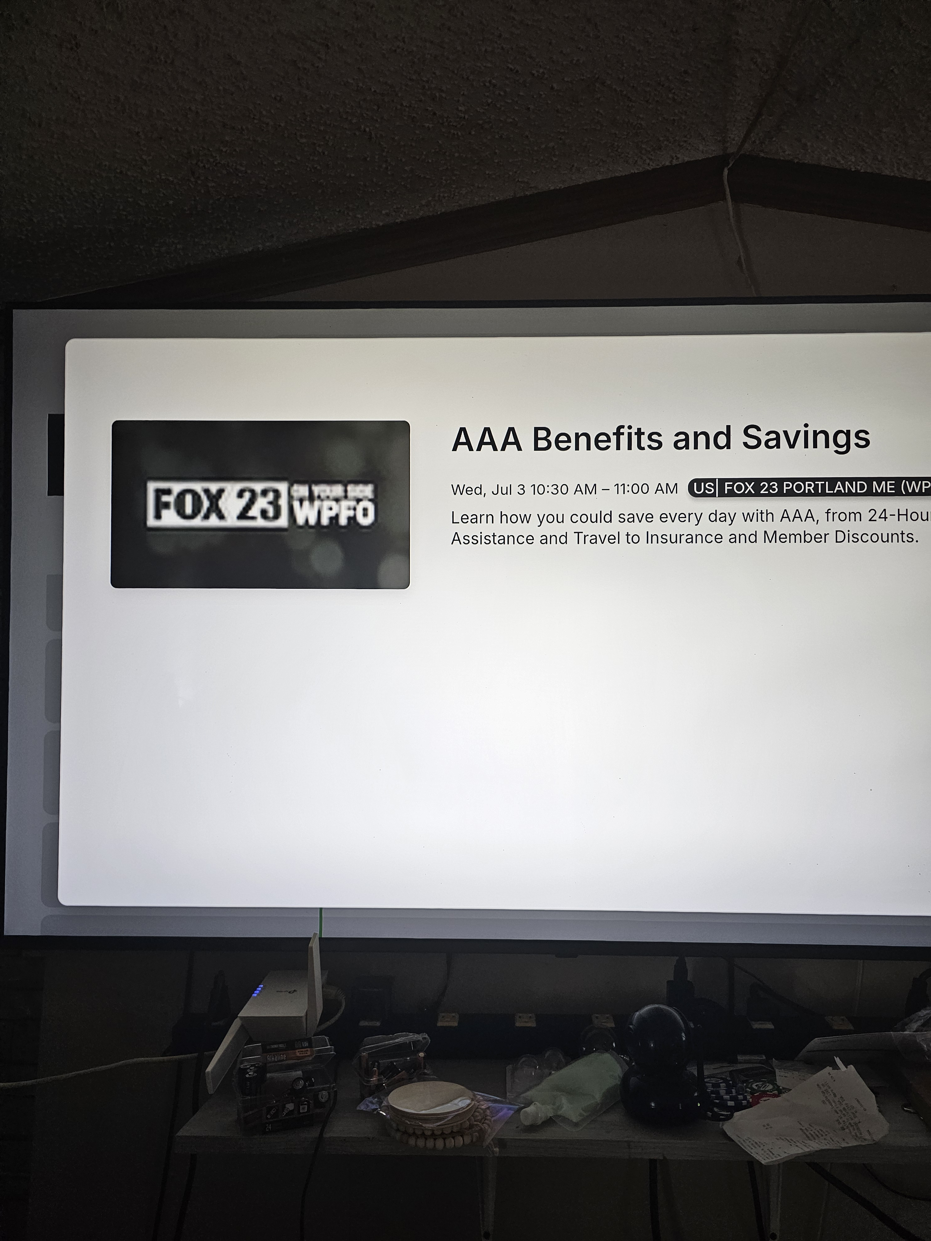

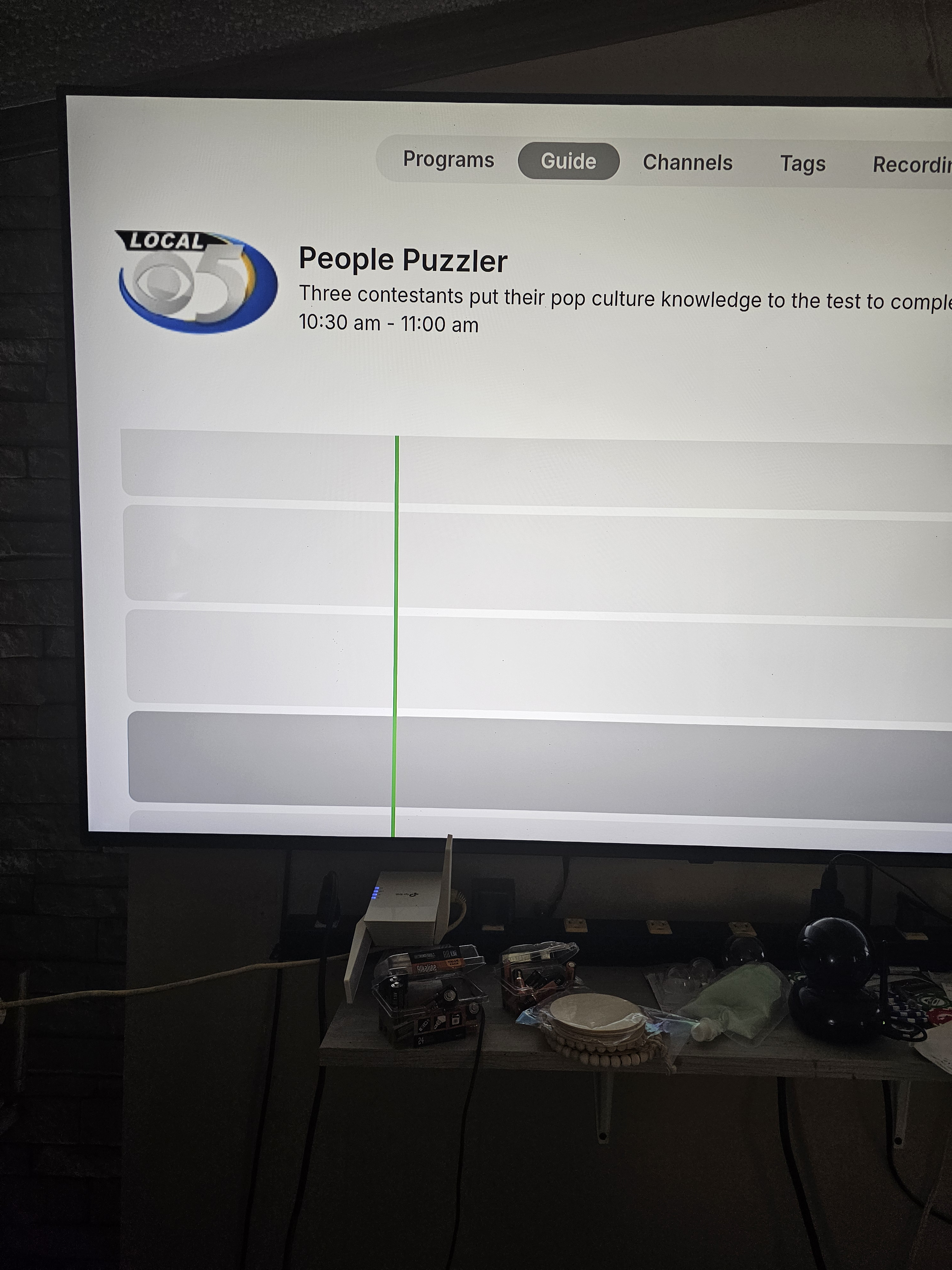

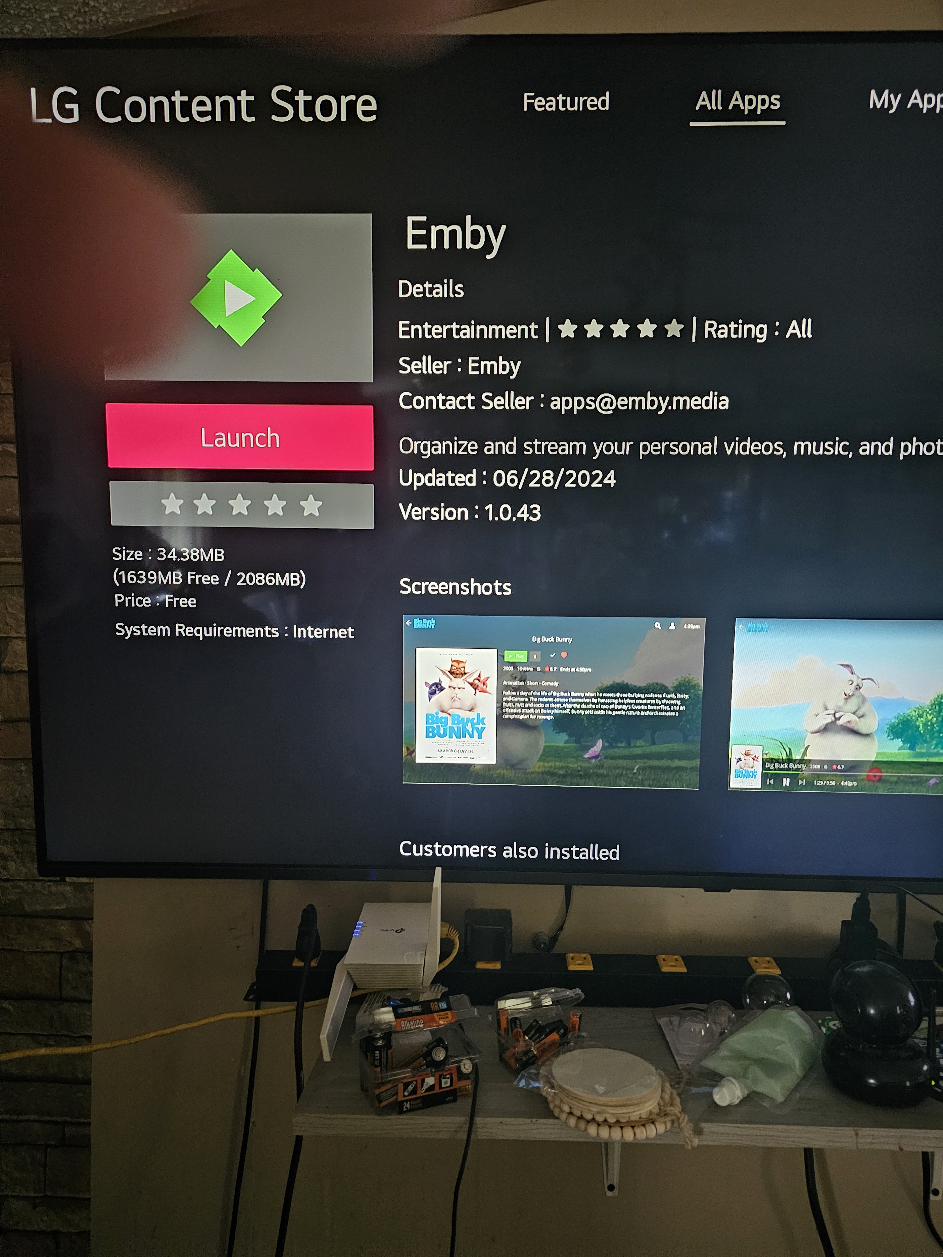

Since the update to verson 1.043 the live tv guide is not showing, is there something i need to do?

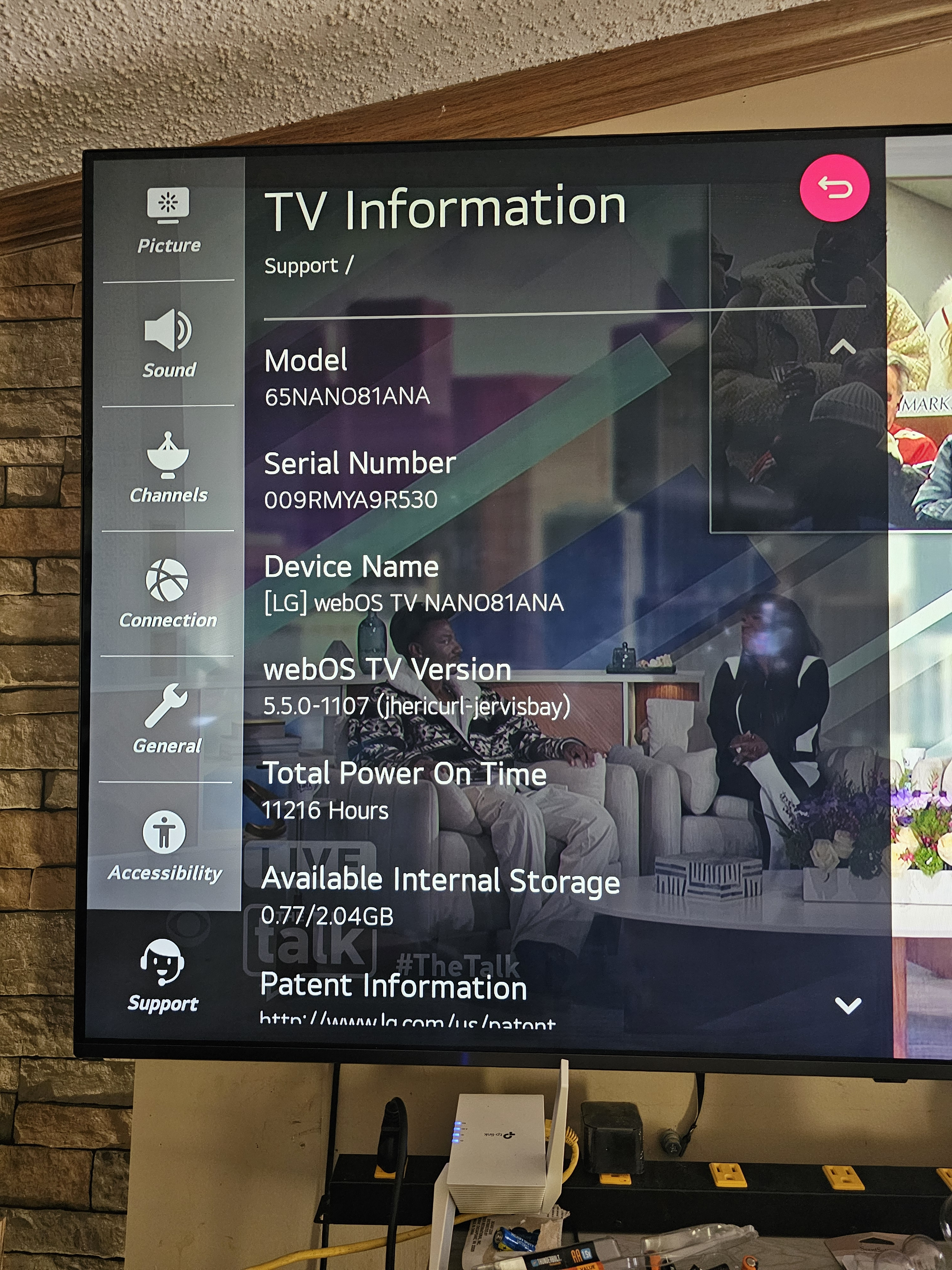

HI, that's strange. What model number do you have? What is the WebOS version?
ripper1967
ripper1967
18 minutes ago, ripper1967 said:
software version 4.5.56

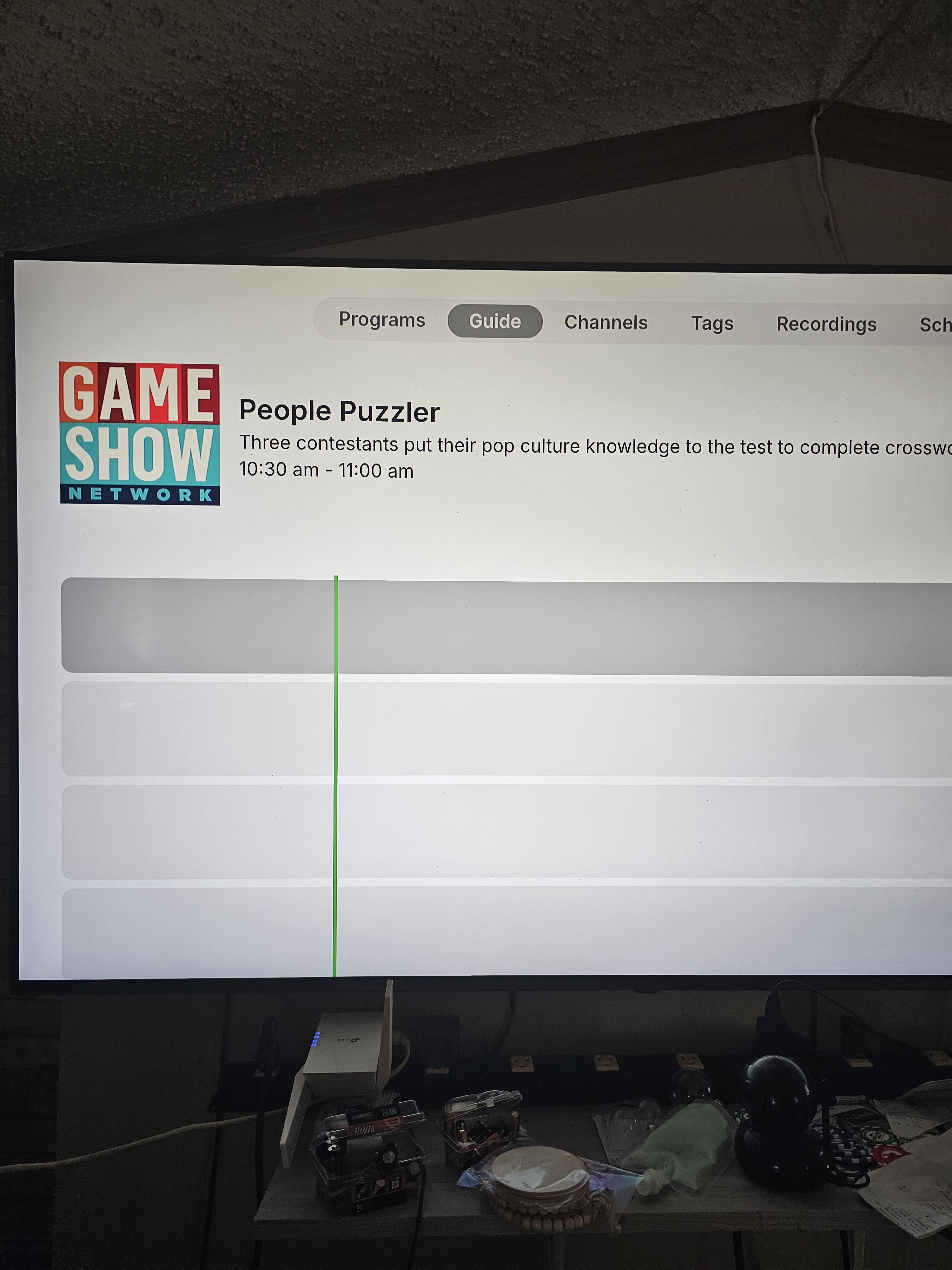

Hiya,
I have the same issue as the OP, the guide grid isn't displaying, but the channel display programs are there - all the guide data shows up, just not in the guide grid.

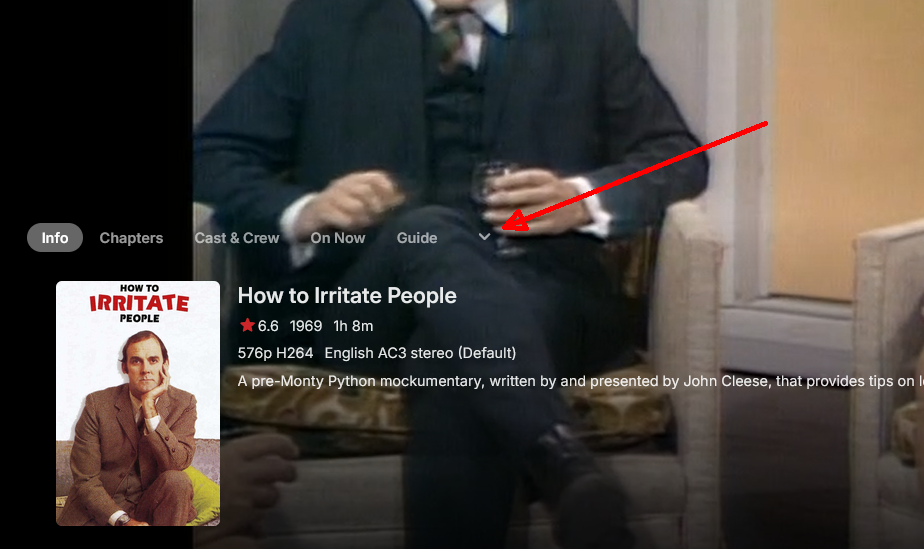

One other minor issue, is the down chevron is no longer there, so cant dismiss the program "info". Have to exit out of the currently viewed program, and then re-launch.
Ok for PC-hosted, as just using the mouse will dismiss, but not on the LG. Screen cap below from PC, arrow showing missing chevron. Kinda irritating .. 🙂

ripper1967

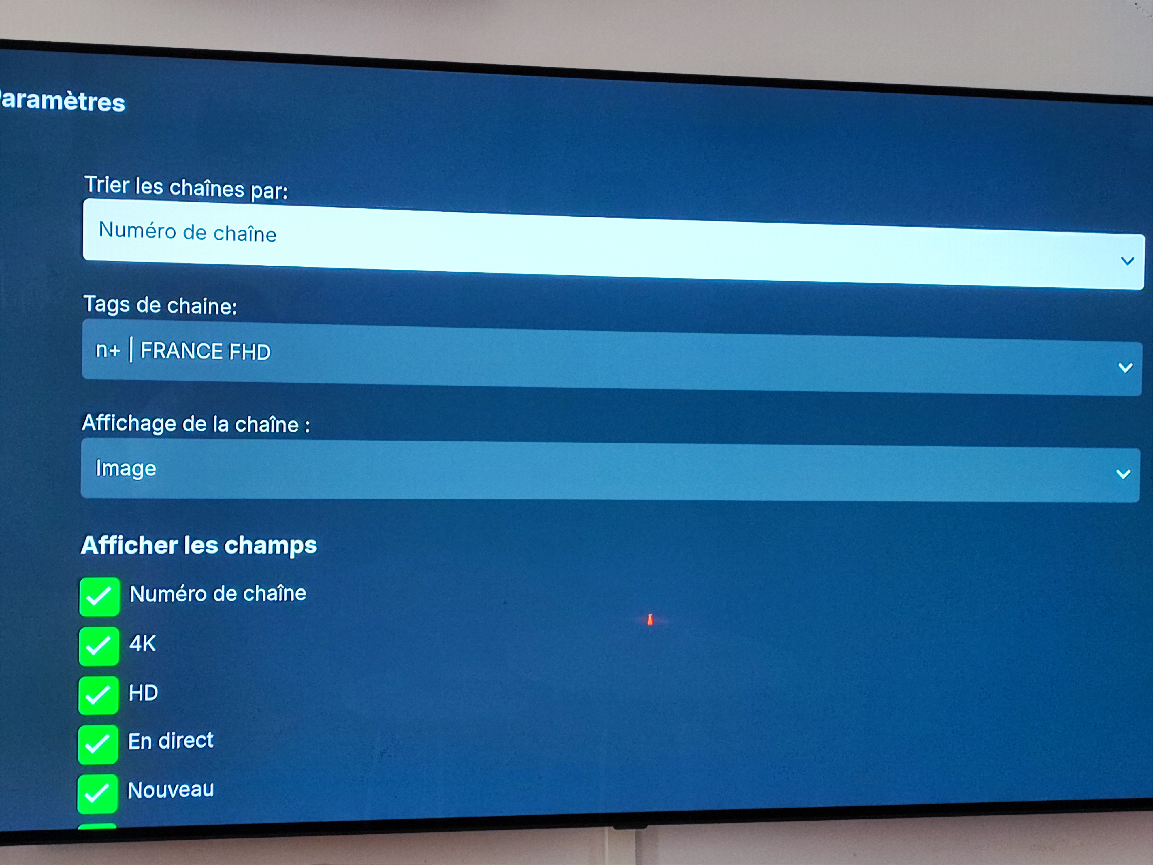

I figured it out as to why the display went that way, I had gone into live tv and switched the channel display in guide to both, it caused the initial screen not to show on lg tv, switched it back to Image  and it displays correctly.

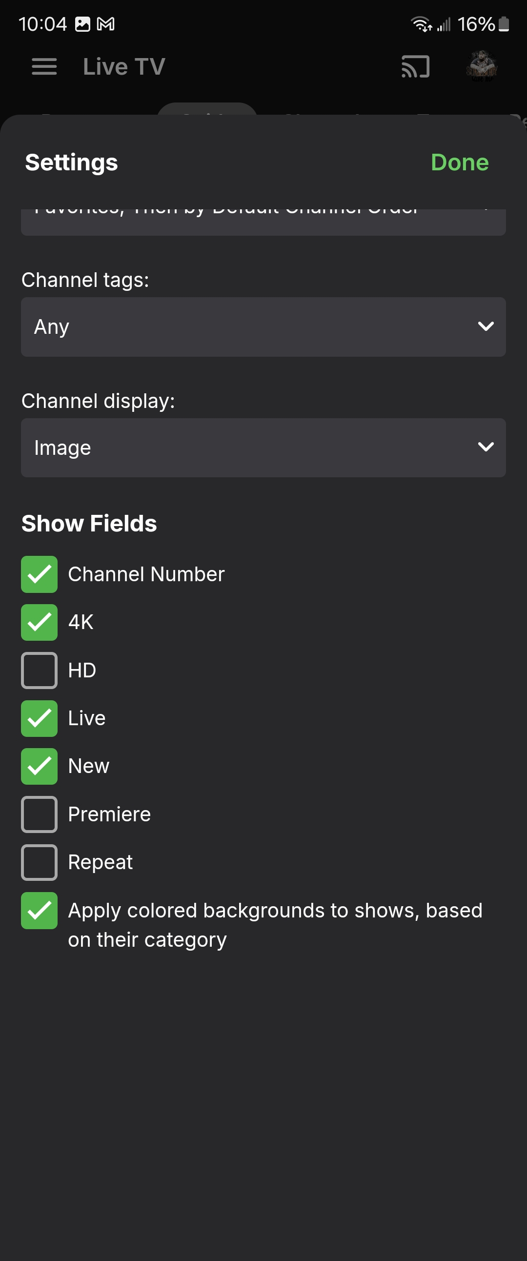

ripper1967
21 minutes ago, pdclark said:
same, no livetv schedule on LG TV
Did you try to go into guide and set the display toScreenshot_20240723_100428_Emby.thumb.jpg.833e5064de633706a7cb2a4dee6758e2.jpg image not both?
That worked, thanks Ripper

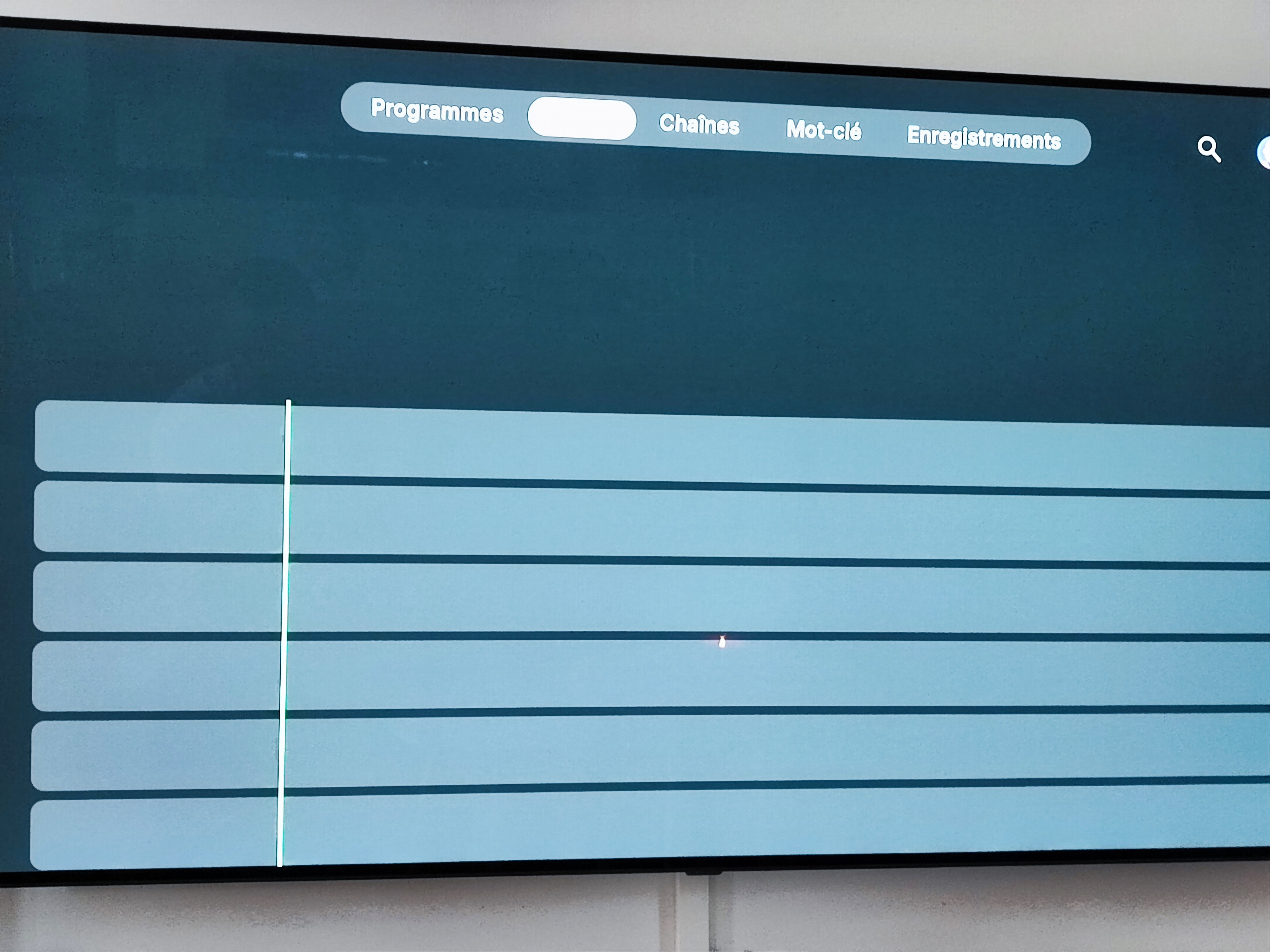

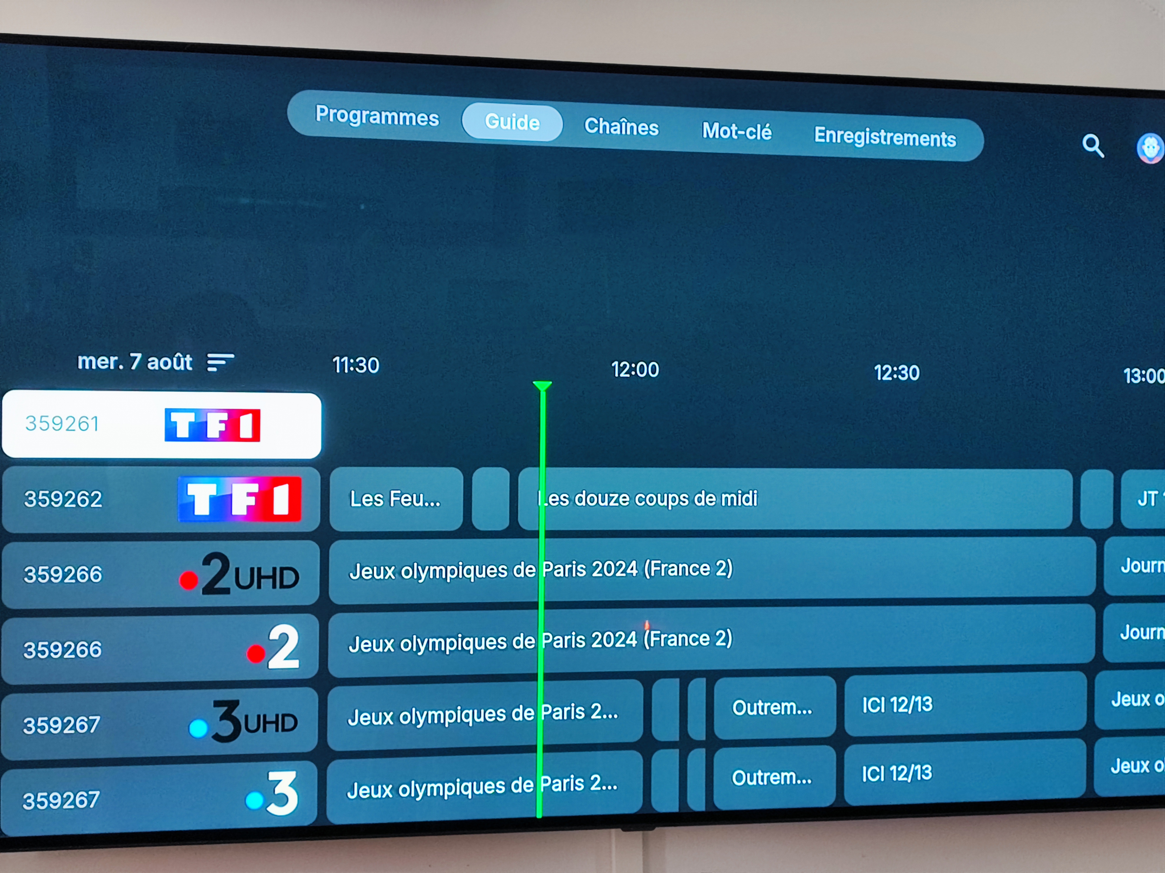

nitrup93

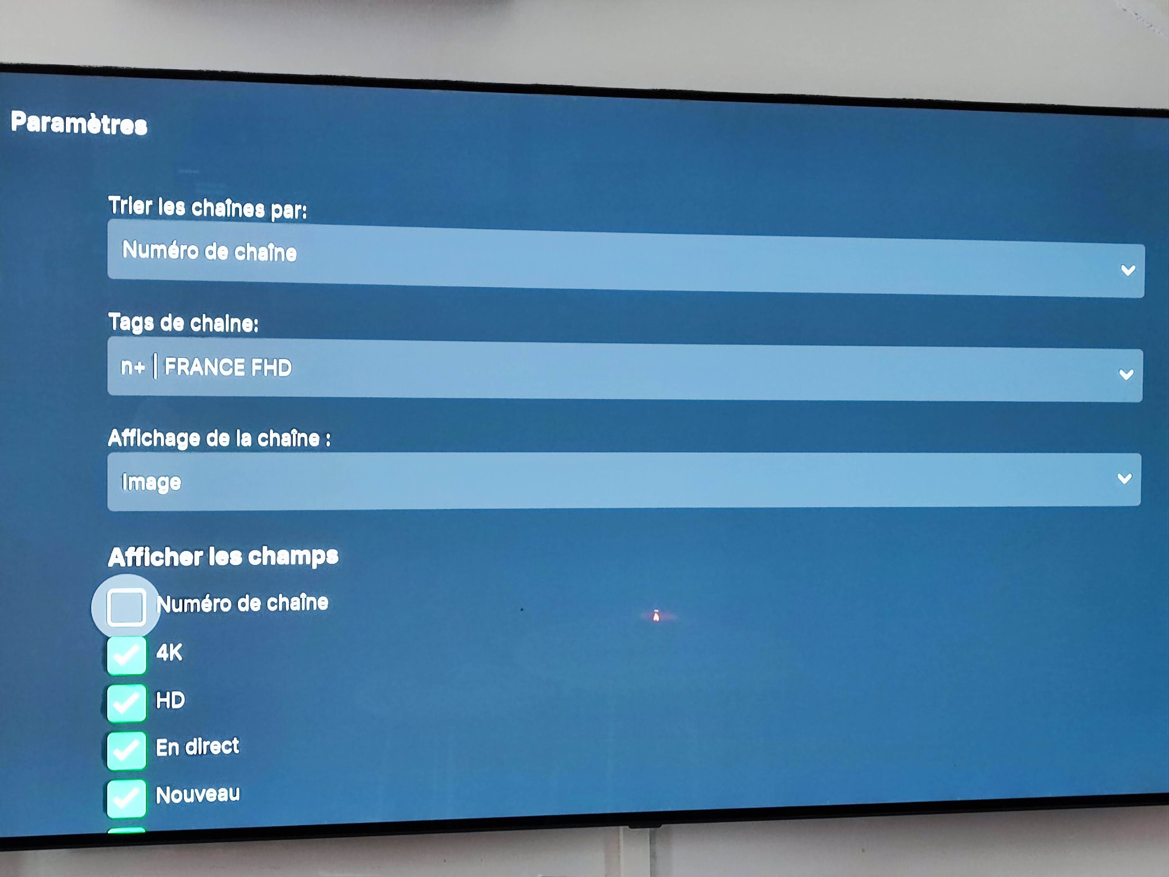

It work on my LG TV too but why thé Channel number IS mandatory now ?
Edited by nitrup93
Hi, what makes you think channel number is mandatory?
nitrup93
If I uncheck the Channel number the TV guide doesn't work like ripper.
But I dont need this because I display the TV logo Channel
Can you please show a screenshot example? Thanks.
nitrup93
  • On my Android Emby app, no problem, I can uncheck the Channel number on the tv guide Work fine
  • On my Emby Theater on my WIndows, no problem, I can uncheck the Channel number on the tv guide Work fine
  • But on my Emby LG app, If I uncheck the Channel number (because I don"t need this) the TV guide doesn't work

Hi, yes this is resolved for the next update to the Emby LG app. Thanks.
